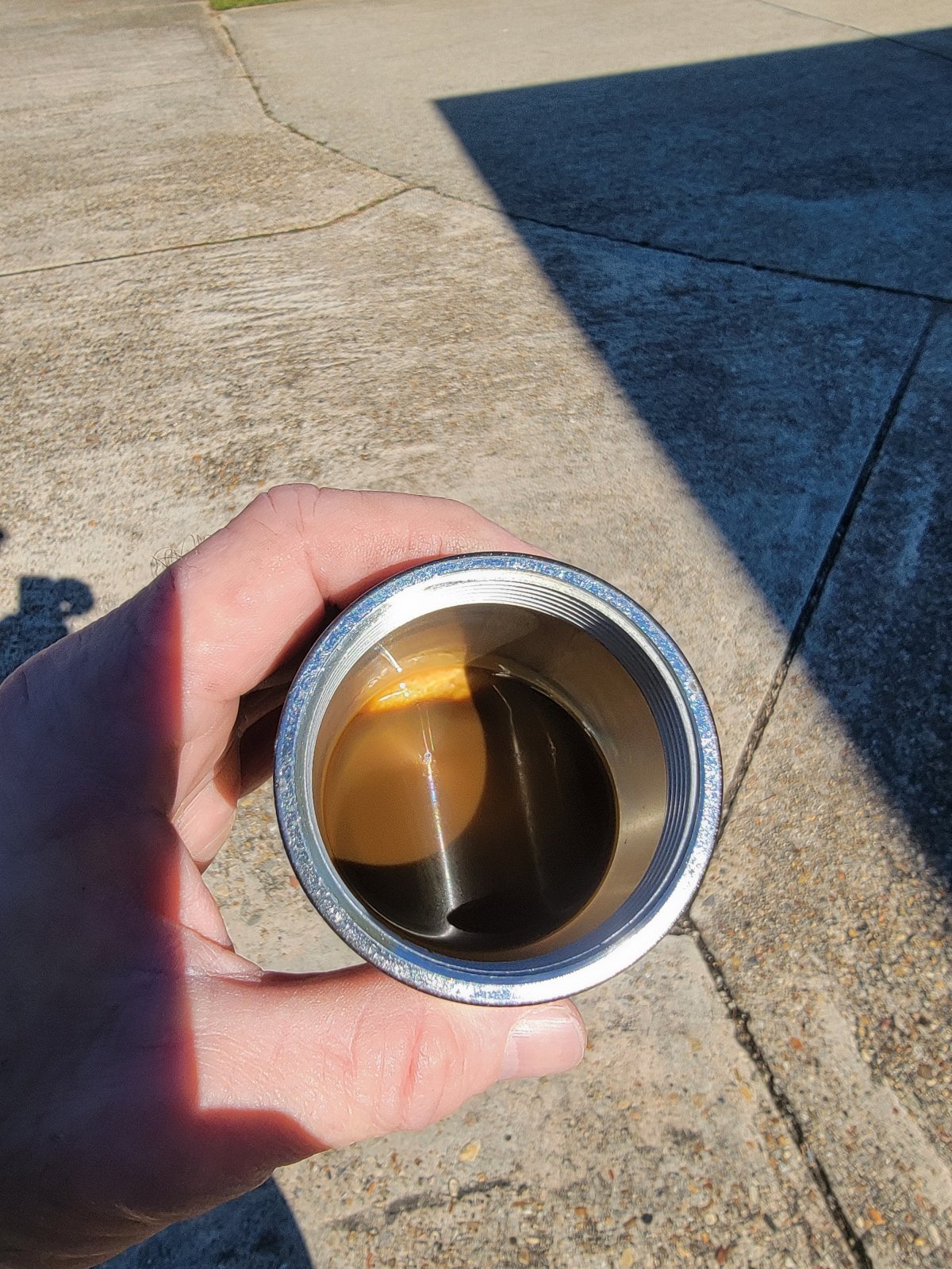

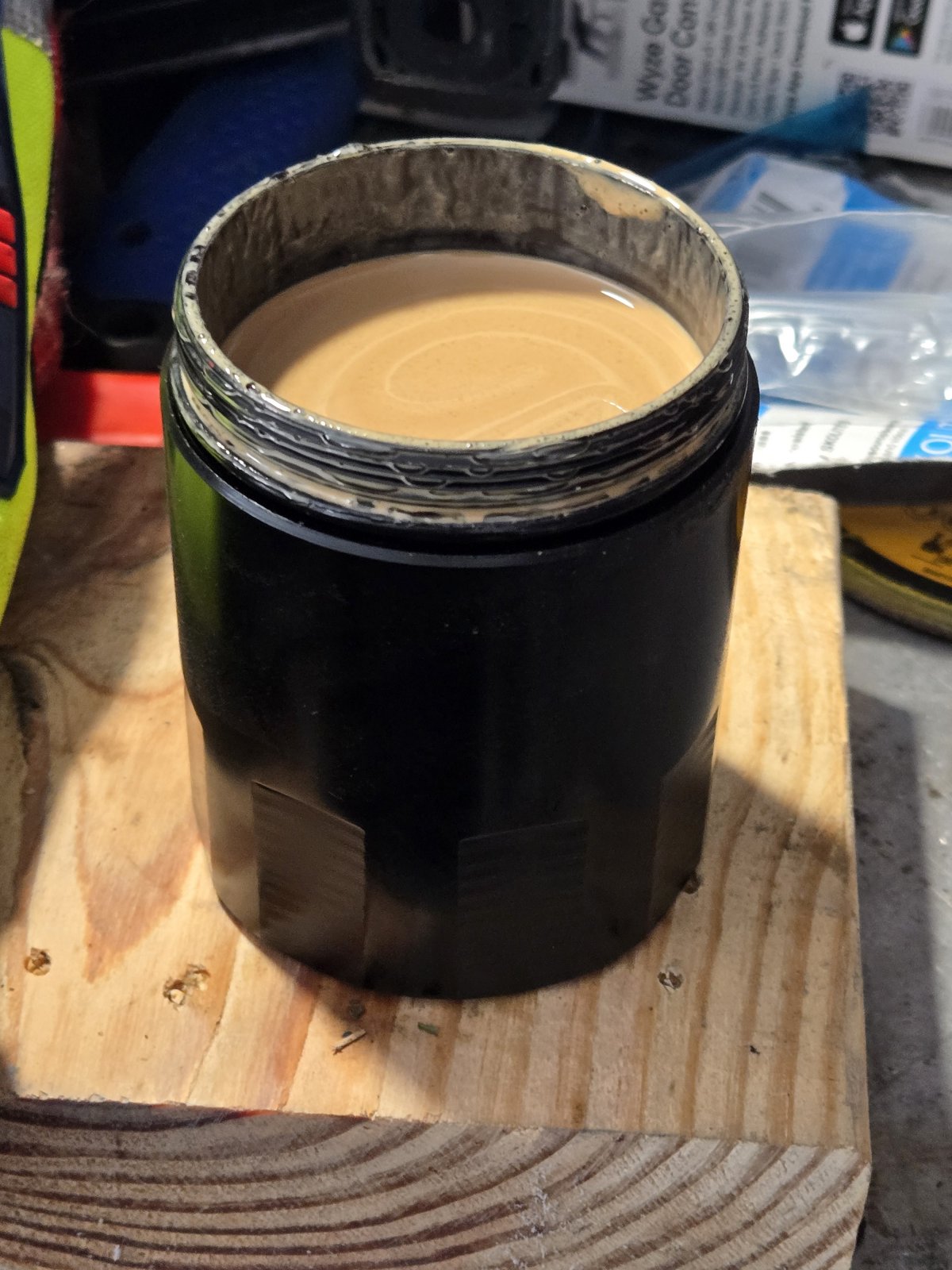

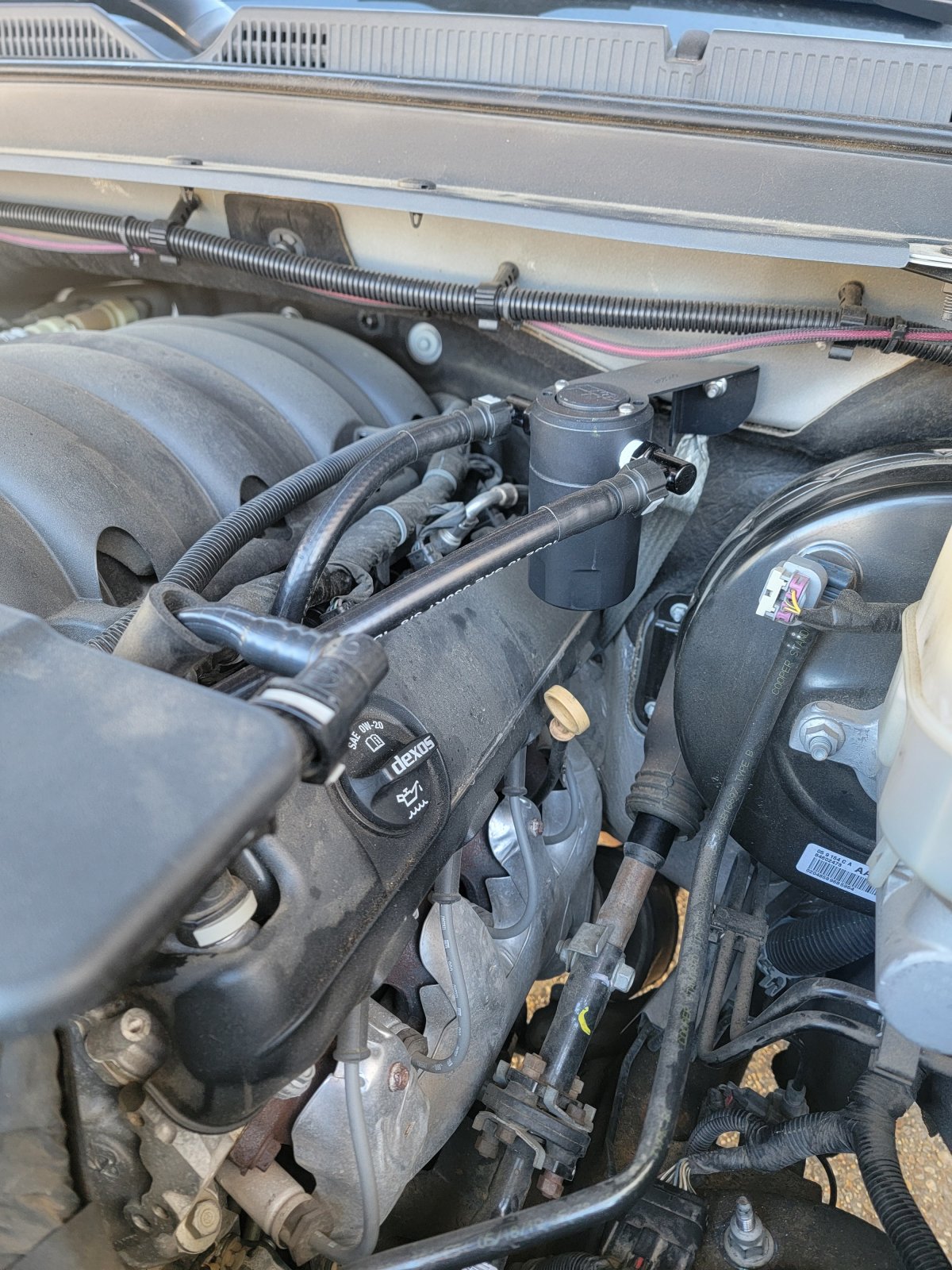

Or so I thought! The attached pics are after a WEEK!
I installed the K&N catch can last Sunday. Granted we had some pretty significant cold weather here in Louisiana this past week, but still!

Track the fluid ounces of oil captured and the miles driven. This will give you a long term view of the catch can's functioning. After 14,000 miles of tracking, I'm averaging just under 1 fluid ounce of oil captured for every 1000 miles driven.

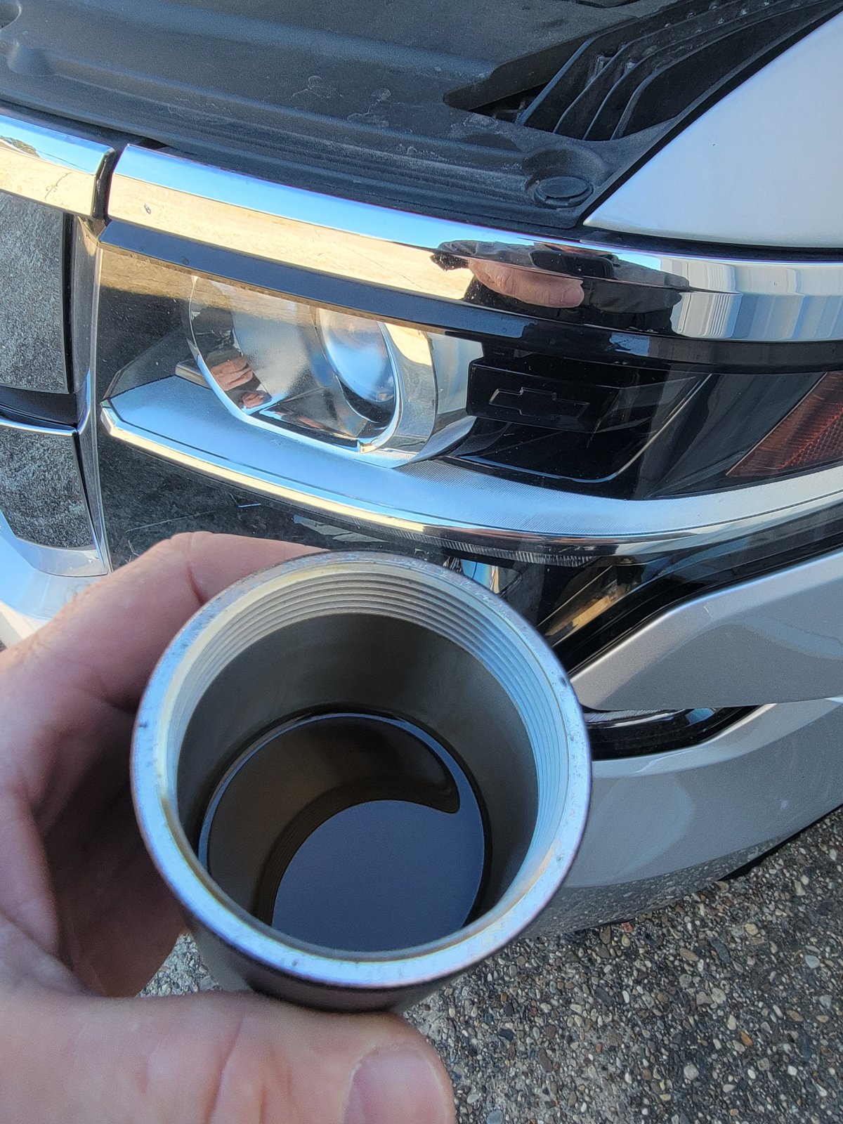

This is mine after 5000 miles some of which were at 85-90 mph and being in teens and single digits. Engine has 290,000 on it.

I would increase the frequency of checking your reservoir, if it's full it can't extract any more oil vapor. With 290k I'd expect a bit of blow-by.
That's the plan. The last round was 6000 miles and it was half full.
