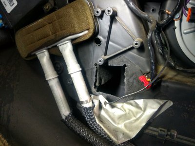

So over the summer, I wondered why the rear AC was mediocre. As we moved into winter, I noticed I had no rear heat. Pulled the panel off and fount this. Bend motor removed, hole cut out in air box and screw run through blend door holding it in the cold position. Gotta love backyard hacks.

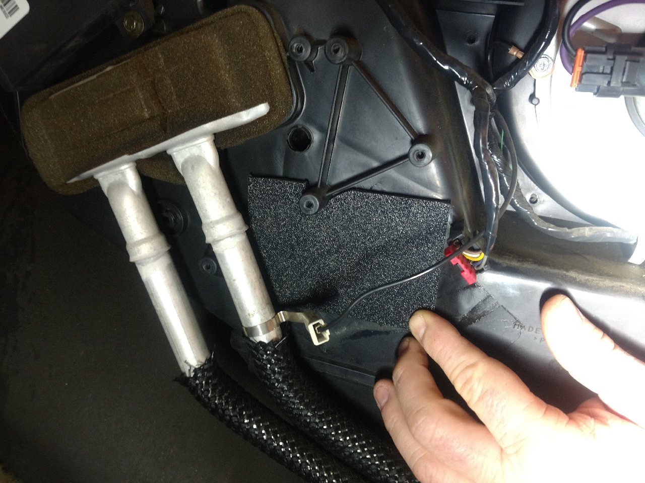

Short term, I secured the blend door in the heat mode, and covered the hole better with some real duct tape. Long term, ill install a new blend motor and glue a piece of ABS over the hole once I know its working

That is a butcher "Git 'Er Done" method that you found.
I know this will rub some the wrong way but this is why I hate when people start talking about cutting fuel pump access doors in their rigs. Harder the other way to remove fuel pump? SURE, but is the recommended way and IMO safer way. In a hard core side impact the floor could buckle enough so that the cut away sharp edges rise and do leg damage to someone. But some are gonna do what some are gonna do.

@OP wonder if you could find a junkyard housing?
Going to pursue this option as well, as it looks like the mechanical actuator for the blend door has been tossed as well. No idea yet, if this is an available part from GM. Finding a complete air box gets me all the pieces, as well as a good chance of a working blend motor.
I agree with you @PNW VietVet Shortcuts are one thing, but just plain hacking up something to save time or money just costs in the long run. If the previous owner paid someone to do this, dang, it could not have cost that much more to just diagnose and repair.
At the least, they could have unplugged the blend motor, manually cranked it to the cold position and left it. No need to butcher the air box if making the repair wa snot in the cards at that time.
