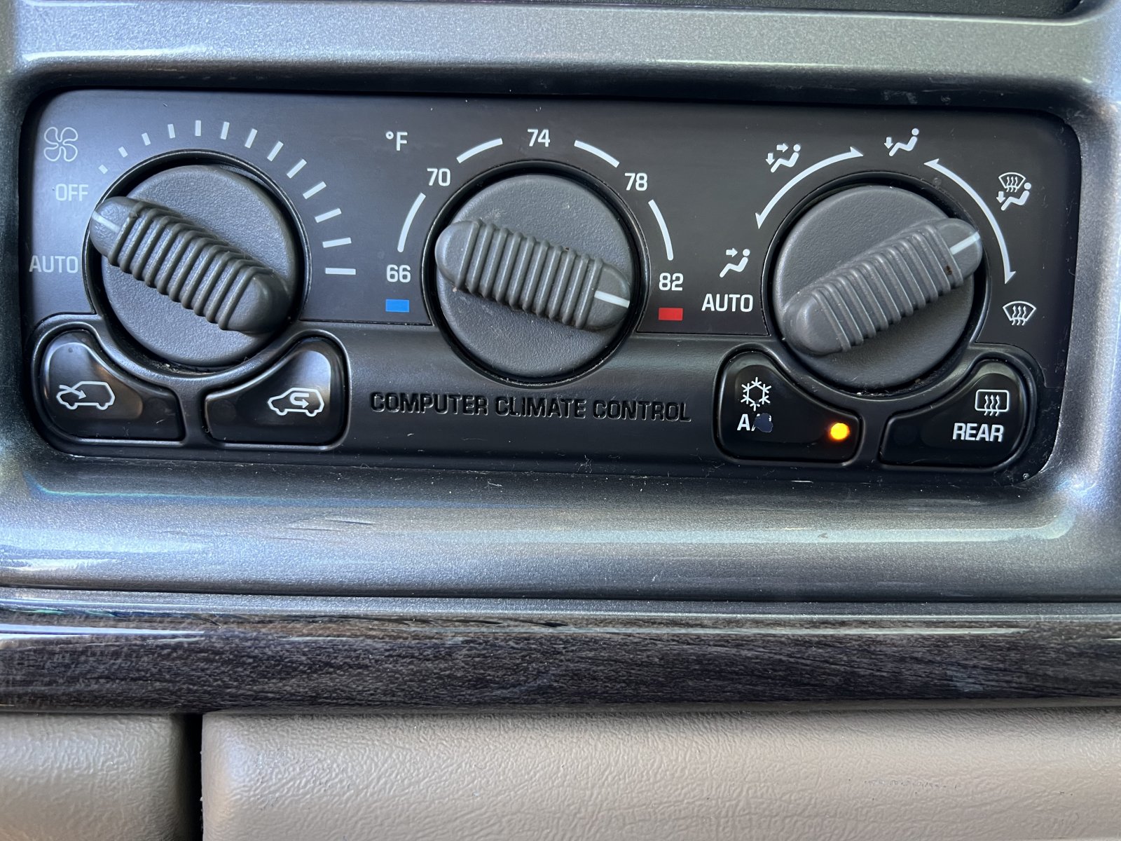

It’s a 2002 GMC Yukon Denali I believe it’s a manual I miss understood when the guy at oreillys was talking about. I figured based on research online that it was an updated version, seeing how they are prone to fail. The control module doesn’t respond to any change in speed temperature or direction, just stays on ac and is on high. Even when the key is out. Thanks.

So turns out I got the wrong resistor. I swapped the resistor with the new one and still nothing changed. Could it possibly be the climate control? The climate control doesn’t respond to any change.

Hell, anything is possible. Did you try to disconnect the battery cables and touch the cables together for 30 seconds and then reconnect and try again?
