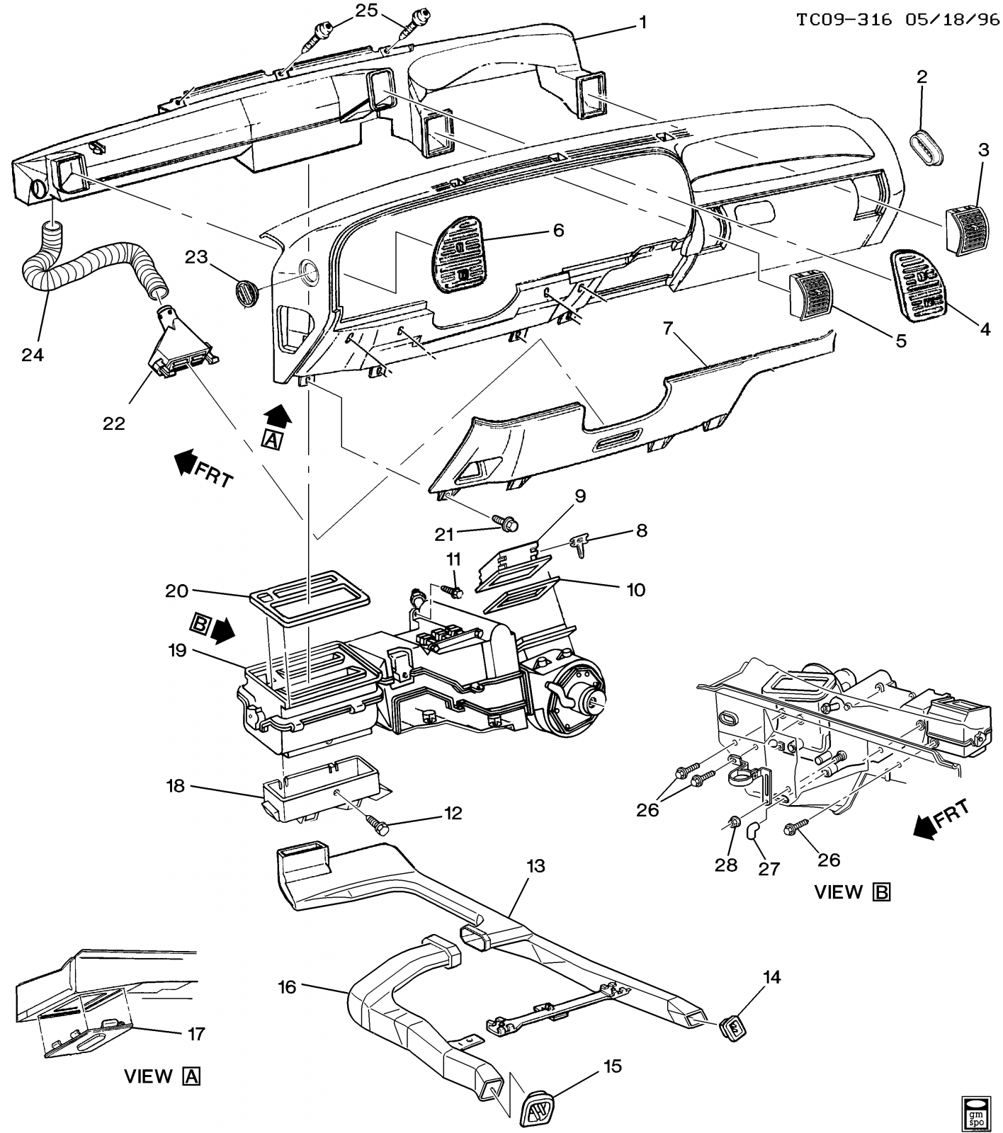

Trying to source a part/identify it. The piece that connects the HVAC box to the rear climate control ducting. This lies directly below the HVAC box on the transmission tunnel.

The GM part numbers are in the far right column. For a regular cab pickup (without the rear duct) it’s 15714779. For an extended/crew cab pickup, two or four door SUV it’s 15732262.
