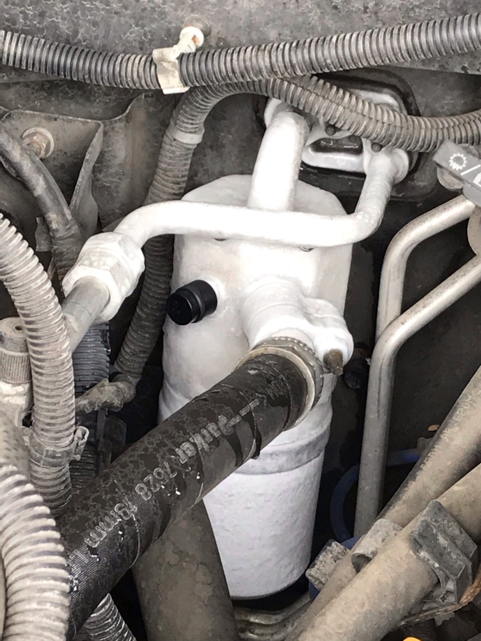

I'm having problems with my AC canister underhood (sorry forgot what it was called) freezing up during AC during the summer which causes blockage of airflow in the cabin. I'm also having the same problem with the defrost. I shut them off so the cannister can defrost to run my AC/Defrost another little while before I have to do it again. Blend doors are currently not my issue as air flow goes where I have the dial set to. This is starting to really get on my nerves Lol! Any help on what it may be would be great!! Thank you!!

If its freezing up, we really need a good quality gauge at least on the low side of the system.
Thats called the accumulator (referencing the canister you're mentioning)
Im not 100% sure on a 2011 model but im pretty sure its still a clutch cycling system. If so, then we really need to know the low side pressure of the system before going further. Theres not much else i can do without knowing this yet.
Also, being a 2011 model even tho you have manual temp controls, it may also be in control of freeze up issues. Ill have to look into that.
But really...cant really go further without knowing the running system pressures on the high and low sides. Could be a number of things. Overcharged, undercharged, weak compressor, stuck open rear AC expansion valve, high head pressure, failed closed clutch cycling switch...just to name some things.

Also about the 2 wire plug, my accumulator doesn't have it. Unless I'm really overlooking something.

Ok... if you follow that large suction line back to the compressor, is there a 2 wire switch at all?
This system may not use the clutch cycling method like the 2006 and prior models do if there is no switch.
Your setup may be like that. So in this case, there are some other ways that GM uses to control it.
Some compressors have a control valve inside the compressor to keep the pressure above the freezing point.
Others use a sensor located inside the evaporator housing to monitor temperatures and when they get below freezing it will then cycle the compressor off. Yours is probably some form of this method
We need to figure out which one you have. Might need a scan tool that can access the HVAC module to see things further. I know you said you have manual Controls, but now a days its still computer controlled LOL!!

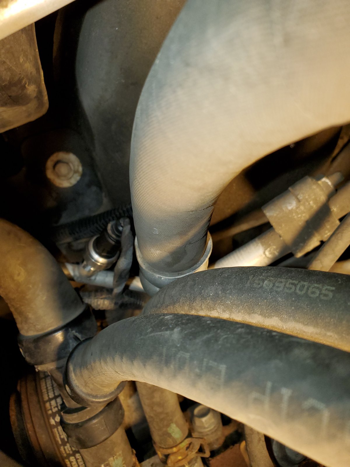

After searching the net it seems like the switch is closer to the compressor. Ill try and take a look later today and let you know.
09_BLK GMC
Feb 27, 2011
42
38
Belleville, MI
So just an update, I seem to have solved my issue. I changed out my cycling clutch switch. It was on the line close towards the compressor. I had both the defrost and AC running separately and didn't freeze up the accumulator. Ill let you guys know if it really fixes the issue on a longer drive.
