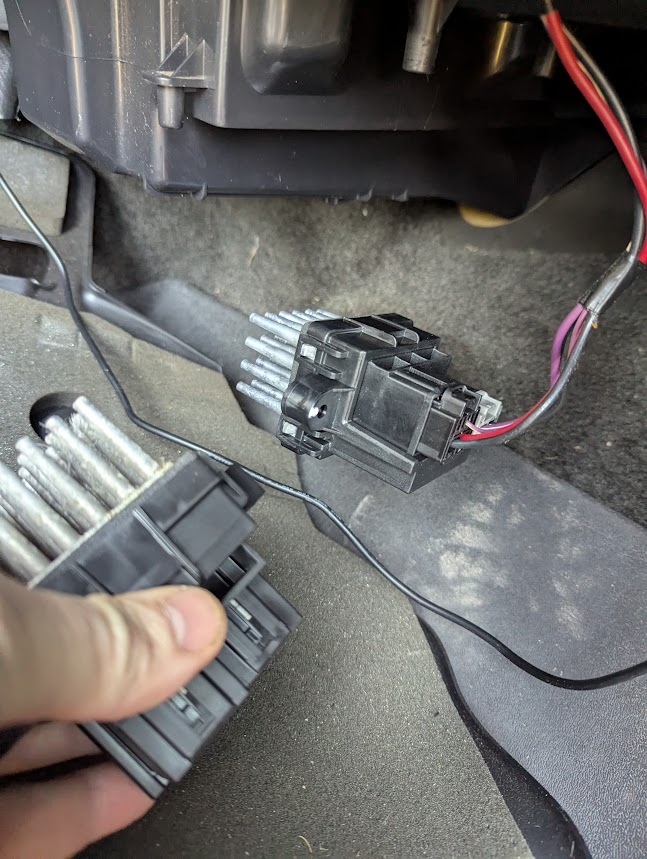

Replaced the resistor and blower, the problem was both. When I replaced the resistor it was definitely more apt to turn on high, but still didn't love lower settings. Then I replaced the blower (I had ordered both just in case) and its good as new. Just happy it wasn't the control panel/electrical issue.
