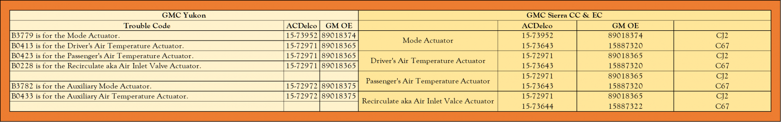

I have never been successful in doing manual relearns, always had to use the Tech-2. The driver's side actuator is at the bottom of the passenger's footwell. The passenger actuator is underneath the airbag near the fresh air actuator.
I recommend pulling the internal BCM codes before getting out the butcher knife. Use only GM OE actuators.
