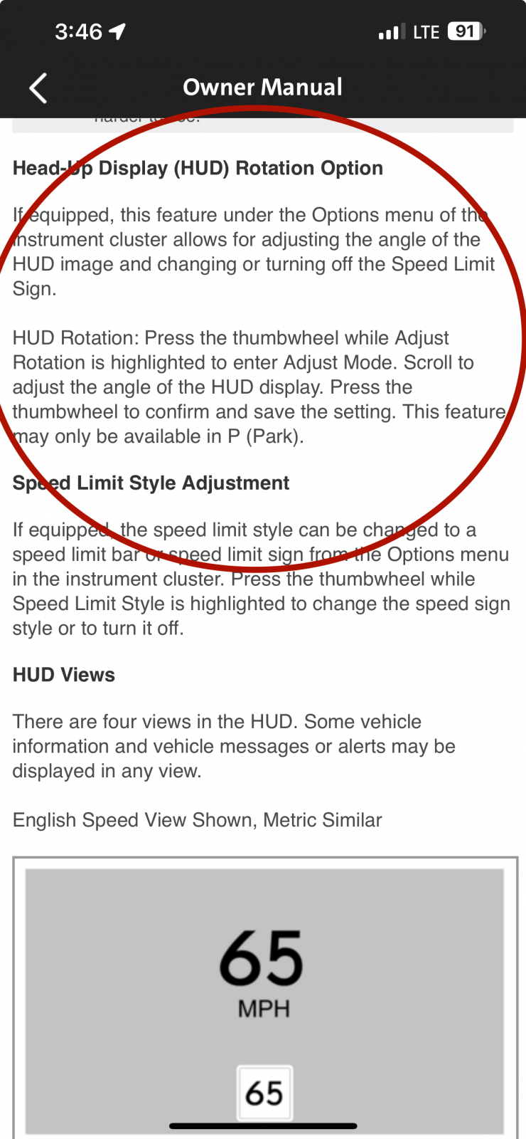

You can adjust the rotation. See owners Manual;
