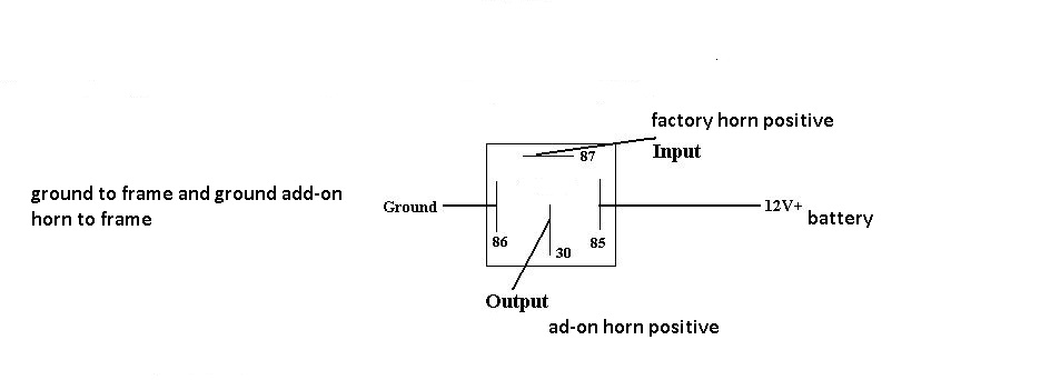

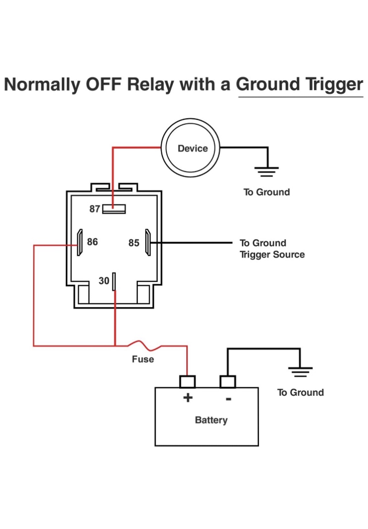

I’d like them louder and more pronounced... and would like to wire in a second pair of horns.
So I need to wire in the second pair of horns with a relay?

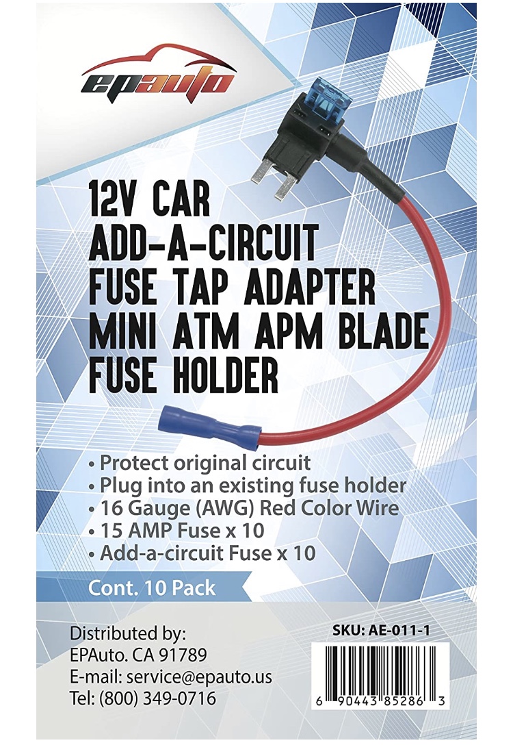

Or can I just splice into the existing wiring and plug in the second pair of horns? Can the 15A fuse handle that??
