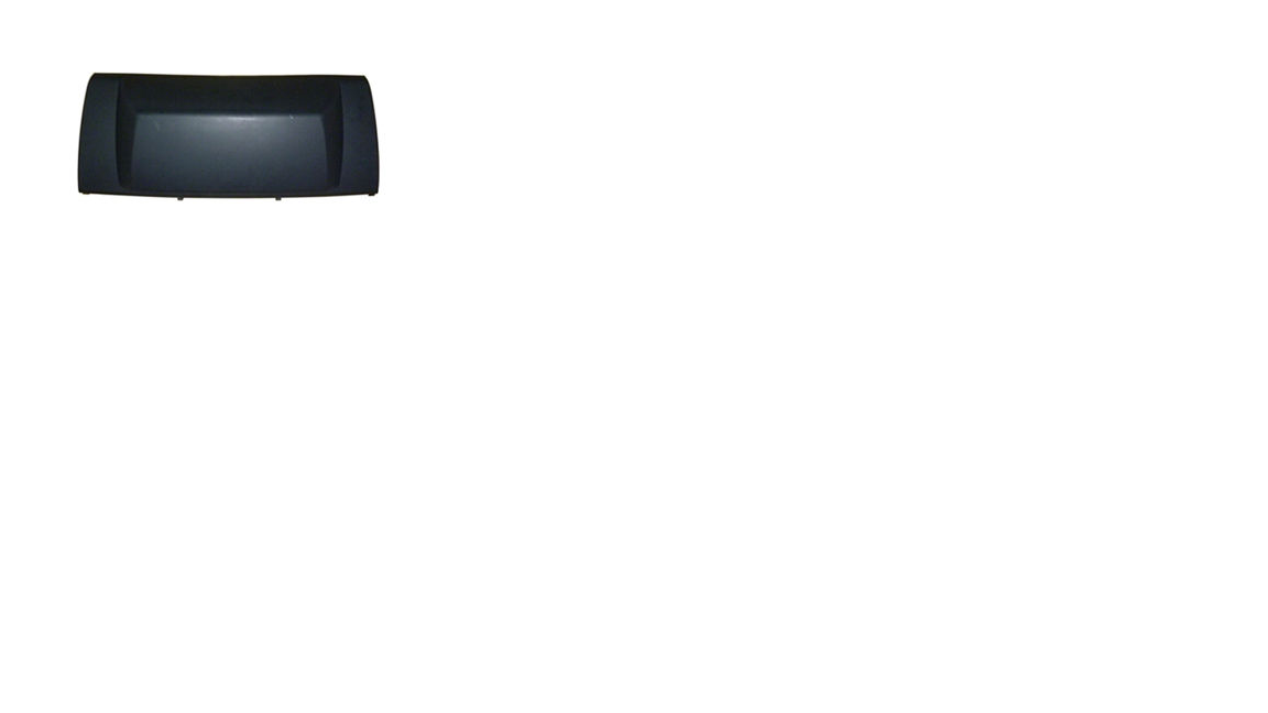

Didn't want to start a new thread so bringing this one back to life. Just completed the trailer hitch Rebar install on my 2009 PPV (I thought it was a easy task). I was able to find an OEM from a wrecked 08, which came with the electrical connections for about $50... they also removed it for me do to COVID-19 and didn't want people picking parts.
Anyway, I would like to purchase the tow hitch cover like how the civilian models come with, but their are many different styles that say fit, but don't know if anyone has done the cover.
Don't know if any of these are correct? Also, do I need to drill holes or missing a bracket behind the bumper? Getting too many different options.
