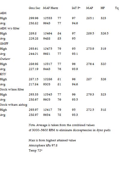

if i remember correctly, the IAT's were the biggest difference... do i remember correctly?
I think the 77 series had a bit higher IAT's

Here are the results of the test-
From top to bottom on the horsepower curve on the graph is:
AEM no filter
KNN
AEM
Stock with KNN drop in filter
Outlaw
GMPP
Stock with Fram airhog

i have been waiting a long time for that beautiful sheet of paper! Thanks a lot Jenna, does outlaw still make intakes? I thought that company is gone

if im not mistaken, the outlaw is very very very similar to the Volant setup, so the numbers would most likely be similar... don't quote me on that though

So basically the stock intake with a K&N filter got one of the top HP gains on the dyno?
What is the stock HP on the SS?
I'm confused....

Basically the test said AEM was best, then the K&N, then the stock box with K&N filter. The stock HP doesn't matter, especially since they all had gains.

Oh ok, looks like I will only get an MIT tube then.
