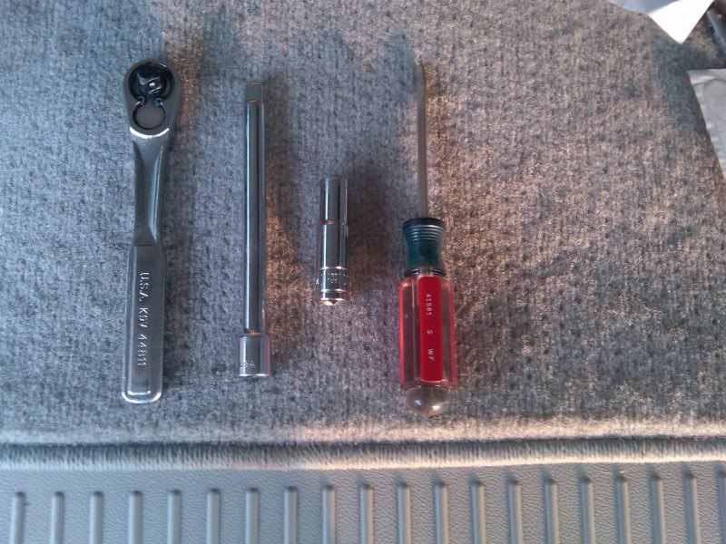

tools needed:
3/8 drive ratchet
6" extension
10mm deep well socket
standard tip screw driver

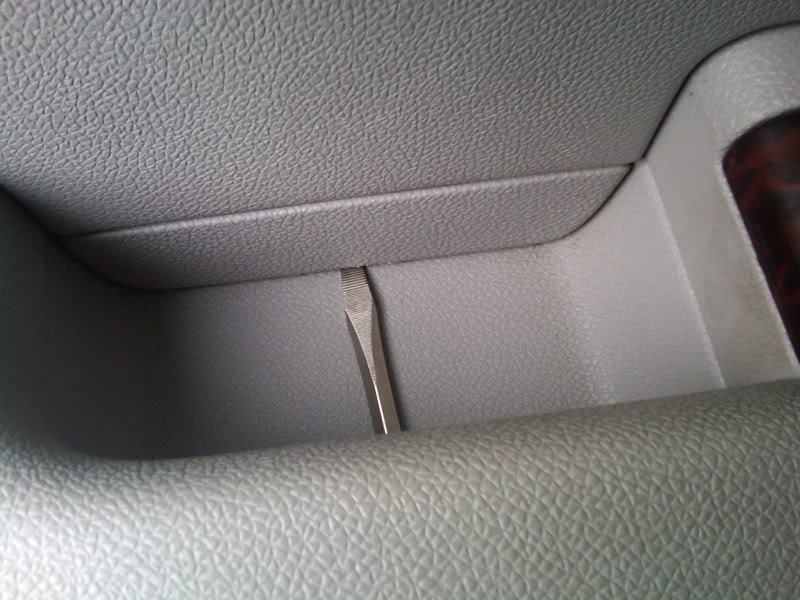

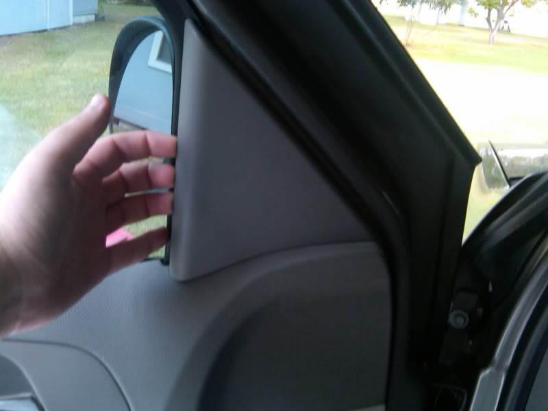

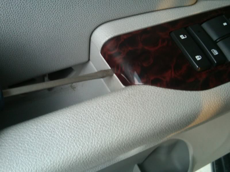

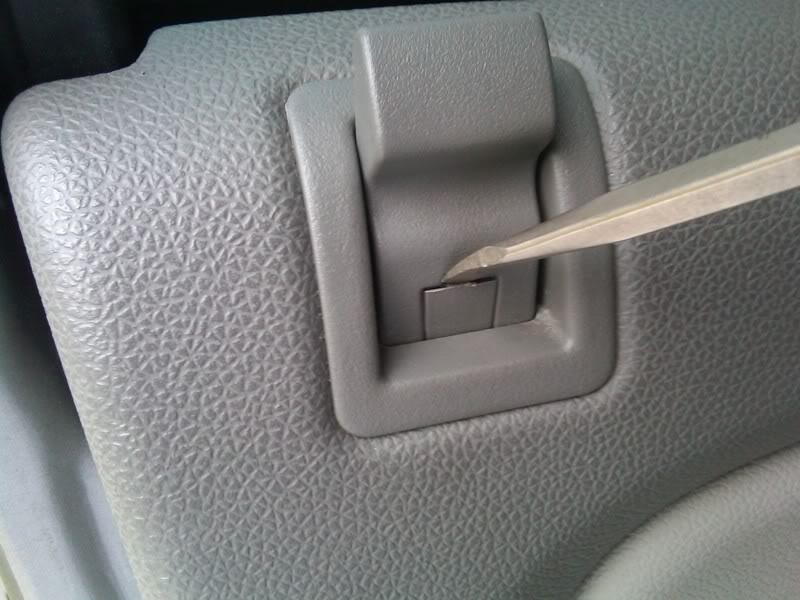

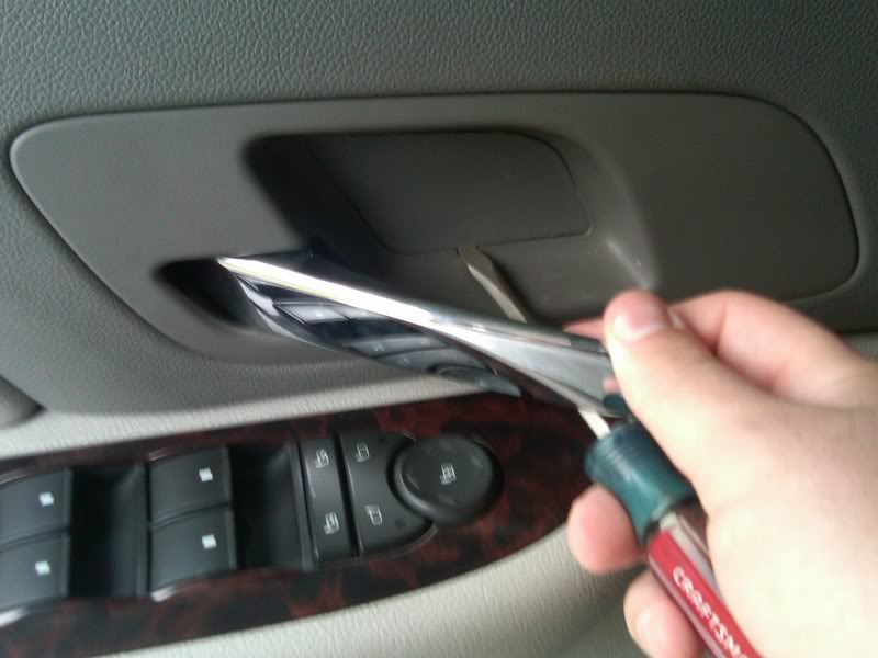

step one: remove plastic trim pieces like so:
grab here and pull
pry gently in the indention
pry gently underneath

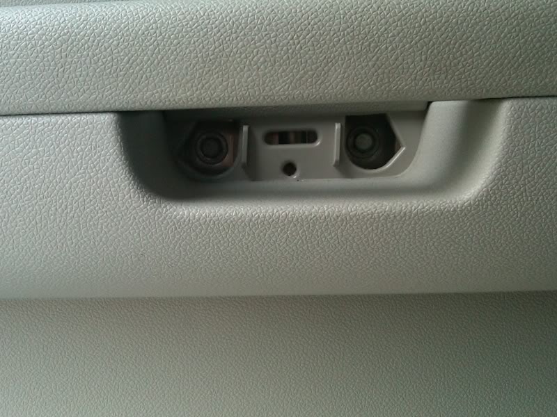

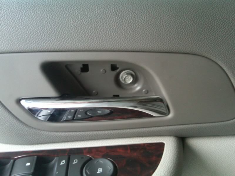

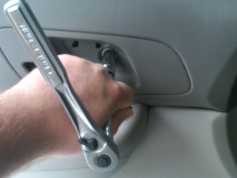

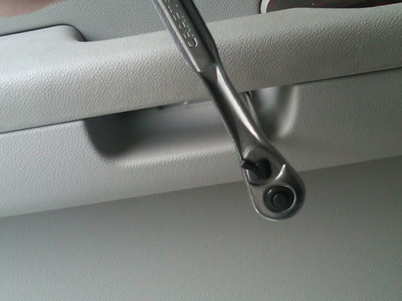

step two: remove 3 10mm bolts from below the armrest and inside the door handle:

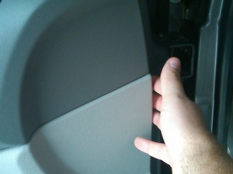

step four: grab the door panel here and pull to loosed the clips. when one is loose, work your way around the door panel and remove them all.
step five: lift up on the door panel to get it out of the "groove" that makes it flush.

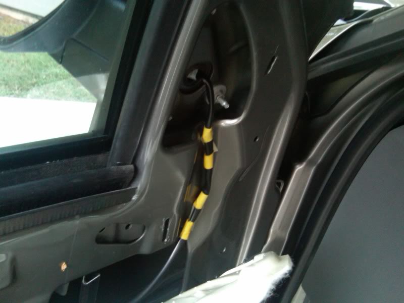

by now the door panel will be dangling by the handle cable. it'll take the stress, no worries.

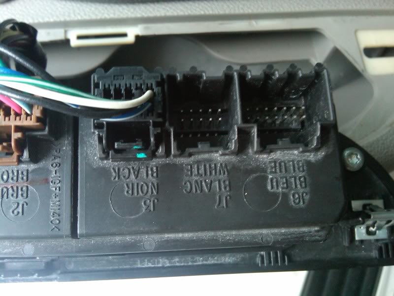

step seven: unplug the factory connectors from the back of the driver or passenger door module (switch pack).
step eight: remove the wiring harness from the door. (no pics, but held in by white clips, pull them out with needle nose pliers)

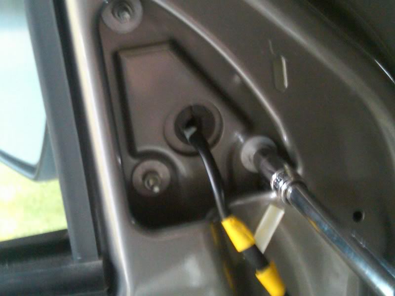

step nine: unbolt the mirrors by removing the 3 10mm nuts shown here:

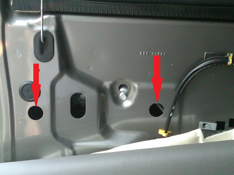

step seven: unbolt the door handles through the 2 holes shown here (2 10mm bolts, don't drop them):
step eight: unhook the latches from the handles (no pics) and slide the handle towards the front of the vehicle and pull them out.
