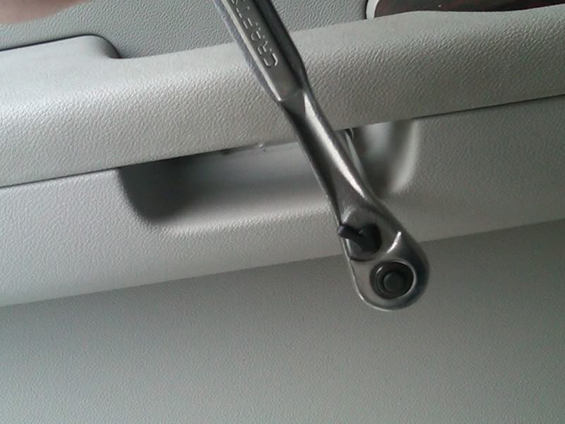

step two: remove 3 10mm bolts from below the armrest and inside the door handle:

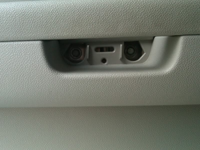

if you're changing the door handles:
step seven: unbolt the door handles through the 2 holes shown here (2 10mm bolts, don't drop them):
step eight: unhook the latches from the handles (no pics) and slide the handle towards the front of the vehicle and pull them out.
step nine: reinstall using the opposite steps.
