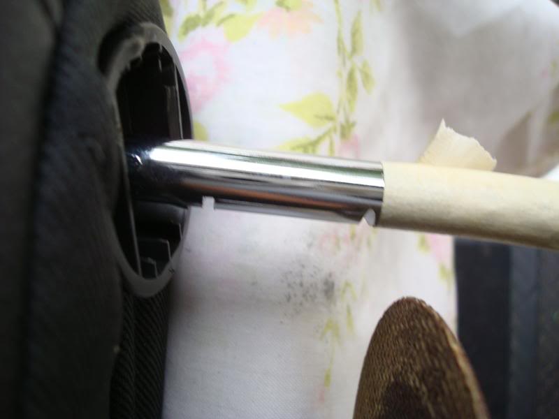

to take the OEM NNBS rear headrests off, there is a tiny hole on the trim cover.
(you do NOT have to take off the black cover, I just did it for pics)
use a small punch, and press in the release.
the odd part is they face the same way, so one is facing out, and one is facing in between the posts.

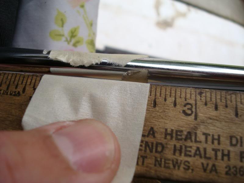

i marked off an inch down, and put some tape on it
you could use a peice of black tape to mark it down about 3/4 an inch.
to put the tape on the post, wrap it backwards around the ruler, then align it, and wrap it
used an air grinder, the blade is the perfect size.

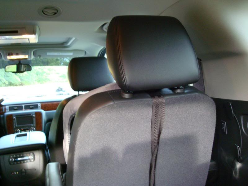

here is the OEM picture:
here is the pic of the headrest one inch up:

the caveat will be, you will need to slide the front seat up to allow the headrest to clear, so the seat can fold & tumble forward, but you have to do that in an LT anyways, so IDK.

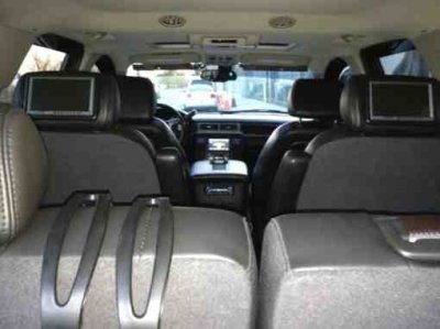

The denali uses a smaller headrest that is adjustable for the automatic seat. Check one out it may suit your needs not the best picture but you can see the difference in size. ImageUploadedByTapatalk 21372367346.848215.jpg

wow...those are much smaller. i wonder if it's because they have the DVD in there?
my rears look as big as the fronts, in the pics..
08grey
Jun 17, 2012
4,596
725
I put those tv's in myself. They were smaller regularly. Probably because the seat auto folds and is not supposed to get caught on the seat in front of it.
