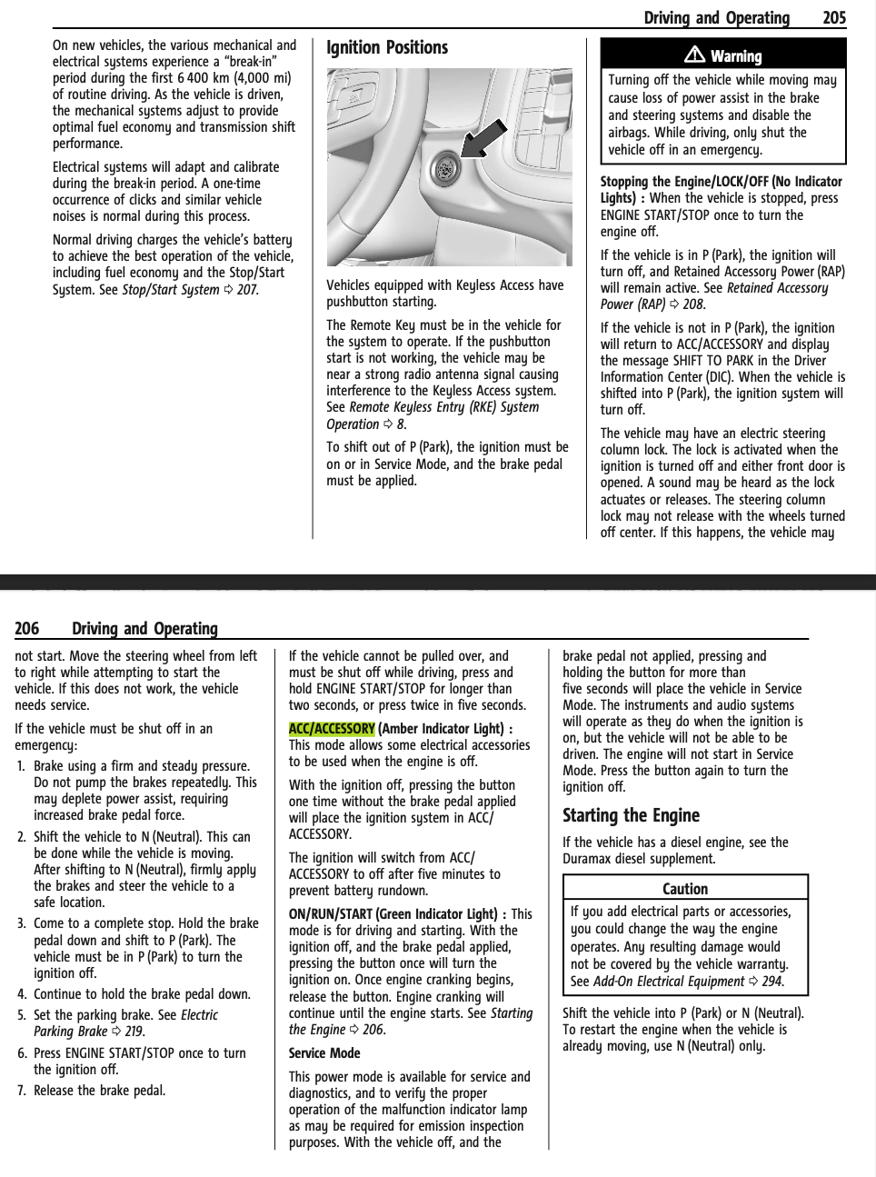

Service mode seems to be the best option; ACC/ACCESSORY turns off ofter 5 min. Owners manual your friend here
A better option may be to take a portable, battery operated radio along and use that vs. your Vehicle's Radio?!?!

You guys are awesome, thanks much. I knew it had to be possible somehow. @WalleyeMikeIII for the win though. Great find.
So ya just gonna throw 2 spare c-cells and a portable radio in the truck? Or risk it w/ a low battery after the show? Minimum, I’d throw in a jump pack in the back, just in case.
P.S. I recommend downloading your owners manual, that way it’s searchable as a PDF and it makes finding these things easy!
