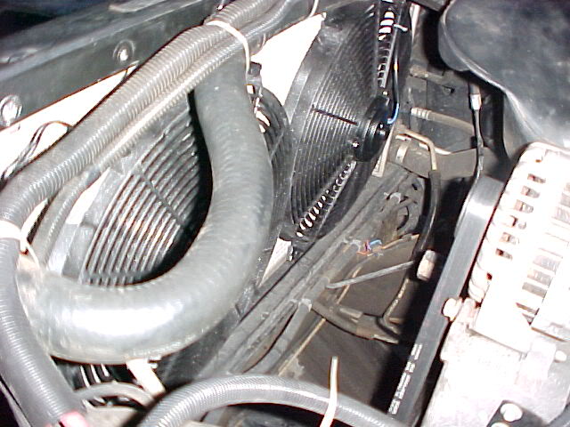

in my 03 gmc the when the clutch fan took its 3 rd and last crap on me i was out of warranty, so i bought 2 16 inch pro comp fans, ditched the shroud, ran a fog light set up switch a relay for each fan and used the on off switch as needed, left em on full time for the most part, made the ac work better then ever before.
if i had thought there was a pinned wire to add to the pcm to make it work i would have gone that route of course, but the fans were not on the 03 trucks, so i went about doing it old school.
truck ran a degree or two cooler too.

those fans i installed were on a 2500 HD pick up with a 6.0 iirc they were 20 ish a fan.
