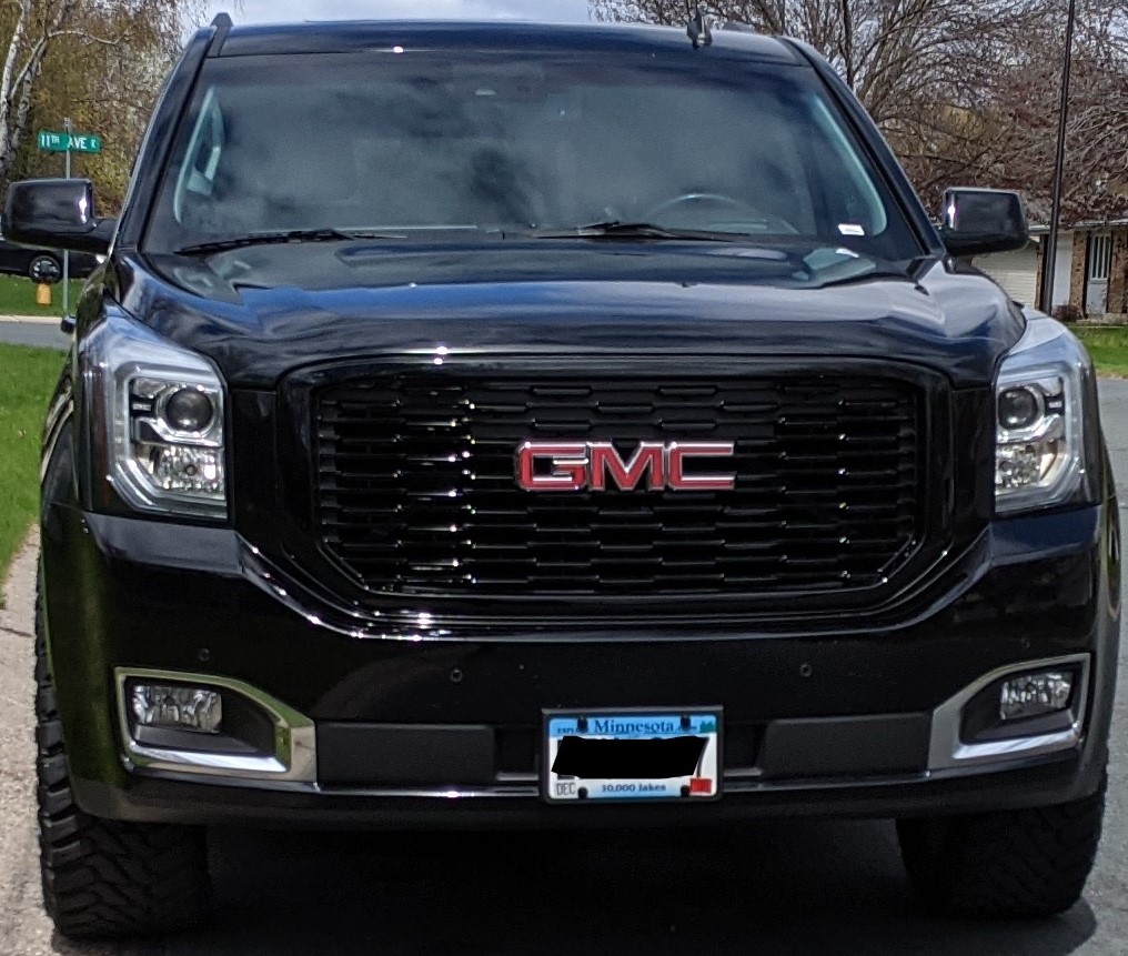

Thanks for the tip on bumper cover tabs on the top edges. Ended up fixing a few that broke with fiber-glass tape. Not sure it was even need though as the single splash shield screw probably would hold them together as is. I'll be taking it off again if the morimotos ever ship. What are your thoughts on taping the upper bumper cover side seems and using a pry-tool to wedge the bumper cover down while pulling out the sides? May give that a shot on the next go. Here's how mine turned out. Have a stock 15 chrome denali grill in good shape if anyone's interested.
