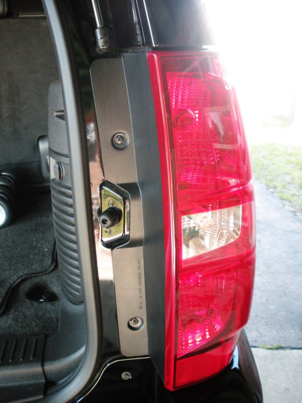

Remove your stock tail lights by using a Phillips head screw driver and unscrewing the two screws you see in the pic below. With gentle pressure, the tail light will pop out towards you after the screws are removed. Follow the harness down under the truck and you will see where it is attached to bottom. Unclip it and remove the tail light and harness assembly. Set aside.

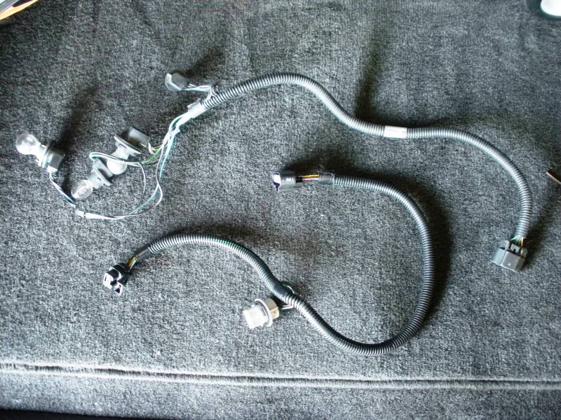

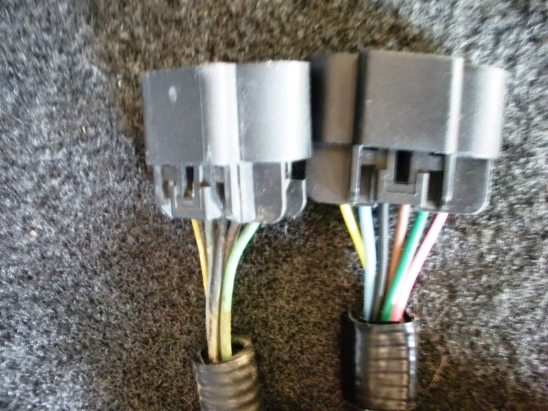

Remove the Light harness from the Escalade Tail Lamp. Pictured below is the Escalade Harness on the bottom and the Tahoe Harness on top, you can see the obvious difference.

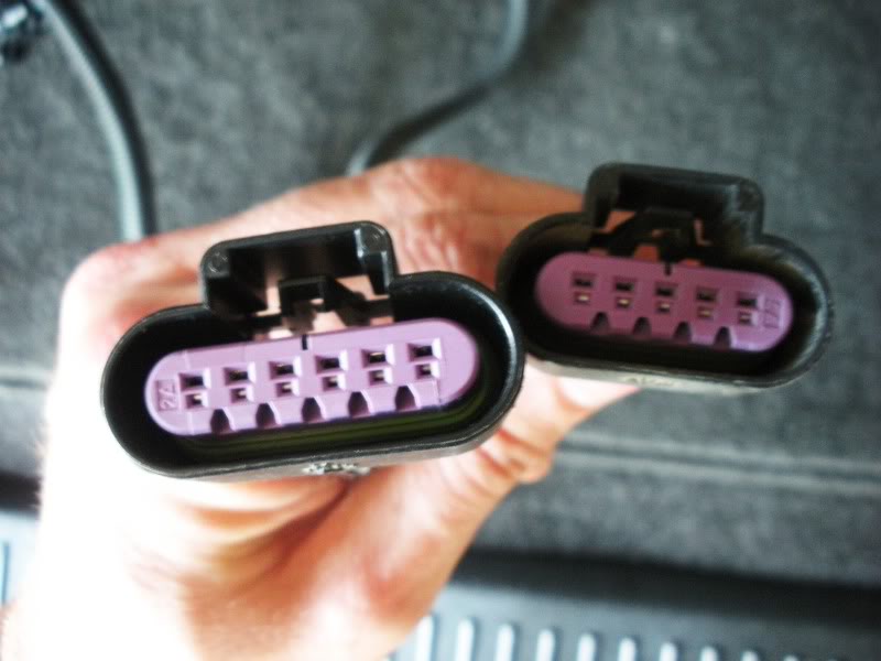

This is a shot of the plugs of the Escalade lights and Tahoe lights. This is why you need the Hopkins Trailer Harness Convertor. Escalade has 5 wires and Tahoe has 4.

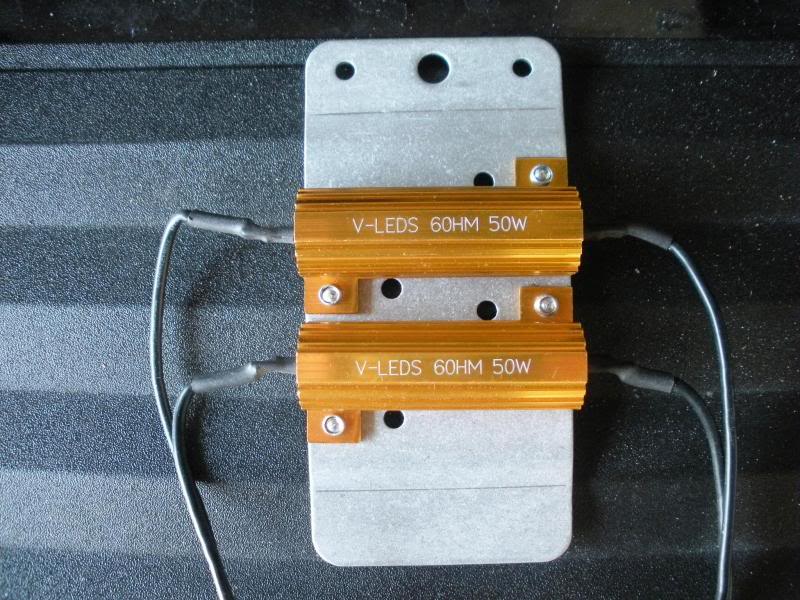

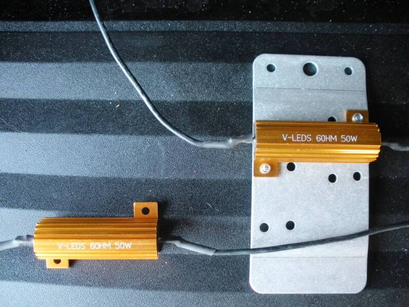

Before we get into the harnesses, let's go ahead and mount those resistors to their mounting plates. Due to them getting extremely hot, it was recommended by v-leds.com to mount them to an aluminum plate to dissapate heat and then mount those to a metal surface (we'll get to that). So, me being OCD, I bought the resistors and plates and used a rivet gun from Harbor Freight ($5.49) and riveted them to the plate, as pictured.
Aren't the pretty??

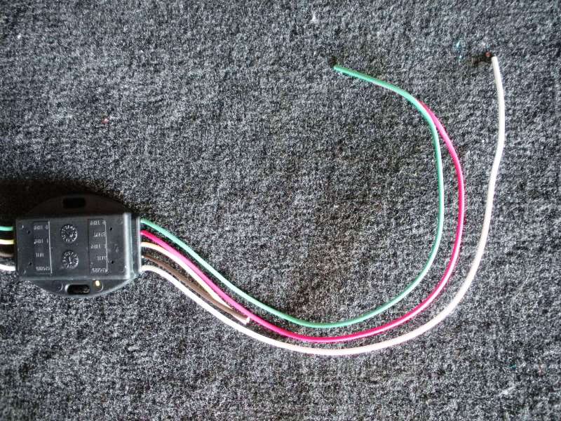

Also in this picture is the Hopkins Trailer Harness, shown above the resistor plates. We'll hack that harness up shortly...

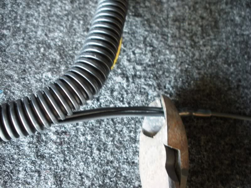

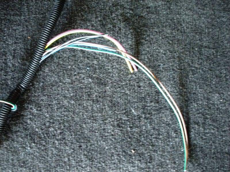

We're going to start modifying and splicing the Escalade Harness first. Peel back the wireloom until you get right about to the reverse lamp bulb. Cut the actual harness off about 4" behind the main plug, as pictured. Set the harness aside.
(pic below are both Escalade harnesses to show you how far to cut back)

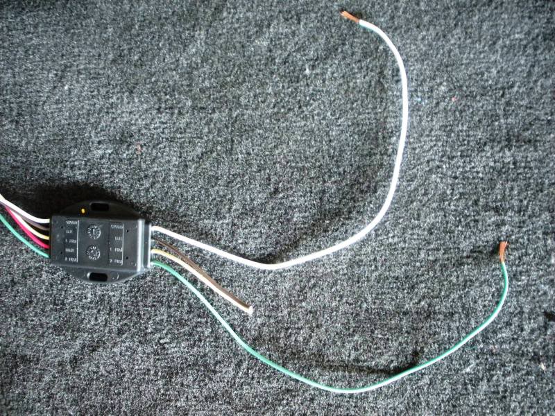

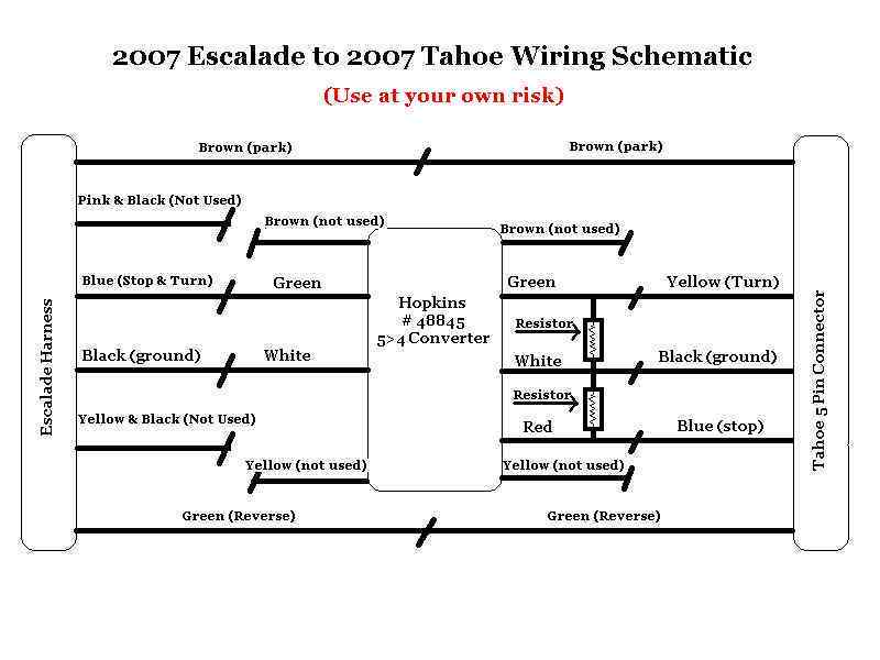

Using this schematic, you are going to want to make connections between the Escalade Harness and the 4-wire side of the Hopkins Harness:

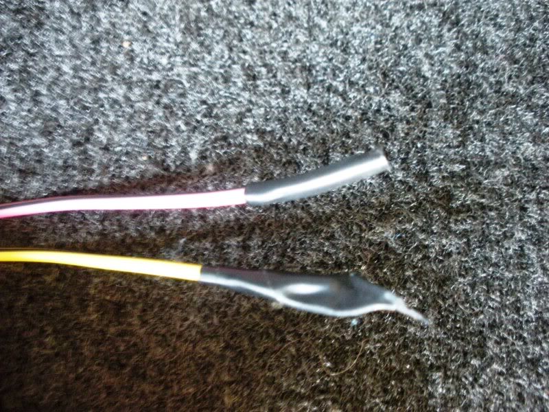

I cut the wires labeled "not used" till they were about 3" long, wrapped the tips with electrical tape, and kept them hanging loose until it was time to finish the harness, like so:
Trailer Harness
Escalade Harness
Taped Tips:

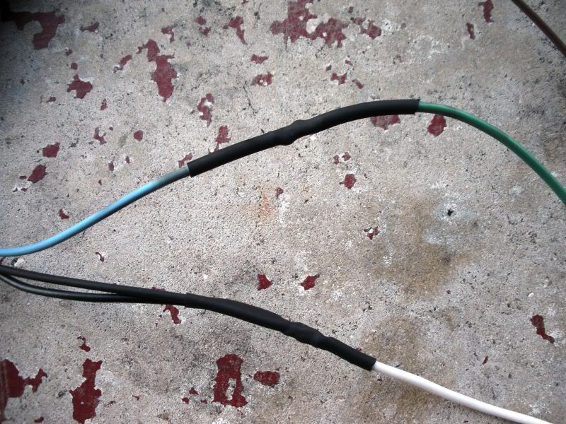

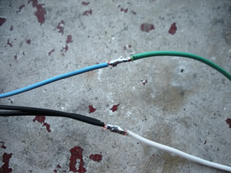

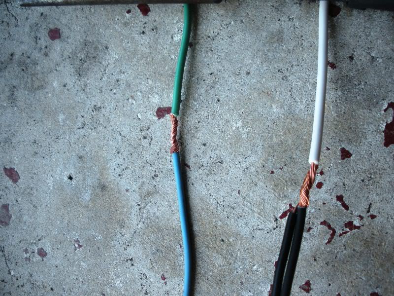

Now, on the Escalade harness, there are two black wires that are crimped down into one. I cut the crimp off to expose both wires, yanked about 1/2" of plastic off to expose the wire, and twisted them together while matching them up to the appropriate colored wire on the trailer harness.
I put the black from the Escalade harness with the White of the trailer harness, and the blue of the Escalade harness with the Green of the Trailer harness. Twisted them together like so:
Then Soldered them together:
And Hit them with the heatshrink:

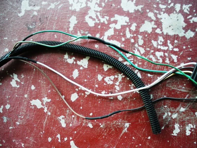

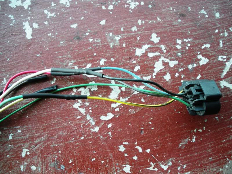

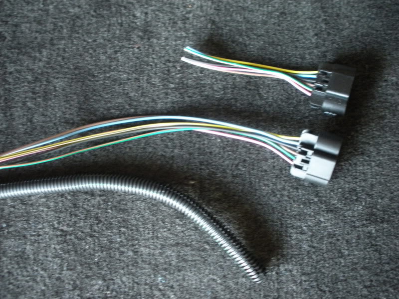

Now, time for the Tahoe harness. I pealed back the wire loom off the tahoe harness as far back as I could until I got to the first light, that's where I cut.
I left the brown and green wires as long as possible for now, and cut the remaining three wires (red, blue, and black) down to about 5" or so. The green and brown wires from the Escalade Harness get connected directly to the green and brown wires on the Tahoe Harness (do not wire through the trailer adapter!). Twist, solder, wrap, done.
Do the same with the remaining Red, Blue, and Black wires on the Tahoe harness. Utilize the schematic I posted above to show which wires those get attached to from the trailer harness. Twist, Solder, Wrap, Done!
