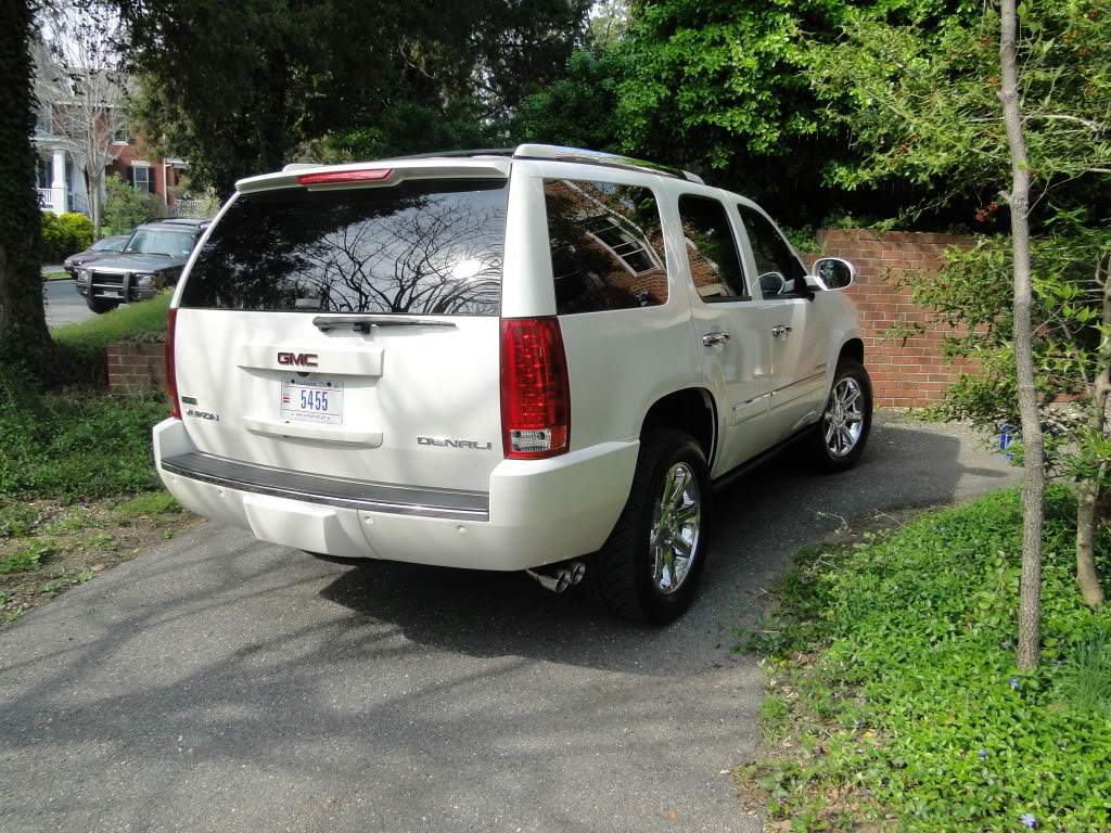

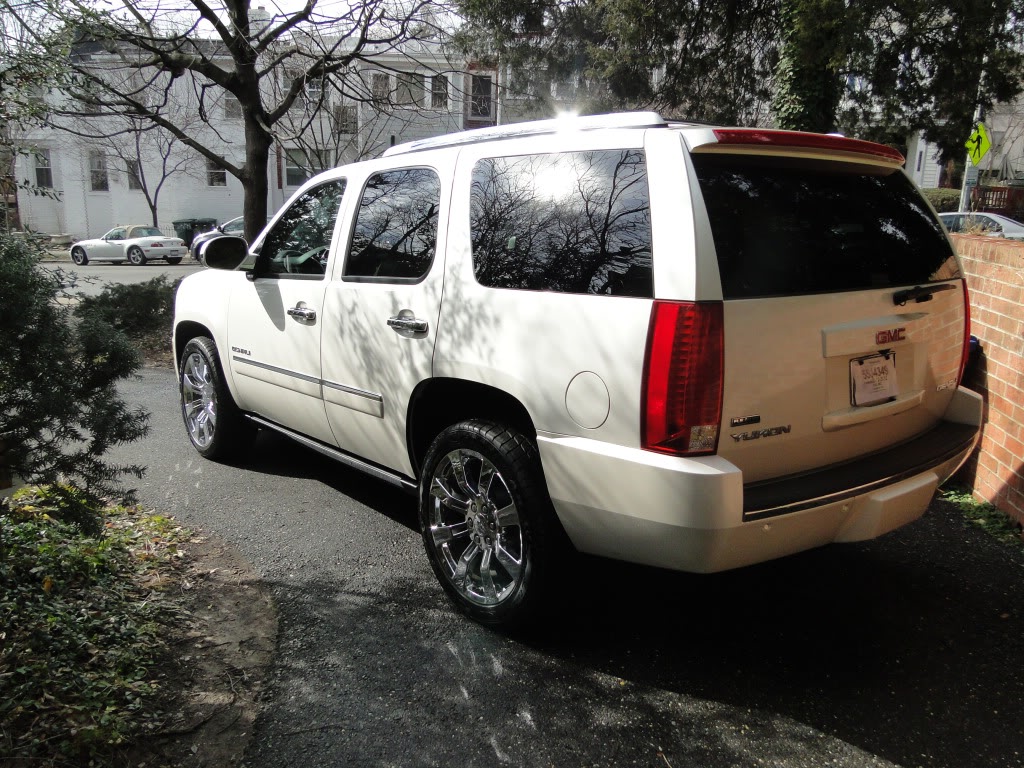

G4:
G5:
soulsea
Feb 19, 2011
11,857
667,430
Bar
That's correct ... you can se the square 'pleat' line continuing up the corresponding Escalade applique above the G5.
