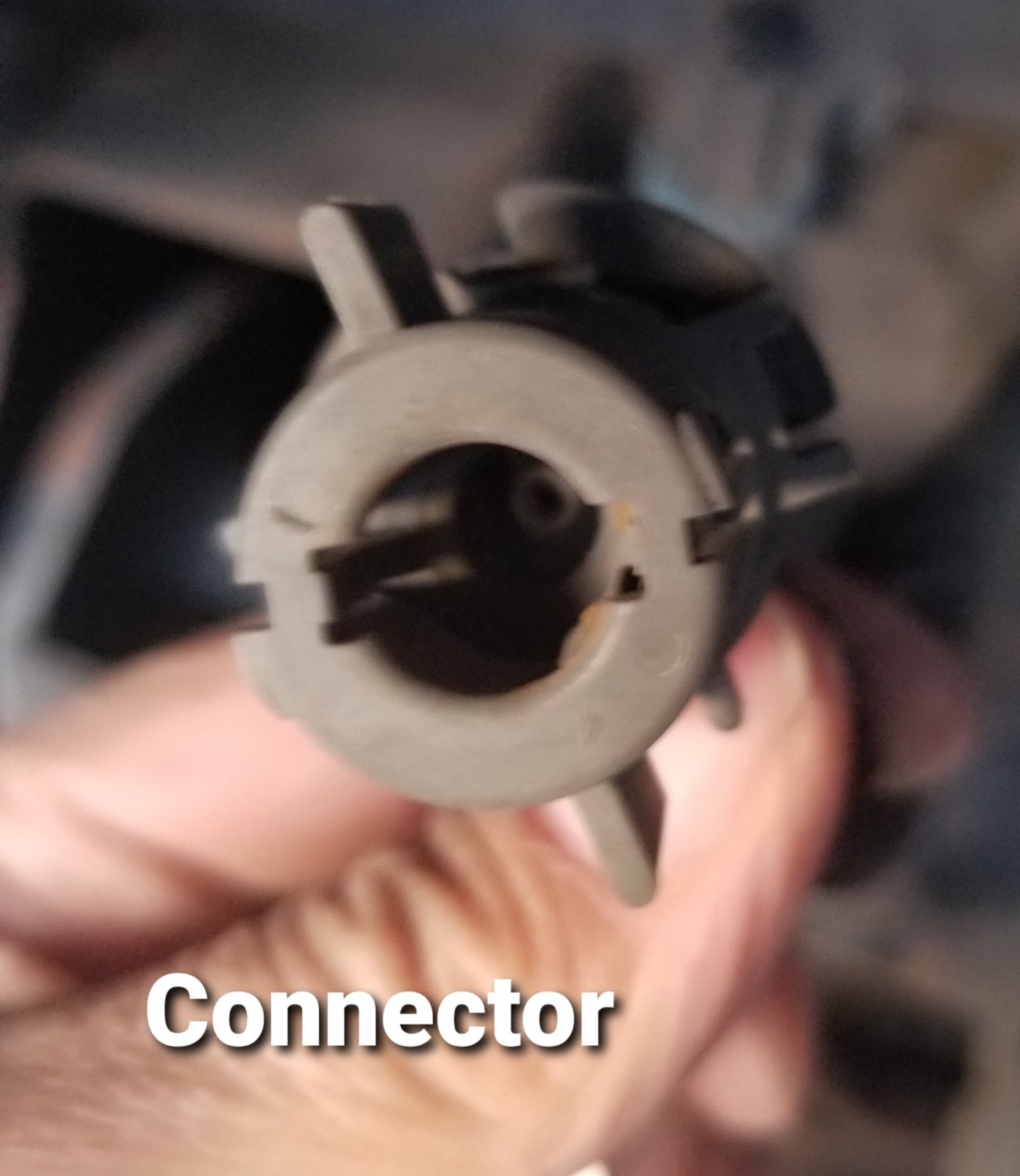

I have a 2003 GMC YUKON XL 2500 4X4 WITH Magna Ride shocks, at least that's what I was told. The shocks have a single point on top where the wiring plug attaches. I cannot find any information on these Delphi shocks, Orange and black in color. I need to bypass them so I can replace them with after market shocks. I cannot find any bypass kits for these let alone any information on them. Does anyone have information.

3-5 Ohm, 50 Watt resistors spliced into the two wires (after removing the connector shown in your photo) on all 4 shocks. You could probably get away with 10 watt resistors, as well.
