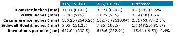

My first recommendation is to complete the planned level mod, before installing the new wheels and tires, and worrying about any trim issues. Otherwise, you will simply be guessing, and since leveling kits do not produce the exact same result for each and every truck, other folks experiences are not guaranteed to become the same experience for you, as well.
To get an initial look into what may happen with the new wheel/combination, you can use the wheel/tire size comparison app at the URL below. Measure the critical clearances identified in this app with your current wheel/tire combination into the app, add your desired wheel/tire combination into the app, and the app will provide the projected changes in the critical clearances.
https://www.wheel-size.com/calc/
Other folks will chime in with their experiences.

Ignoring the offset those are barely bigger than stock. I wouldnt stress.
