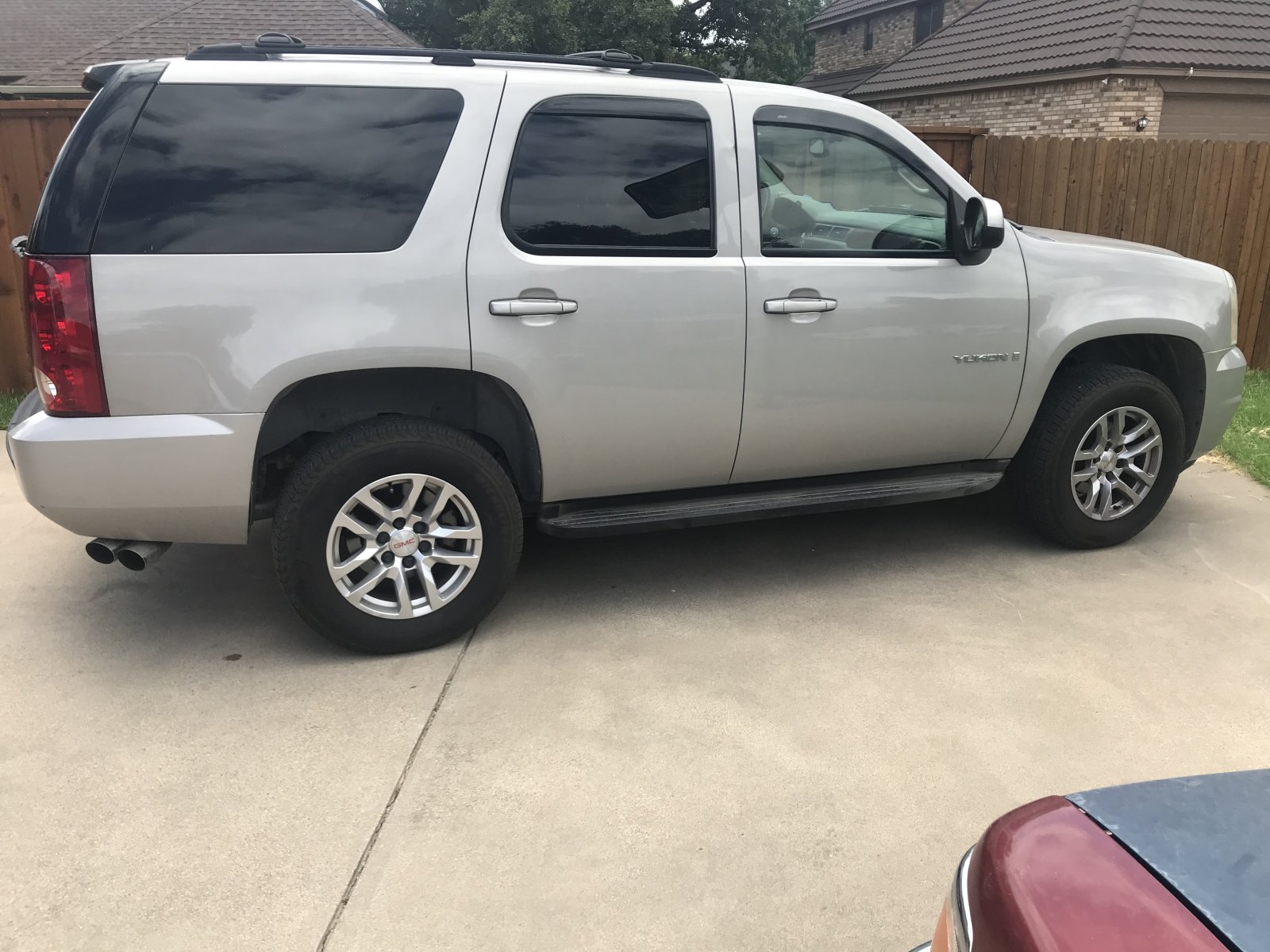

How difficult is it to remove the side mouldings and badging from a Tahoe like this one?
madmanjustice
May 13, 2019
219
382
How difficult is it to remove the side mouldings and badging from a Tahoe like this one? I would rather have it clean like my PPV was.

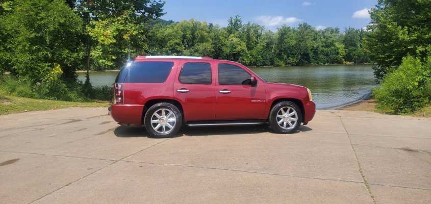

Just removed the mouldings from my Denali, used fishing line to take them off an eraser wheel for the leftover double sided tape and a little buffing with some medium compound to blend the area

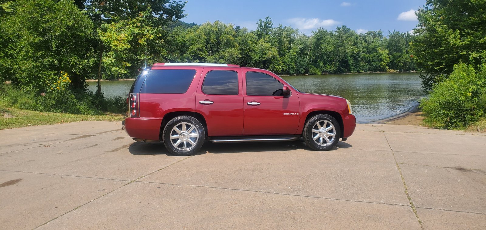

Looks great. Am considering doing the same on my ‘10 Denali. Would love to see another pic looking at front at slight angle so can see down the side.
