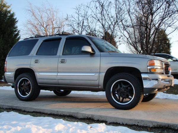

First, I was wondering if I can up spacers in the front, if so, how big before I run into problems. Second, how much can I put in the back?? I have keys up front and .750 spacer in the back. Thanks!!

If you have torsion bars... then you dont have coils.. a torsion bar IS a spring..
---------- Post added at 07:36 PM ---------- Previous post was at 07:33 PM ----------
you CAN do a 3 inch spacer in the rear and turn the keys up to 3 inches up front.. but the rides not gonna be amazing

As Mob said, no you can't put a spacer up front, you have torsion bars.
I've never felt comfortable with more than a 2" Spacer, some people say you can do more, but I wouldn't run anything past 2".

They make this sick billet 3in for them.. that looks pretty safe.... but i would NEVER go more than 3.. not even on bolt ins

Anything over 1.5" is sketchy unless you flex it out and get the perfect shocks spec'd out. I'm trying to find a set of h2 coils to try on another member's truck in hopes that it will sit about 1" higher than his sagged stock coil + 1.5" spacers.
