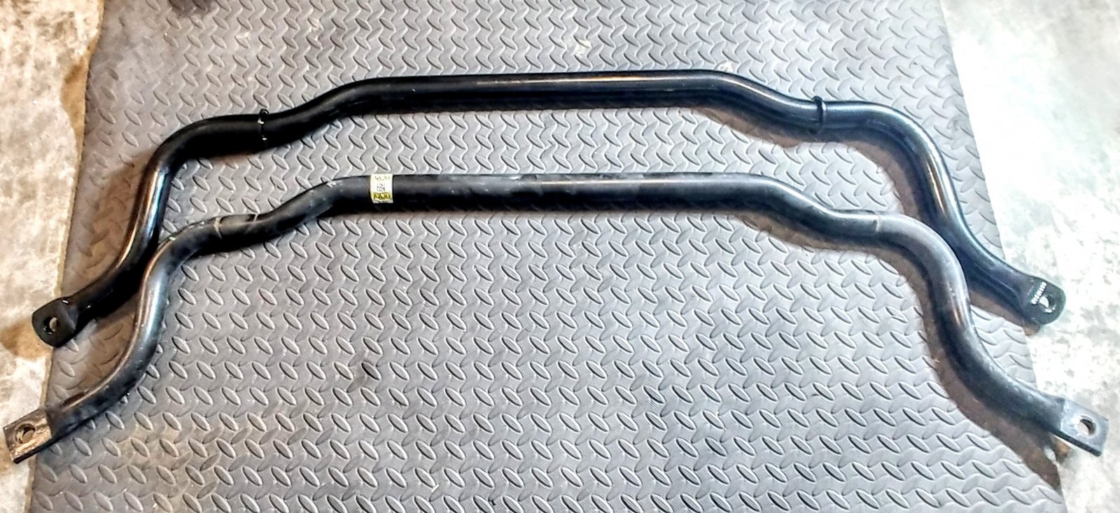

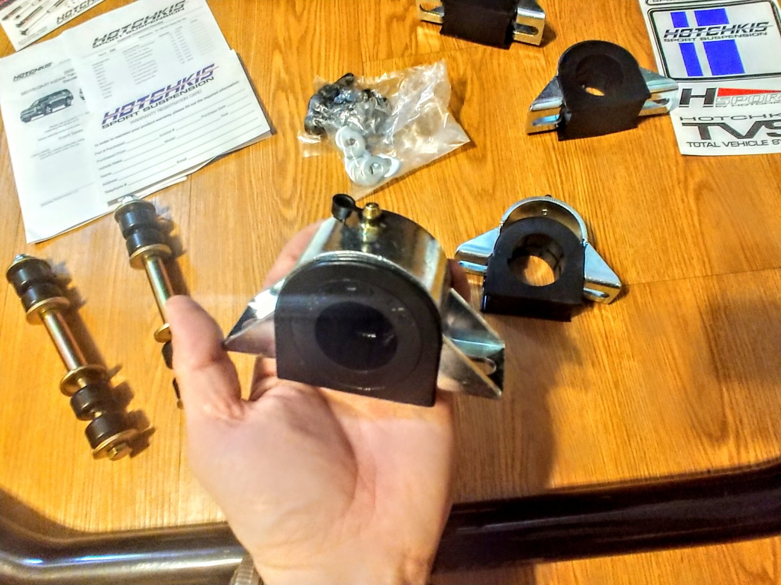

Yes, 2292. Came with 1 set of links. I'm on stock suspension.

Thanks for posting the pic. Comes with front end links. They look like typical Energy Suspension links, which are simple but a good design.
Look like nice bars and the grease zerks in the mounting brackets are nice. Other swaybar kits don’t offer that...
I’m lowered about 1.5”/2.5” and already have the DJM rear swaybar end links. Really interested to hear your impressions of installation and impacts on ride and handling.

Packaging: the kit came nicely packed in a large box. Each bar was in plastic bag and all parts and hardware came in nicely labeled bags. Plenty of foam cushion in the box to prevent scratches. Nice instructions and a cool Hotchkis sticker pack.
Installation: installation was straight forward. Instructions were easy to follow and everything fit perfectly. Took me roughly 1 hour for the front and 1/2 hour for the rear. I did not have the truck on a lift or it would have went faster.

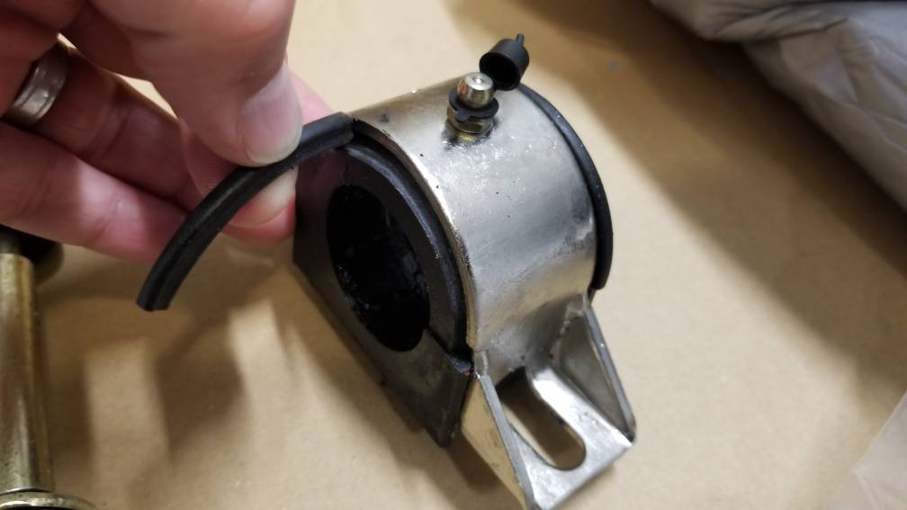

Materials: it's a nice kit. The bars are extremely beefy and the powdercoating is really nice. The kit came with front end links which are very similar to the energy suspension links/bushings. The swaybar bushings have divots on the inside of them to maintain grease longer which is a nice touch. Additionally, the brackets have zirc fittings built in to make re greasing easy. Compared to stock, the front bar is just slightly bigger diameter. The rear bar is larger than the stock bar by quite a bit. (Did not measure)

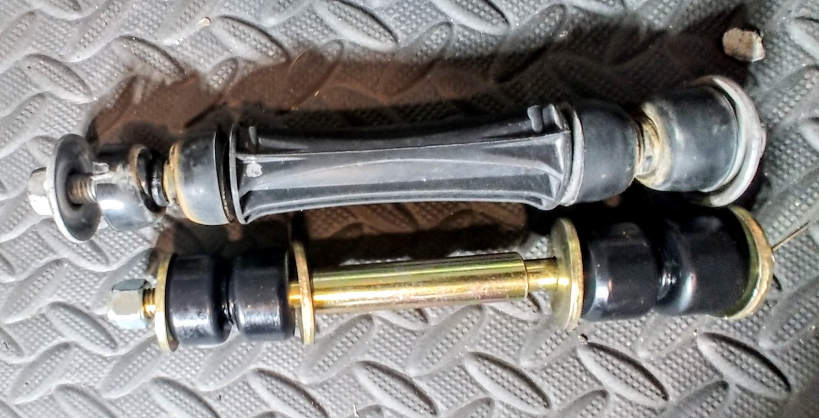

***one odd thing I noticed is the Hotchkis end links are shorter than the stock end links. Not sure why. I installed them and everything seems to work just fine.
30,553
48,018
the front endlinks are probably made shorter to make the bar more "stiff" the Hellwigs use the stock front endlinks but they do include there own endlinks for the rear sway bar.

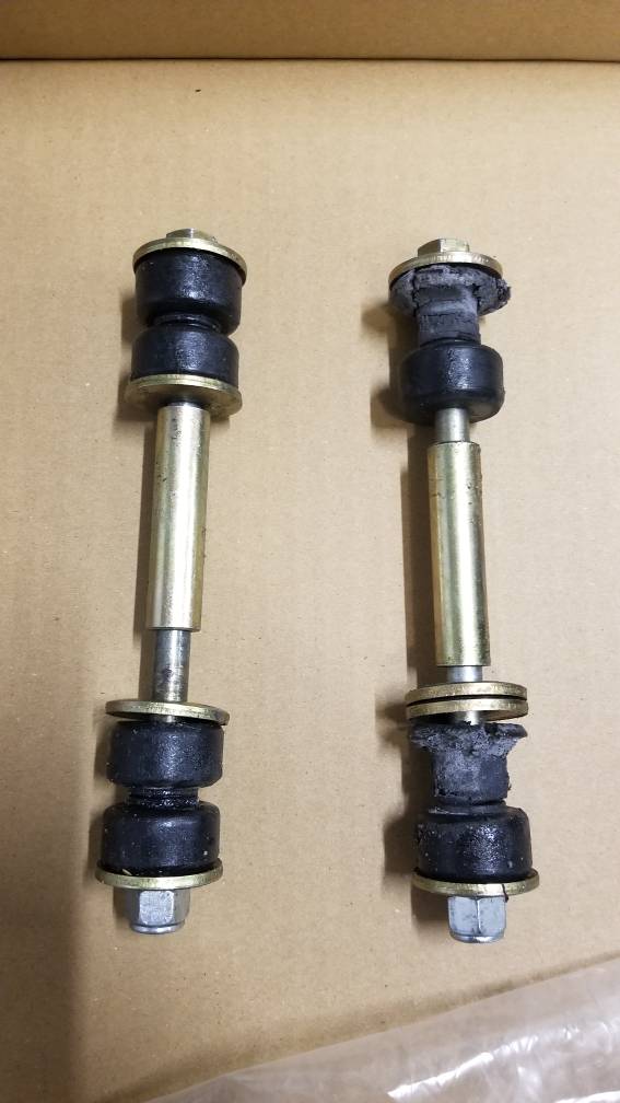

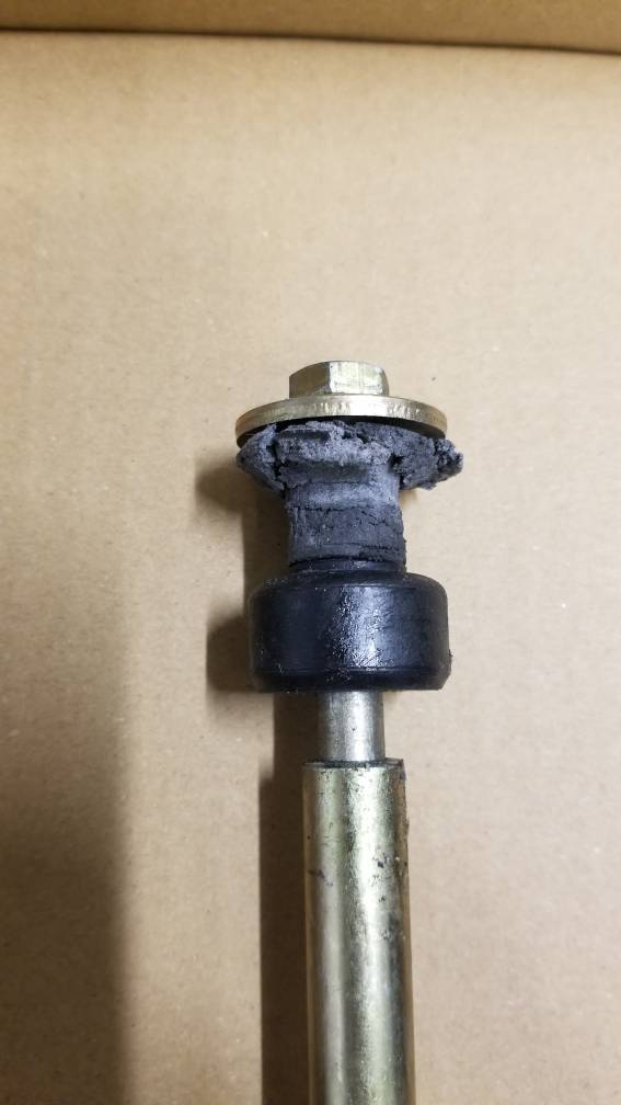

I received the rear kit this past weekend and decided to get it installed... again, easy install, etc. While under the vehicle I decided to give a quick check at the front I installed the previous weekend and that's when I was immediately caught off guard with what I saw. On the passenger side front only, the frame mounted bushing had started to tear like it was it was being pulled to the passenger side of the vehicle through the c-clamp and two of the end link bushings ( 1 on the sway bar and one on the control arm) were completely shredded. All after 6 days of driving around town. It almost looks like somethimg was binding on the passenger side.
I have no idea why this happened. Everything was lubed, torqued, etc.
Only thing i can think is there had to be something wrong with the bar possibly. I ordered from Amazon and the box appeard to have been opened previously and there was only one piece of protective foam in the box. One end of the bar was simply lying in the box freely. The bar still had the bag ****** on it and had not signs of wear and the bolts and bushings were in the unopened bags. I'm stumped.
Amazon is processing the return thankfully. I'm a little apprehensive to buy another and install at the moment.
