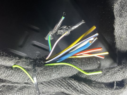

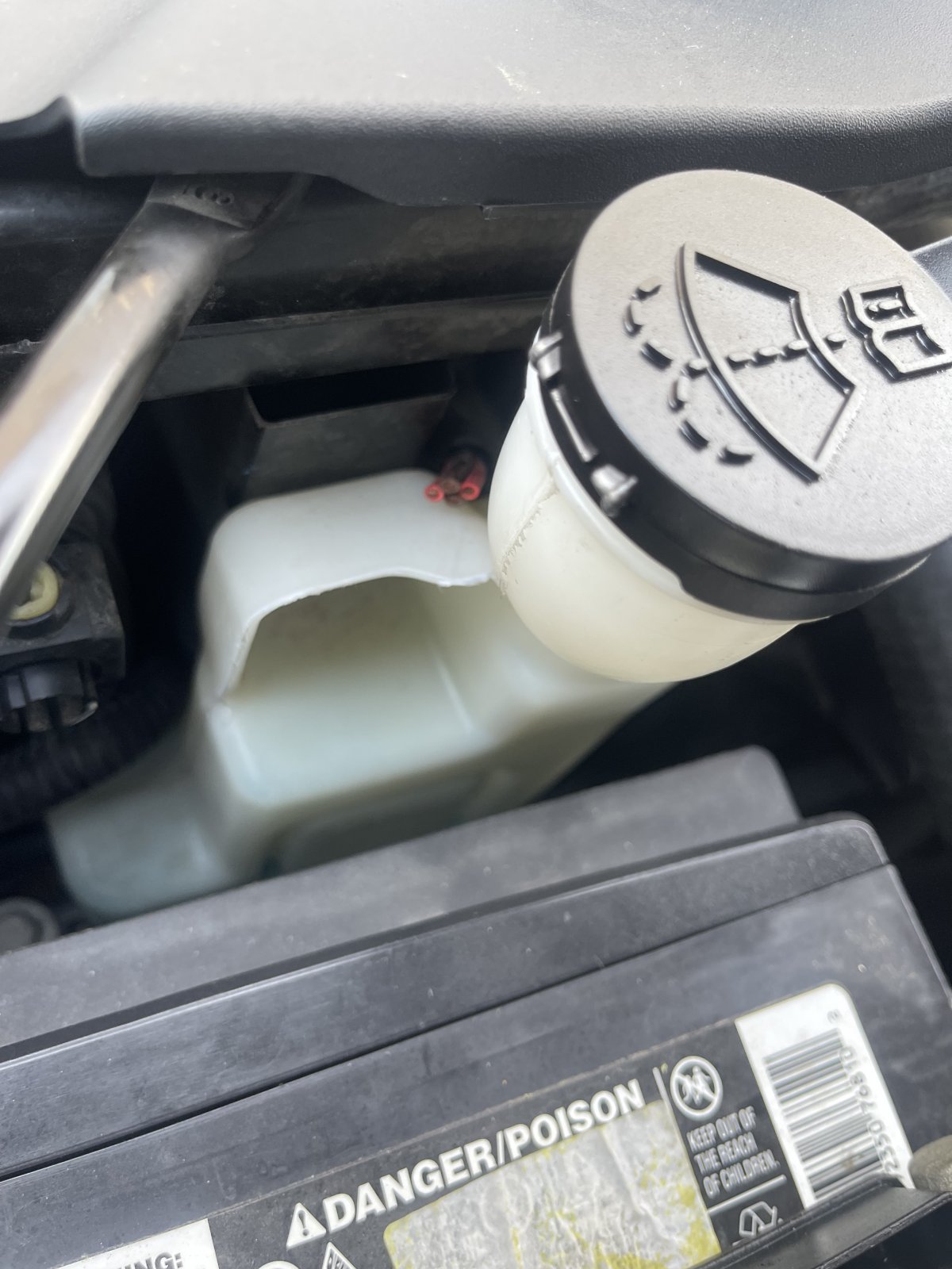

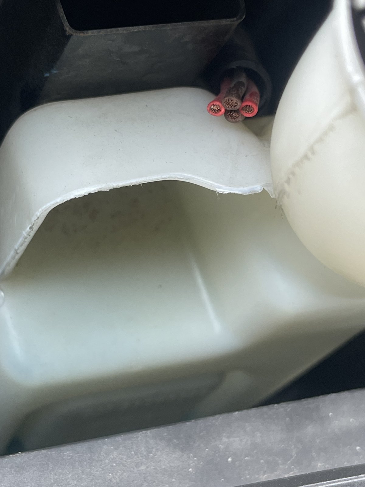

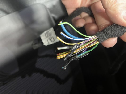

Horn is not working
Samuraj
Feb 24, 2017
474
203
Des plaines
Fuse # 93 is OK , no power to the fuse , and few wires cut by horns
What can be done ❓

Try to fix it yourself. Still burns me that I paid $350 for Ford to replace my daughters horn I could have gotten at advance auto because “it was to cold out ” for me.

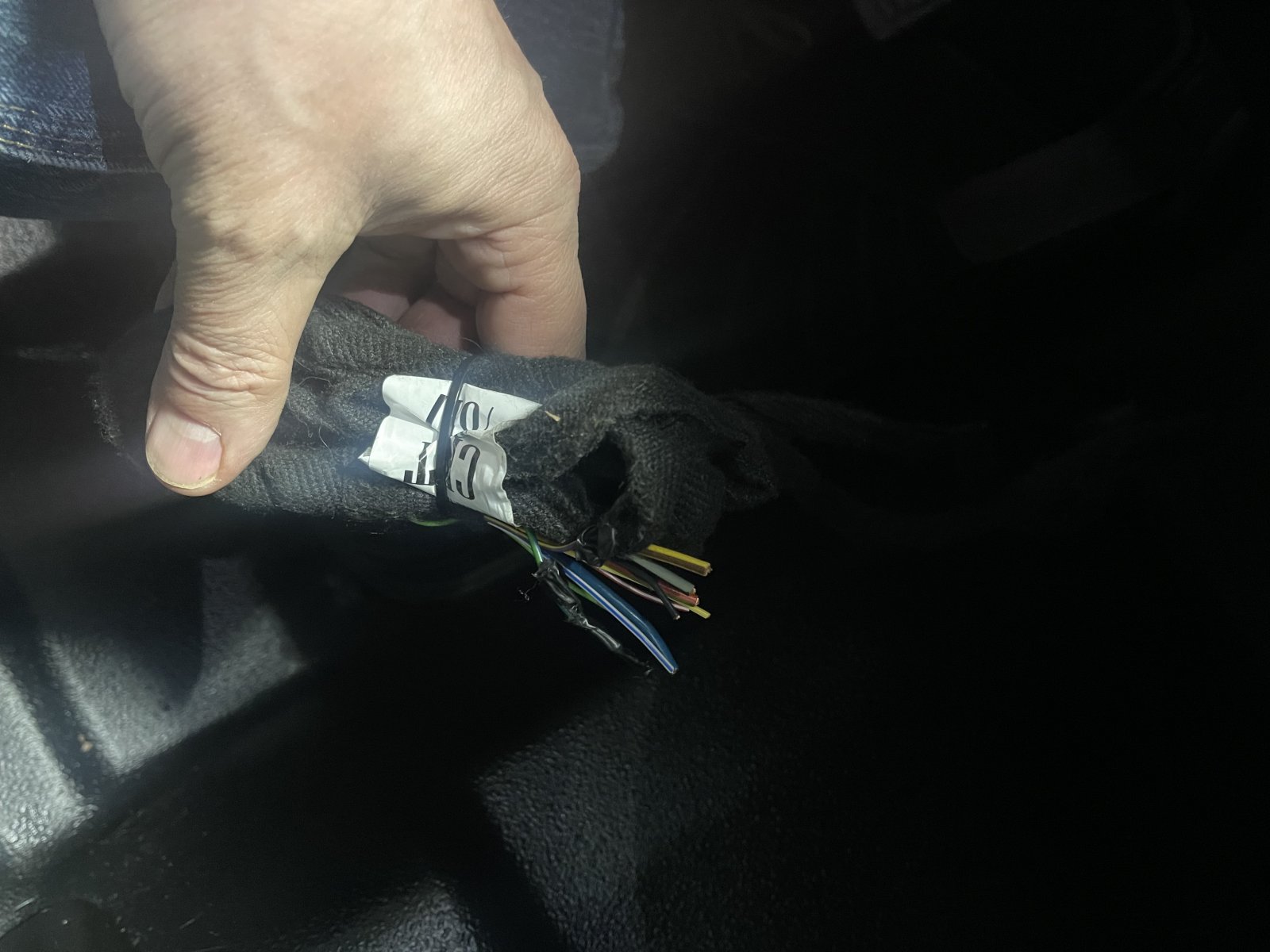

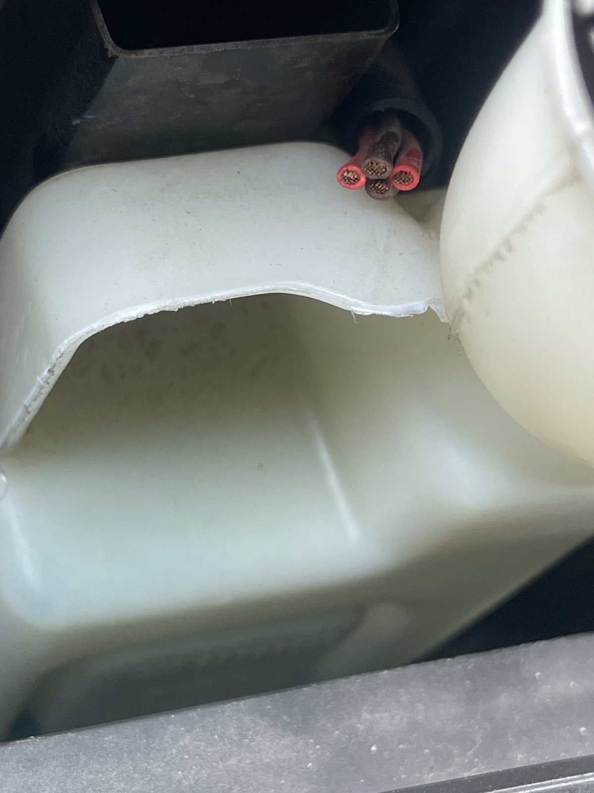

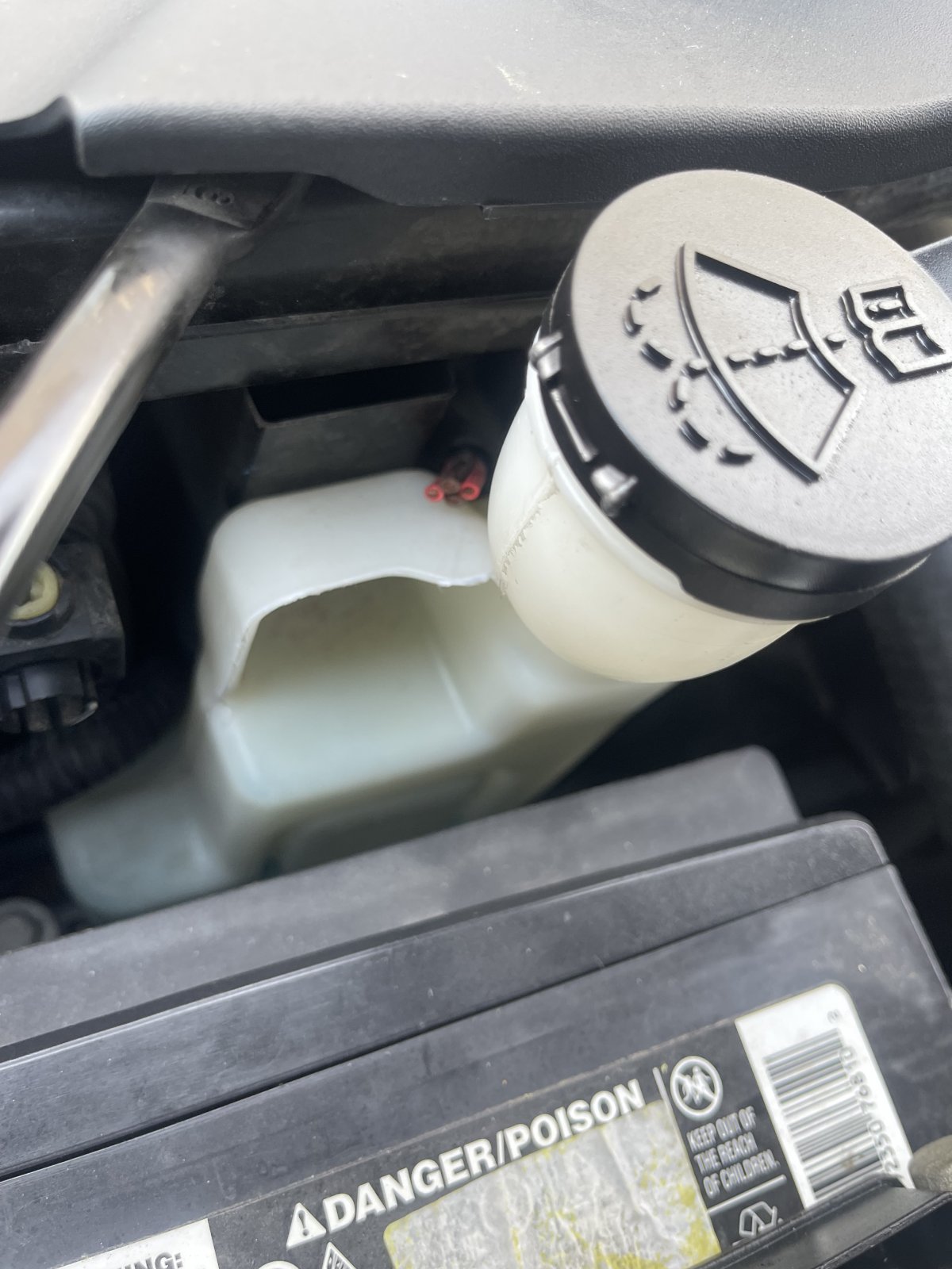

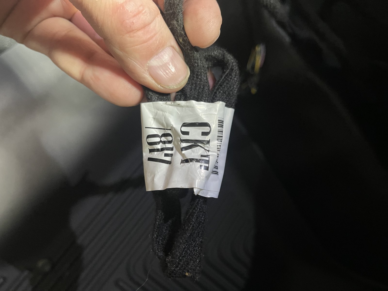

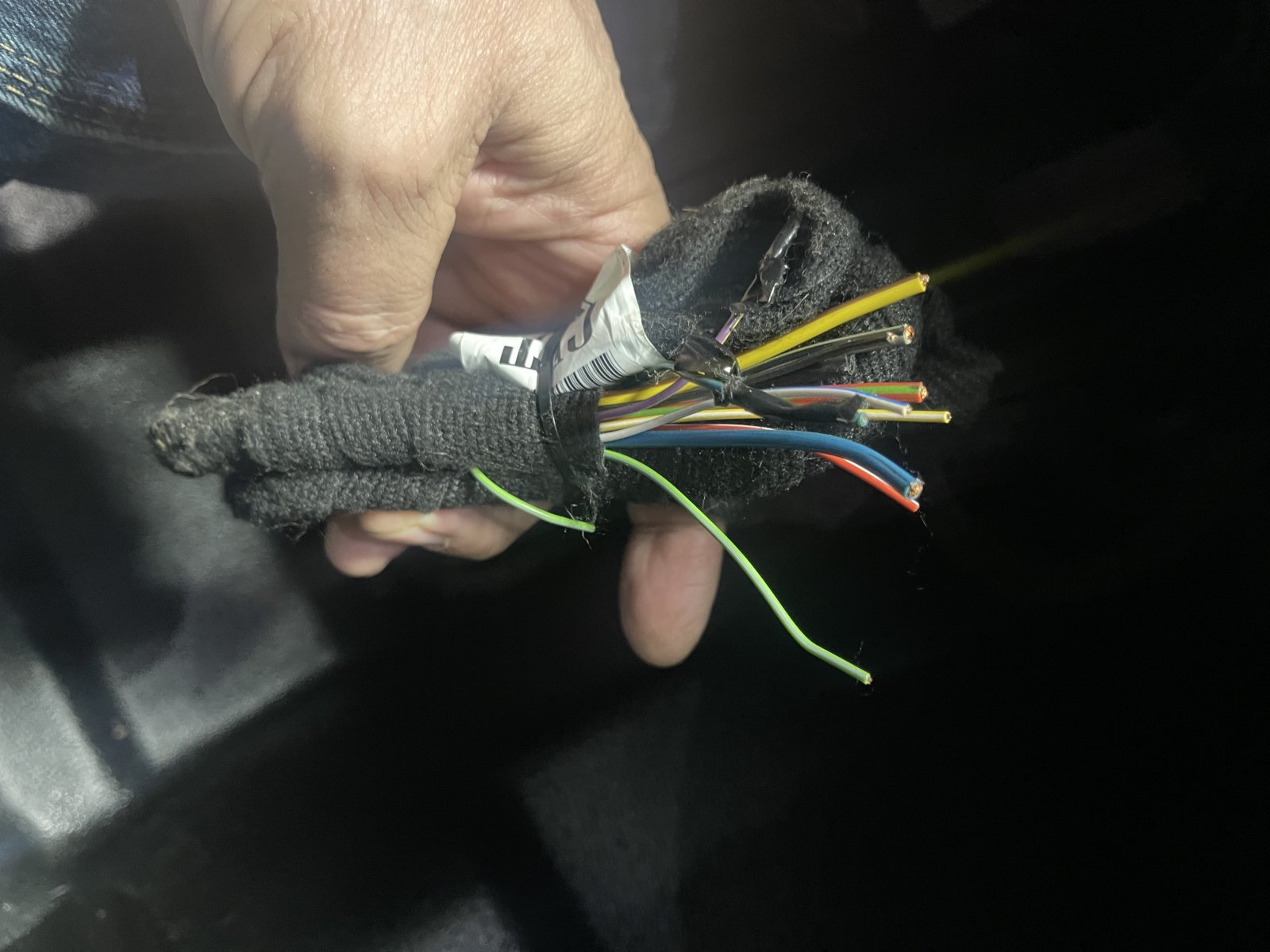

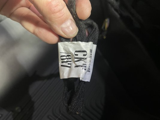

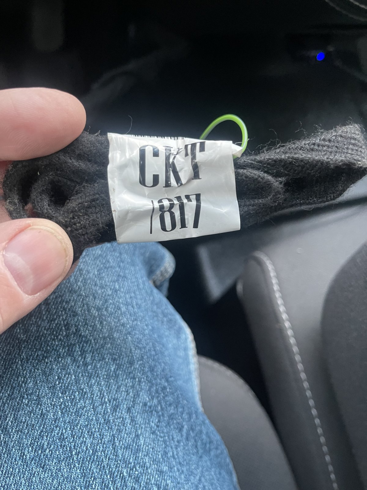

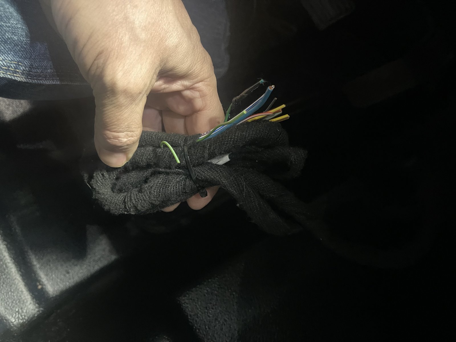

This is what I have , no brown wire in sight, not around gas pedal too
Just the reminder ; my hoe have no spot light , all lights and door locks windows works
What I’m missing here ❓
Moderator
16,323
33,752
People's Republic of Colorado
You're missing some context in the pics. Why not untie that bundle and see if there are numbers on the harness, and also show where it comes from.

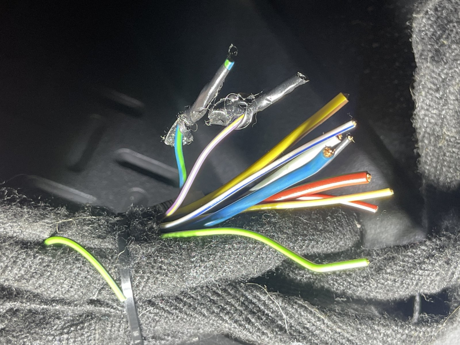

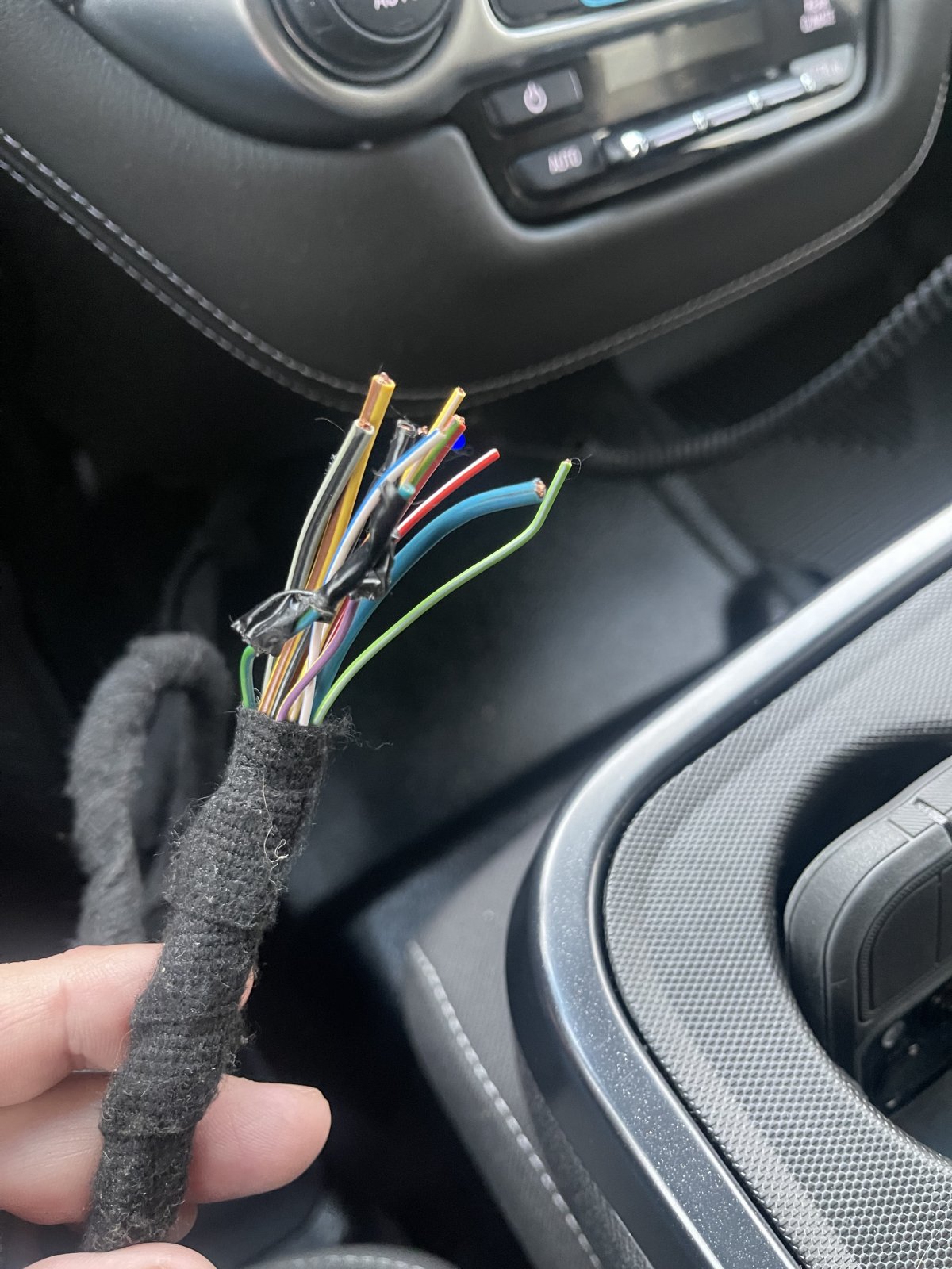

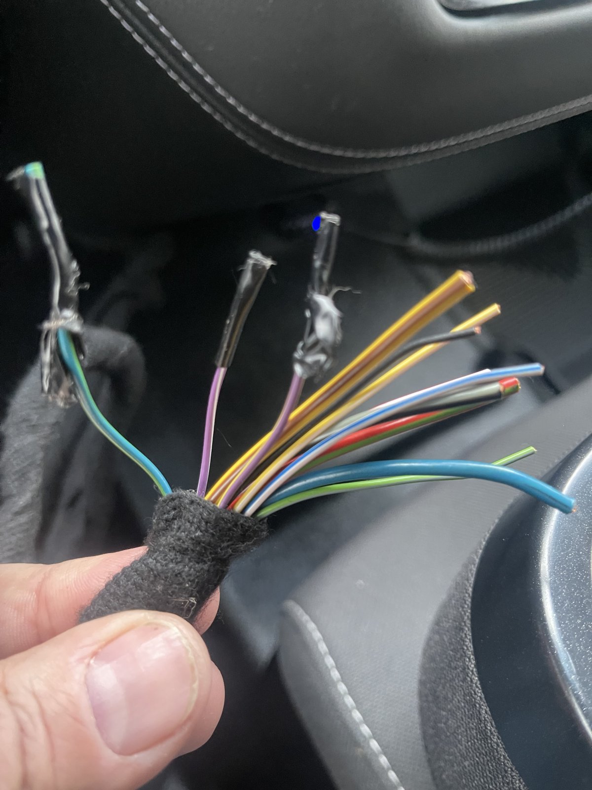

Maybe this help …..

i`m not kidding , need help with this horn !
when power apply to fuse 93 , horn is working , can not locate brown wire under the dash !,or is it different color
i checked every wire in cables under center dash , no signal from the horn switch :mad:

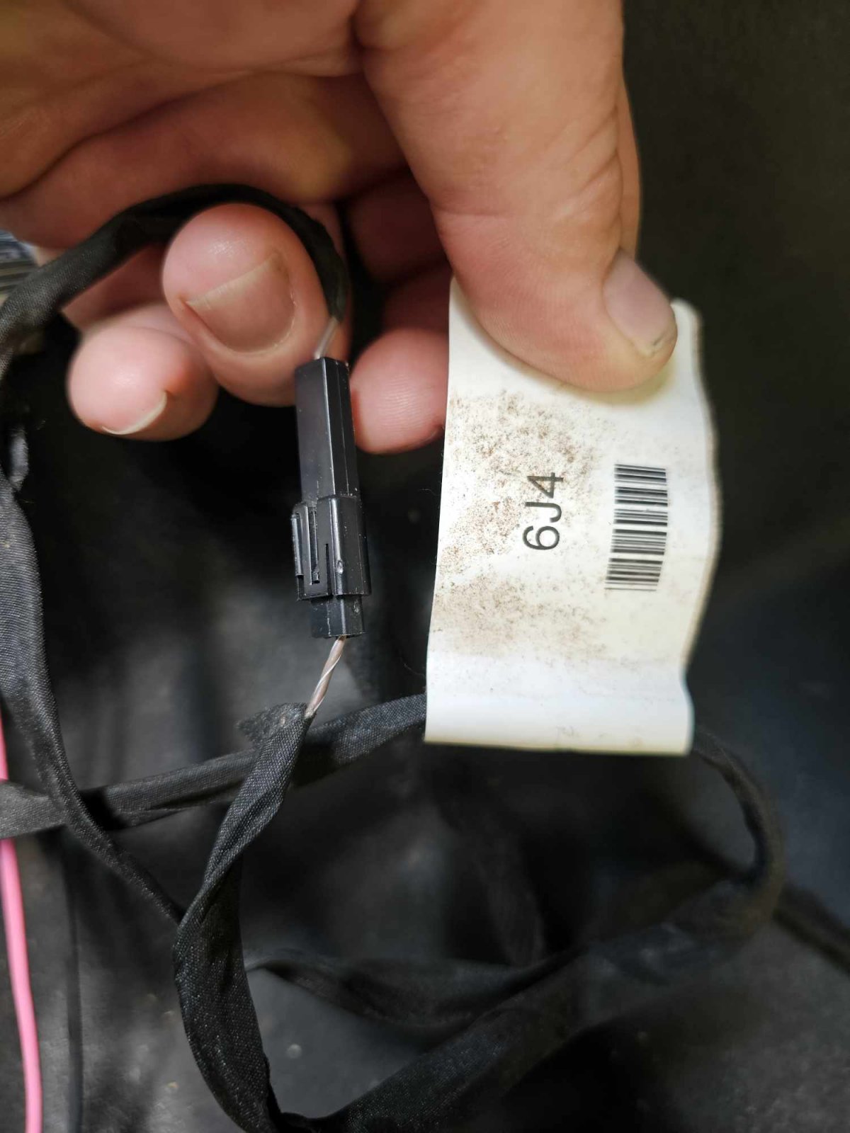

Lets figure this out! What wire bundles do you have under the dash? There should be several different ones. I think there is 6J3, 6J4, 6J7 and another one or two.

Ok you're missing a couple. Do you have a console in the vehicle? There could also be some looms coiled up and tucked under the dash right there above the trans tunnel or under the dash at the pass side and drivers side. I'll get some pics of the other bundles that I have

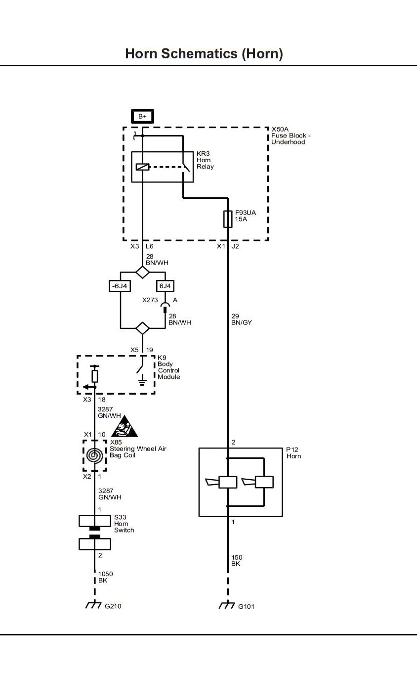

30,545
47,989
Check the green/white wire at bcm for continuity when the horn button is pressed
if that is good then trace brown/white wire from bcm to horn relay
if that is good then trace brown/grey wire from relay to horn
if that is good then check horn ground (black wire)

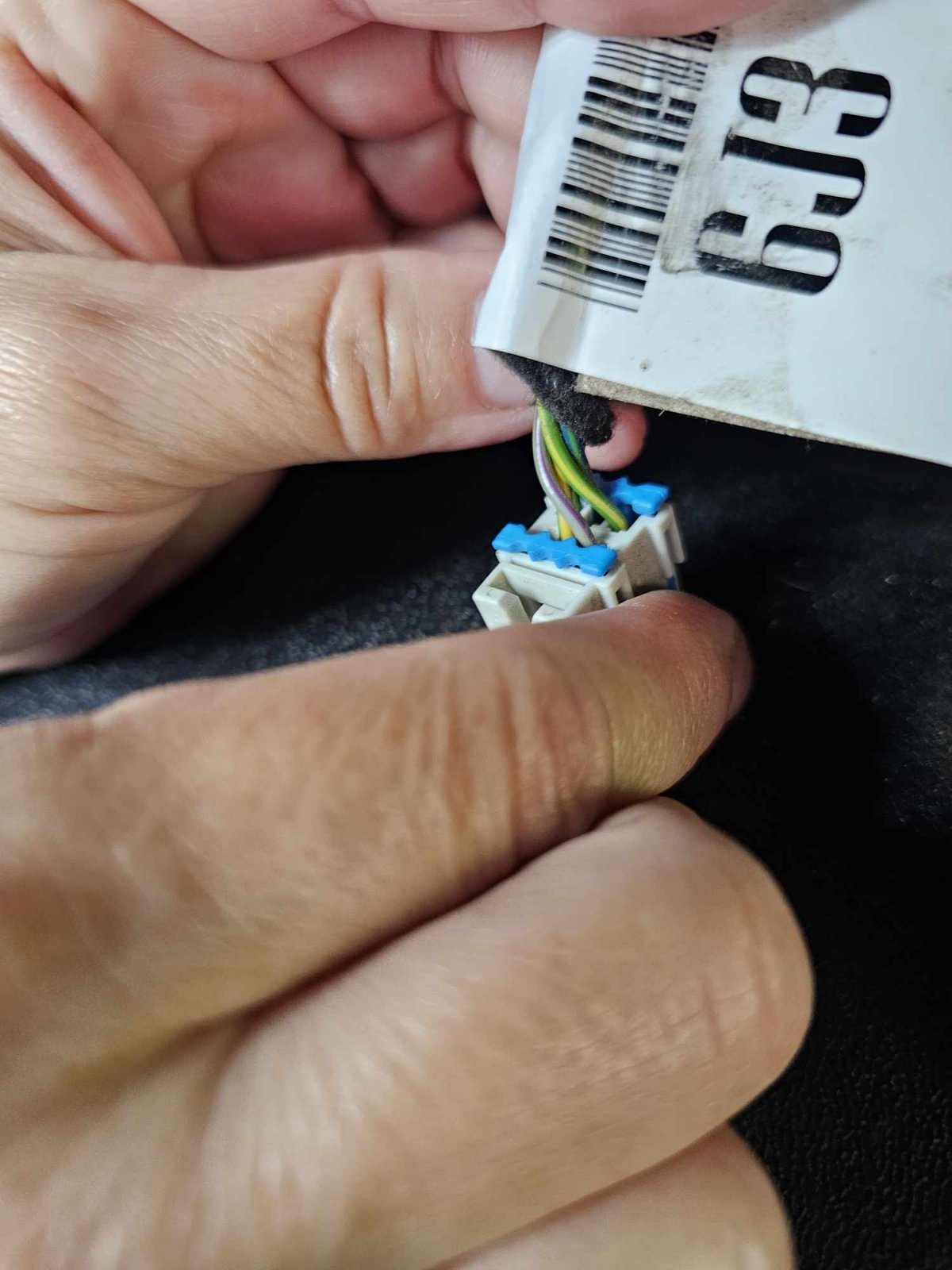

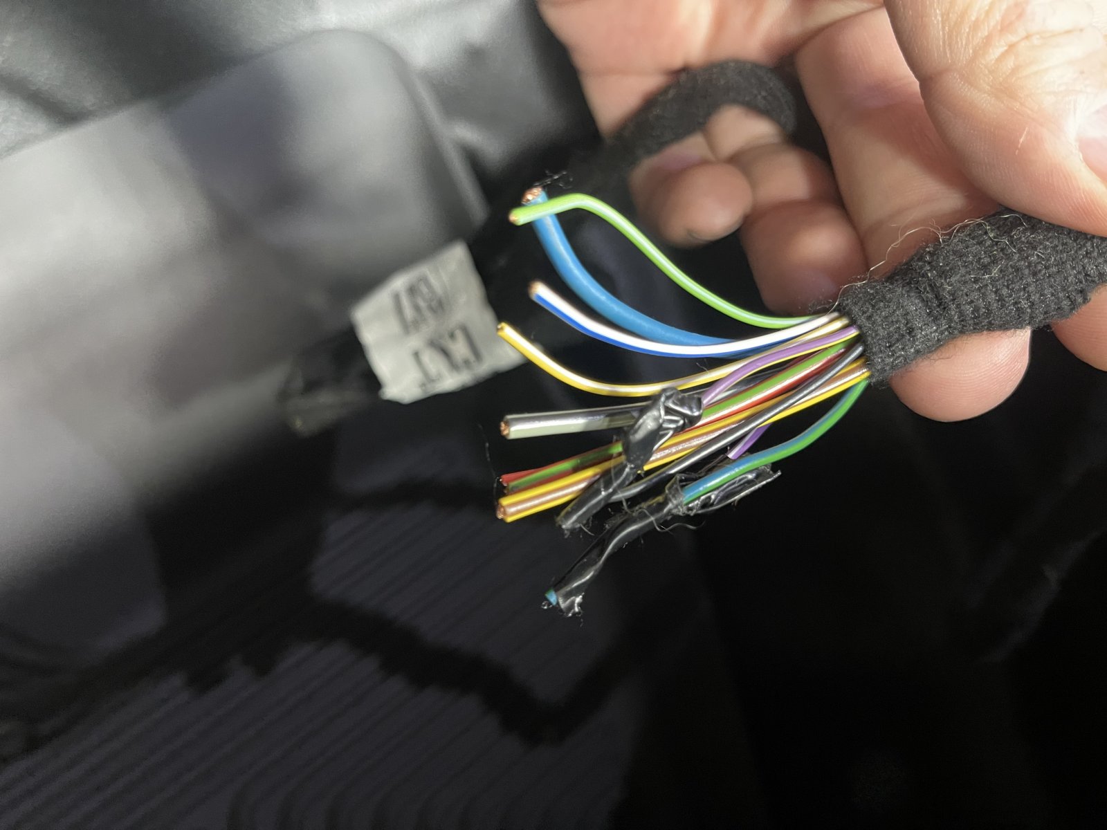

So in that pic of your cut wires, some of those wires belong to 6J3 as seen here:
Nutro
Jul 29, 2015
119
111
You need to find this wire/bundle which is brown with white tracer and a disconnect. This is your horn circuit.
Nutro
Jul 29, 2015
119
111

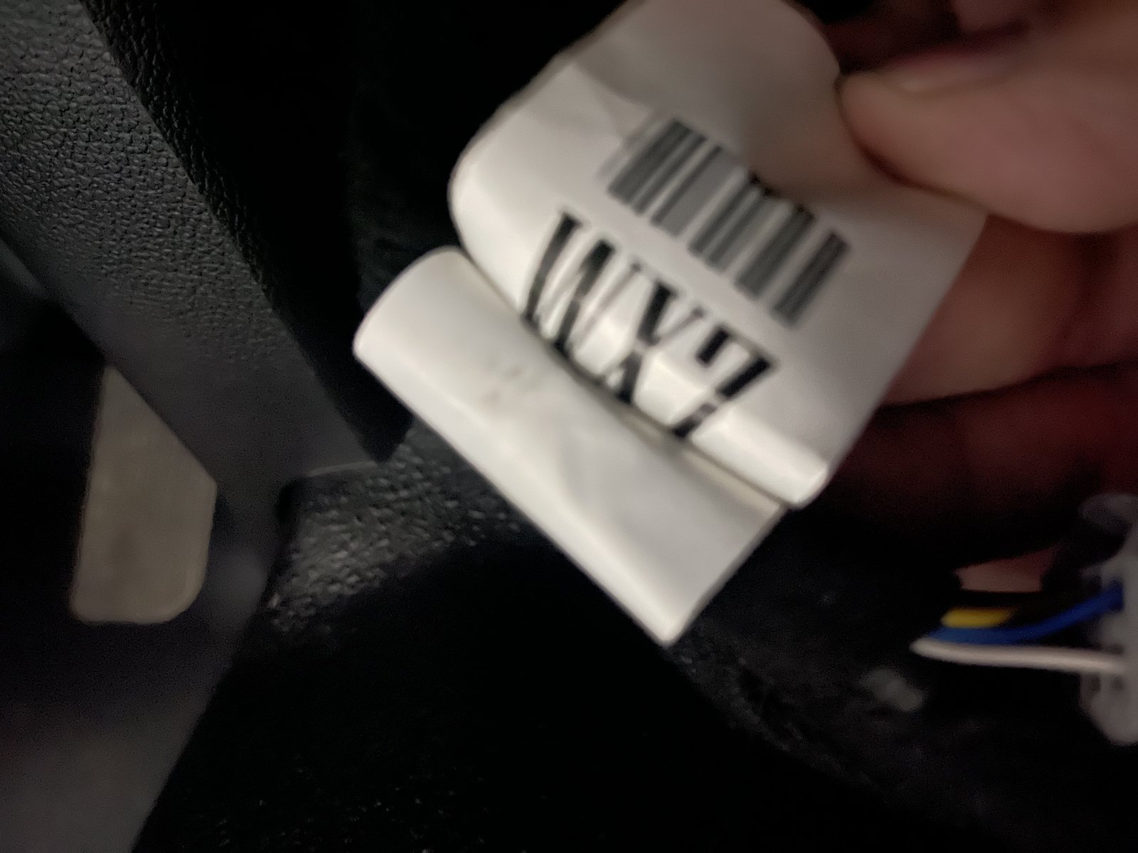

Does your WX7 have a terminal on it or is it cut? That pic you posted looks to be the 6J7 bundle but its only 5-6 wires and you bundle has a bunch of wires in it.
