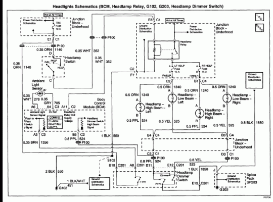

Wondering if someone can help fix this issue with my brothers 2001 tahoe. For a long time now his high beams stay on when the headlights are turned one. Pulling the multi switch to high beams does turn off low beams but when you switch back to lows the highs remain on. I've checked the headlamp relay and 2 fuses headlamp fuses under the hood. He's replaced the headlamp dimmer switch and multi purpose switch. Even with the bcm disconnected the high stay on. This is the only diagram i can find. Any help is appreciated

A Tech2 or similar would help you.
Check C1 and C4 Back to headlight relay, look at all relay pins w meter for voltage/ground.
Check light sensor , Scan BCM.

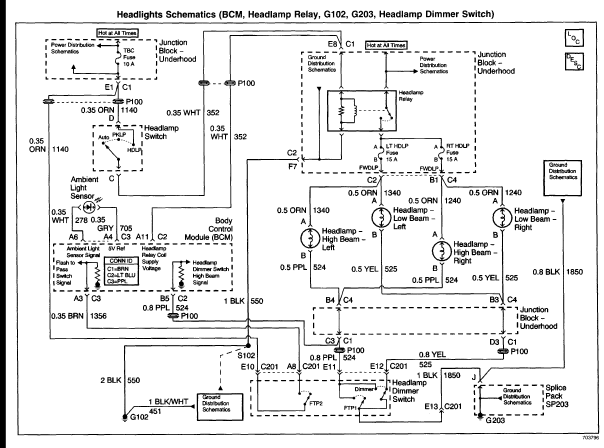

I don't have a tech 2. Forgot to mention relay is new. I would like to check b4 and c4 and c3, c1 but i don't know what or where those are.

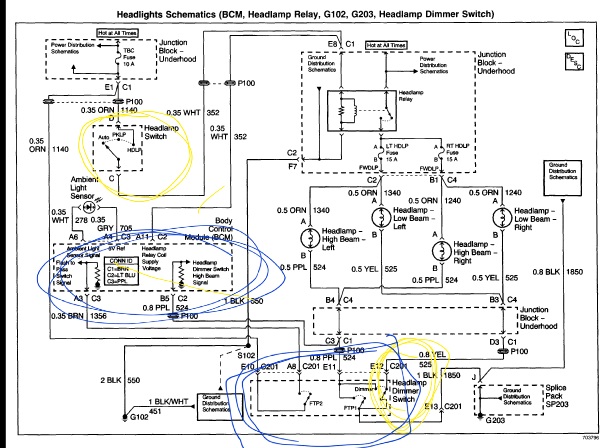

Im not very good at reading these diagrams but i can get by enough. Most issues i have is i dont know what and where certain locations are ex. C4,b1 etc.
Is the headlamp switch and headlamp dimmer switch the same device (yellow)? Since both the highbeam signal and flash to pass from the bcm go to this dimmer switch I'll like to test that device (blue)
