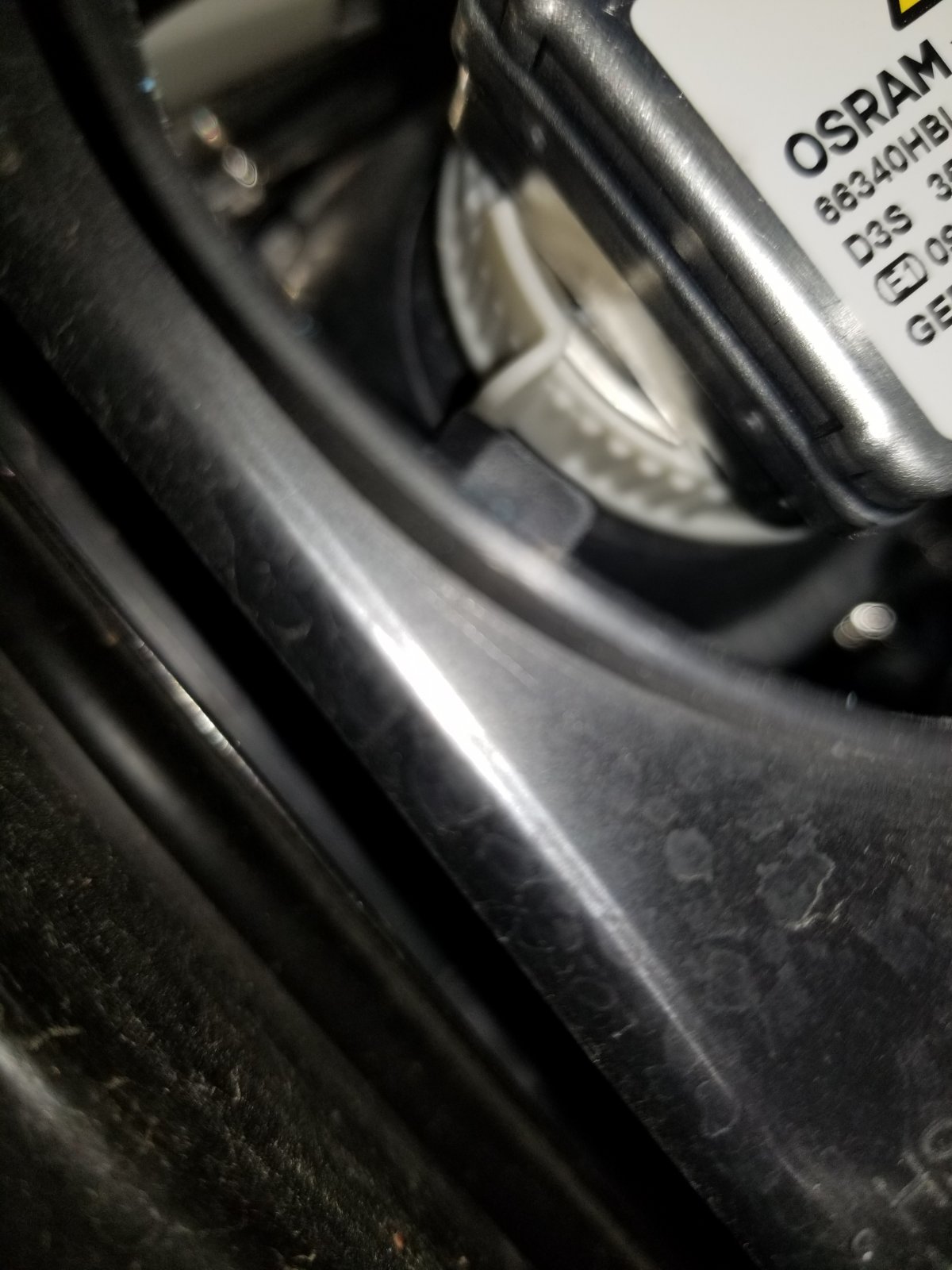

Sorry but, this is the white tab correct?

Yes. That whole white ring twists loose in order to allow the bulb to be removed.

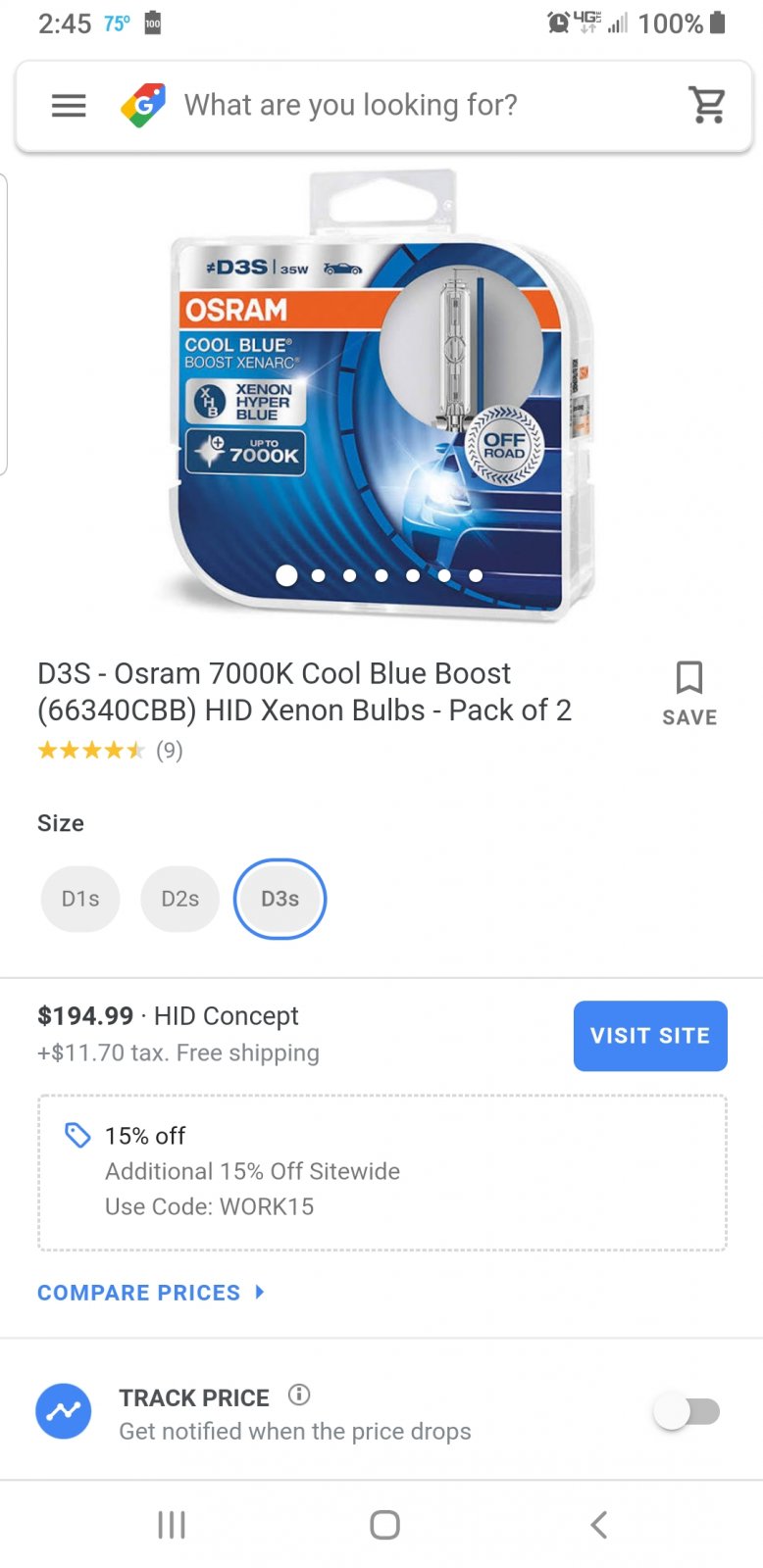

I was just going by the description - "7000K cool blue". I've had good experience with both Osram and Philips but I always saw a hint of blue at 5000 and above.

All the videos and reviews of the OSRAM CBB are closer to 5500-6000K max. The type of projector can affect light output, intensity, and cut-off as well.
I have a feeling the OEM projectors in our GM SUV’s aren’t considered “top performers” in the HID projector game.
