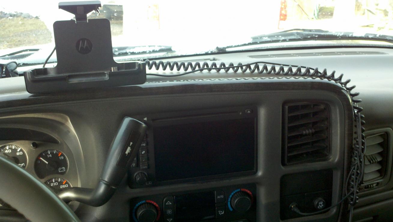

I have a Bose system, but due to the previous owner not including the owner's manuals, I know nothing about it.
Here's a pic of the radio...
I'd like to know as much as possible about it. I'd like to add and AUX input, and perhaps a USB input for a thumb drive. Is it possible, or do i need to replace the radio? I'd like to keep the looks stock, as they don't get stolen like aftermarket ones do.

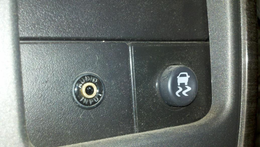

I had a casette adapter in the 01 Suburban I used to have and it actually worked pretty good. I got it at Wal-mart for about $10. If you have XM you could get an Ipod adapter that plugs into the xm unit behind the glovebox. I have one in my 05 Denali. You can hook up an Ipod and control it with the stereo or use the Aux input. I got mine here:
http://www.ipodcarpros.com/ I have had it about 1.5 years and love it. I have my Ipod hooked up in the glovebox and put an Aux input in the dash so I can hook up anything else.

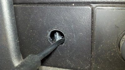

Just took a pic of the Aux input I put in the dash. It was pretty easy to put in.

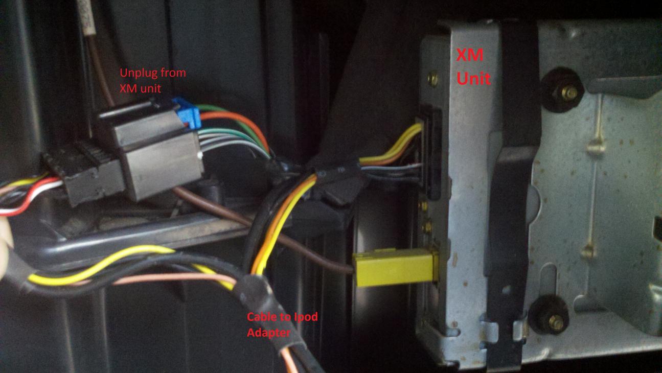

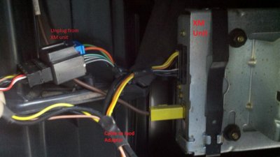

First you will need to open the glove box all the way. There is a tab on the right side that holds it up. Just pull the side in a bit and that tab will clear the dash. Unplug the connector from the XM unit. There is a lock holding the connector in. I think it is the blue piece. Just take a screwdriver and slide it up.Next plug in the connectors from the Ipod adapter.
I put my cable for the Aux input next to the traction control switch on the dash. If you are not sure what size hole to drill, drill it a little small first. There is a plastic stiffener behind the panel, so be careful. The drill bit will grab that. Feed the cable through the hole and push the input into the dash.

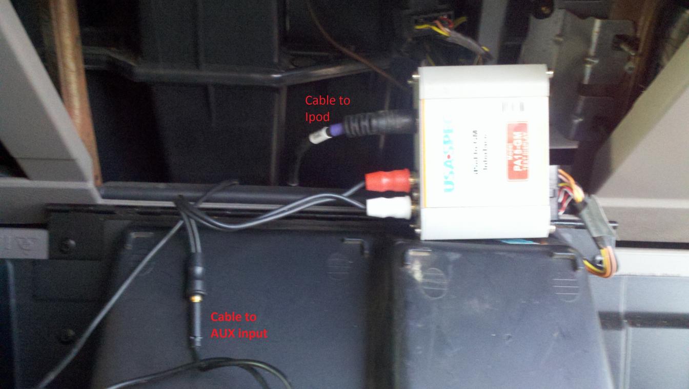

Next connect the Aux input and the Ipod input to the adapter.

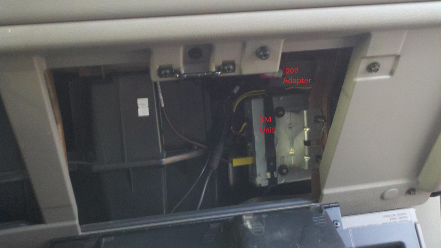

After everything is hooked up, neatly shove the Ipod adapter into the space above the XM unit and tuck all the cables out of the way. I keep my Ipod in the little compartment on the left side of the glove box.
The final result. The mount on the dash if for my Droid x. I use it for navigation (the factory one sucks) and with it hooked up to the stereo I can use it as a hands free phone.
I hope this helps you.
