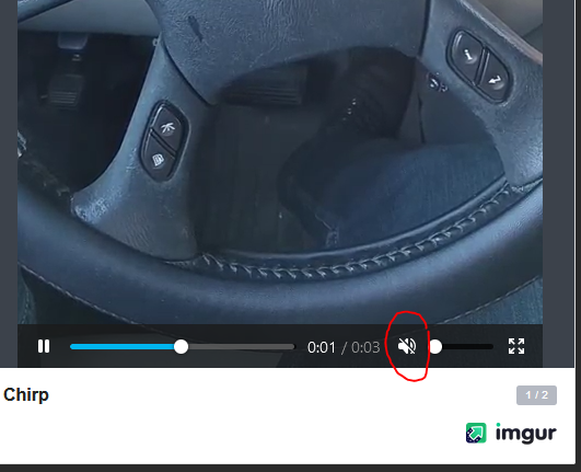

Thanks..... ( usually, raising volume , un mutes ).... I barely hear the 'chirp'. Not really enough to diagnose.....
As tom3 recommended doing lowering the heat settings, I dropped it down to 80° on both sides and I'm still getting the noise. Since you're saying you're having trouble hearing the noise I took some more video this morning while I was driving to capture the audio. As you can see in the video for some reason it likes to occur when I take my foot off the brake, maybe like seven out of 10 times it'll do this. The one video is me turning the car off and taking the key out of the ignition That's when it gets really weird with the noise it makes. But as I also mentioned I could be sitting there doing absolutely nothing and the noise is there with no discernible timing between the noise.
30,756
48,446

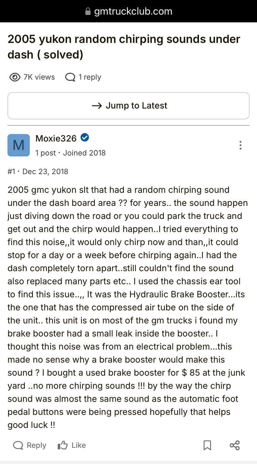

When I pulled the car over to first pull the fuse out and I stepped outside to pull the panel off of the side I can actually hear the noise through the firewall
This may be something to look at…
