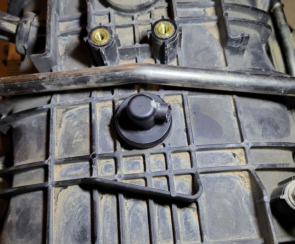

HELP!!! Part Number for 2007 Yukon Denali 6.2 Intake PCV elbow????
MLRTYME
Apr 1, 2019
47
132
Help all! I had a small mishap with the recently built engine and needed to tear things apart again. I tried to remove the hose to my catch can from the PCV elbow on the top of the intake. Sure enough, the sucker broke trying to remove the tubing. Does anyone have that PN handy so I can try to get another? From what I can tell, if you get a new intake, that part does not come with it. But after searching this forum for PCV anything, and trying both RockAuto and GM Parts Direct, I'm stuck without knowing the correct nomenclature for that part.
Hoping anyone can help with the part number...or I'm stuck trying to JB-weld mine back together.

Pic for reference:
Also, extra points for anyone that can tell me how to remove the darn thing!!!! Does it twist out? Pull out? Again, with no part number, I'm left Google-less. :bawl:

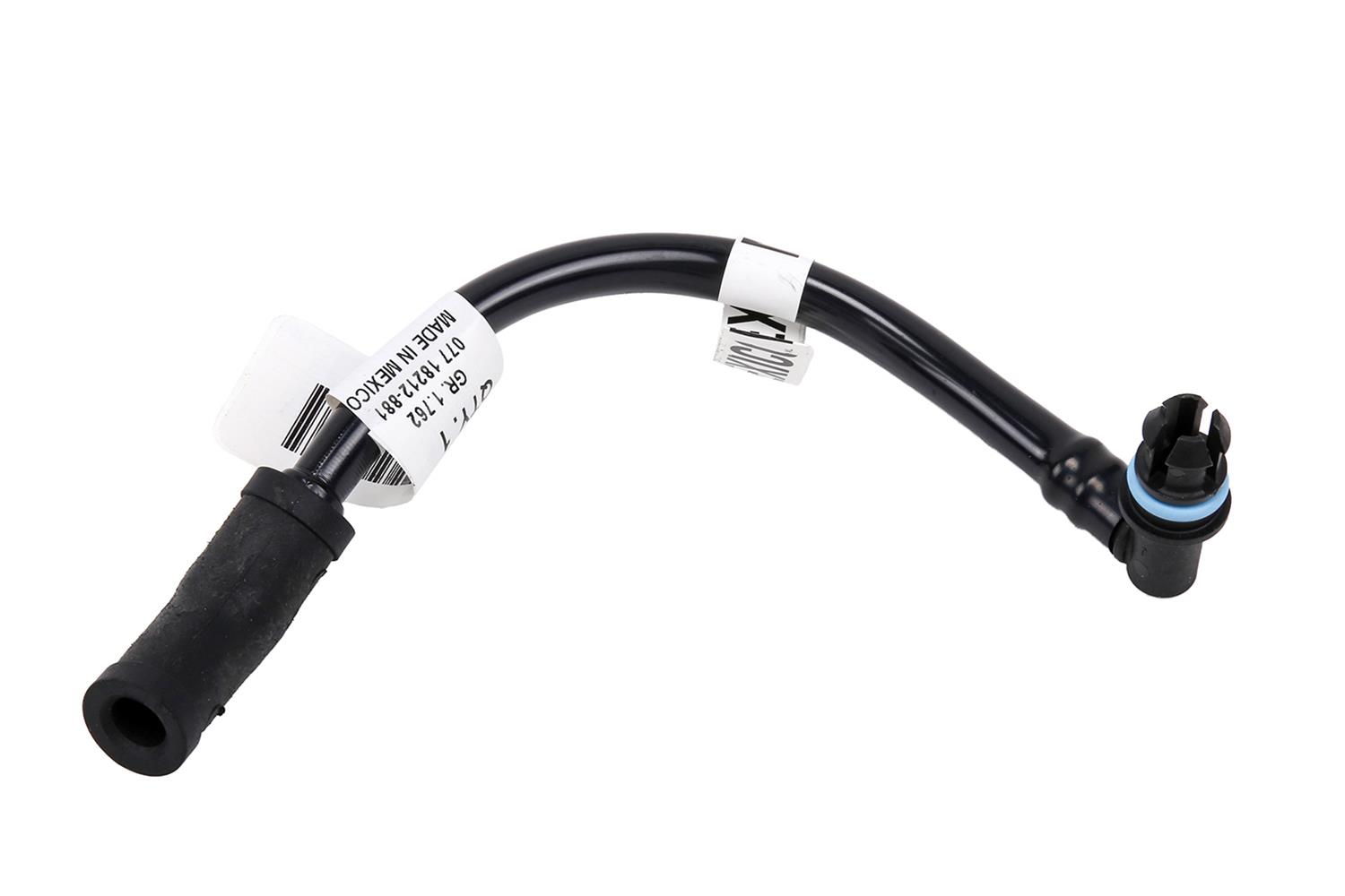

12597774 - Dirty Air PCV Valve Tube (description at GMPartsDirect for our 2012 6.2)
Give the last 8 of your VIN to Rene @915_Tahoe to verify.
It is friction fit, pulls straight up and out.

This pic at RA looks like it just shoves down in there and the dealer is trying to rip you off. Looks like it is shoved down in to the black grommet and the new part has an orange colored seal on the tube that probably seats at the grommet.

Awesome. I had called the local GMC and they said it's part of the intake...and that the intake would be $320! Ughh! Crazy!
I had just watched a video this morning of a guy installing that on his intake and then putting the intake back on the truck. It is part of the intake but you don't have to buy the whole thing to get it.

Looking at that video, he is putting on a cathedral-port intake. I will need the rectangle-port intake for my application. With more time available today, I tried to 'pull' the item with a pair of ChannelLock pliers...and it did NOT budge...like...at all. I fear that the dealership is correct that for this particular application, the unit is indeed part of the intake. I will be modifying an outlet of a plastic T fitting to fit just inside of what's left of the existing piece, and epoxy them together. I can't risk breaking the manifold as this needs to be running by Monday and GM said I'd be about a week out on that if they ordered it.
Just trying to help others avoid this. If you have a 2007-ish Denali (6.2) and you need to remove the intake, just cut the hose off. Don't bother trying to risk breaking it. Lesson learned! :)

The part number I provided is for a rectangular port intake and got it from GMPartsDirect and the application is for our 2012 6.2 L9H. You are correct in that GMPD does not show it separate for your 2007 6.2 and it does not show it separate for my 2009 5.3 or that guy's 2008 Suburban in the video as well. The PN# for your 6.2 intake and my 2012s is also different.
I'm going to message that guy and ask for the PN that he is using for those who come along later.

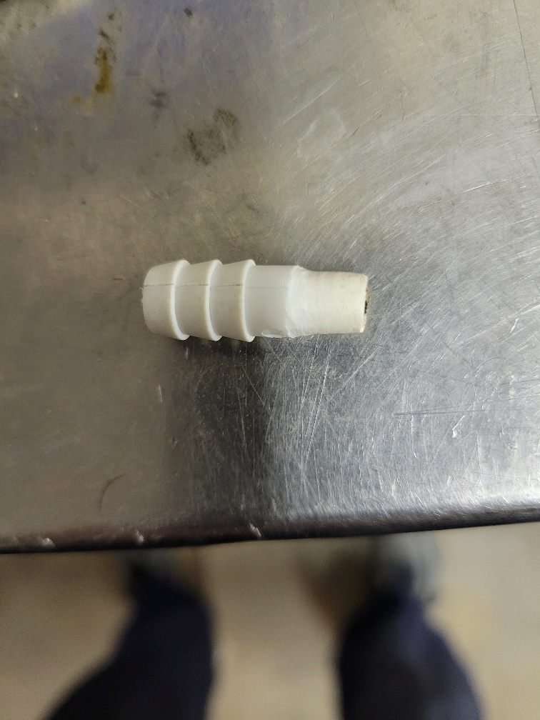

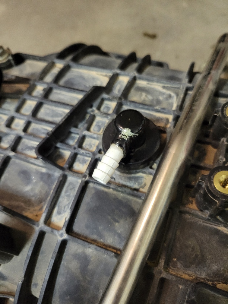

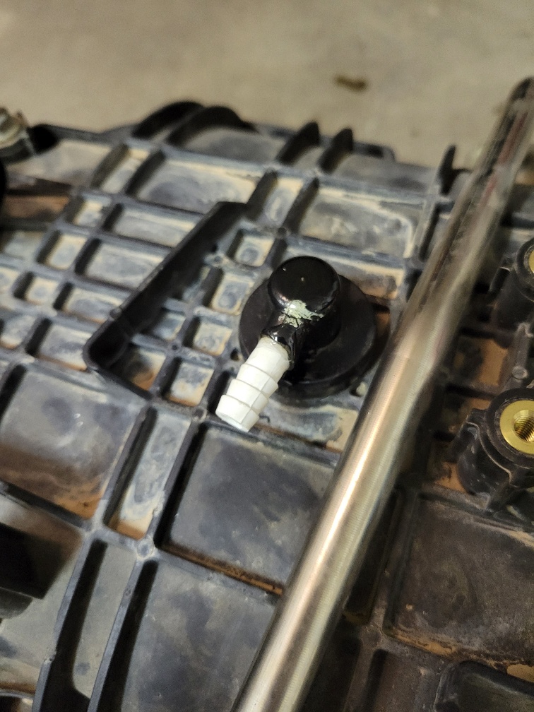

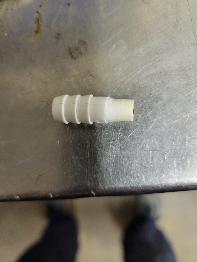

So, I did this:
Took a vacuum hose connector and cut it in half. Took one side and 'trimmed' down the size of the tubing with a dremel and sanding wheel. Then opened up the ID of the broken PCV connector just enough to let it slide in. Some JB Weld Plastic Epoxy to sit overnight...and I'll sand it down slightly tomorrow to help make it smooth for any hose to go over. Then install tomorrow. Fingers crossed!

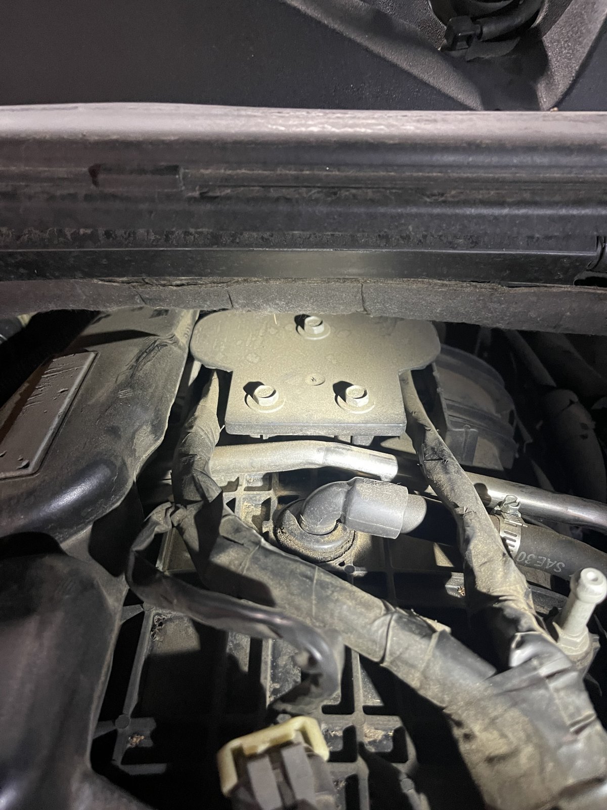

Nick wrote back, the guy doing the rebuild of the 'Burb on YouTube. He said that line is 12607406 and looks like this:
It is not the "dirty" line, it's the "clean" line. Now I can see why you couldn't pull that puppy out of there with those barbs!

Followup to my initial post: The JB Weld is holding well...and the truck is up and running. I am getting an Check Engine light, but it seems to be running well. Considering I had a sub-standard head gasket let go...and the amount work I had to do in order to get it sorted, I might need to do a camshaft relearn or something. No biggie...just pull out the Tech II and get to work. Read some codes...do some troubleshooting.
In the mean time, the 'fix' on the intake is holding, for any guys needing to do something like this on your rides. I'll take any wins I can get at this stage! :)
