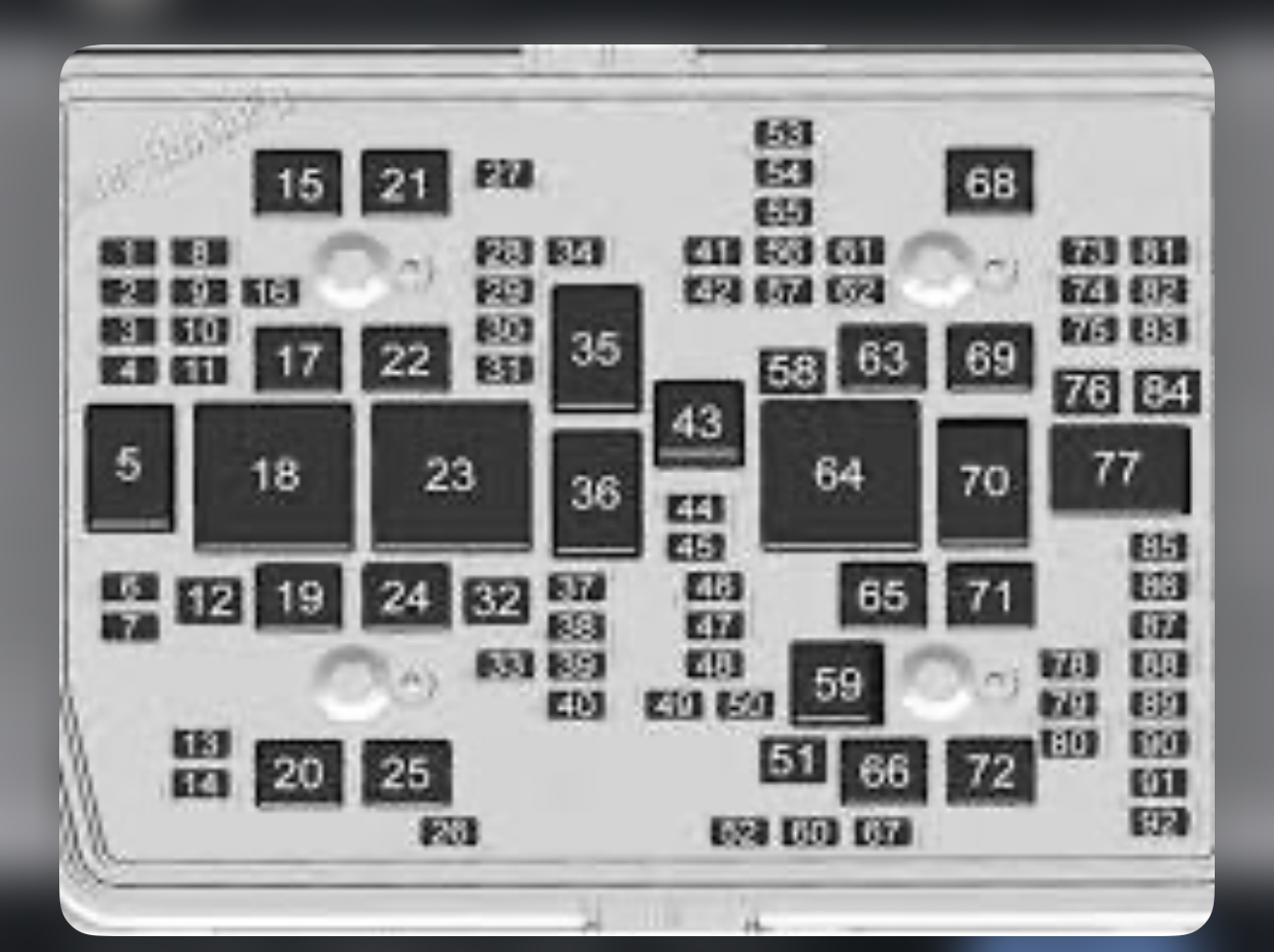

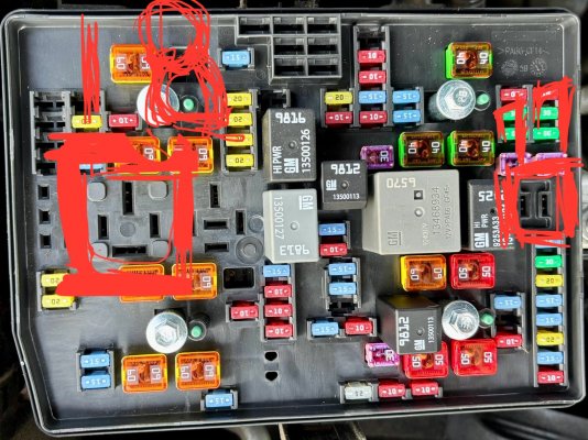

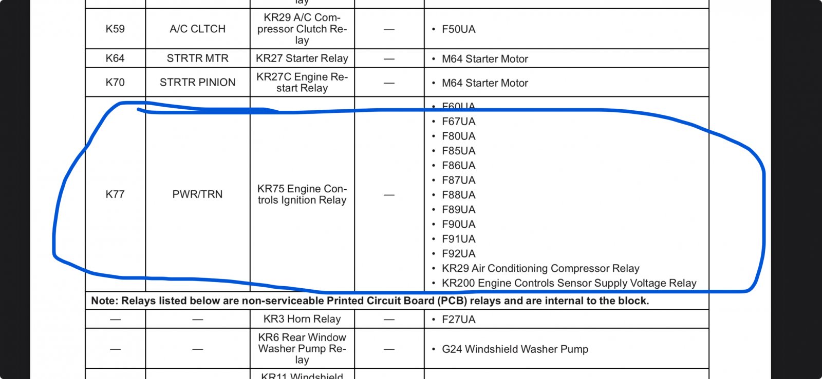

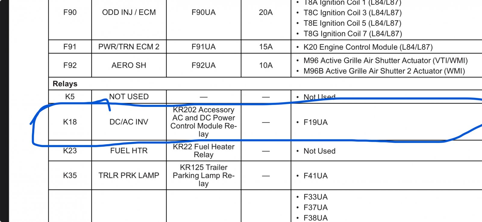

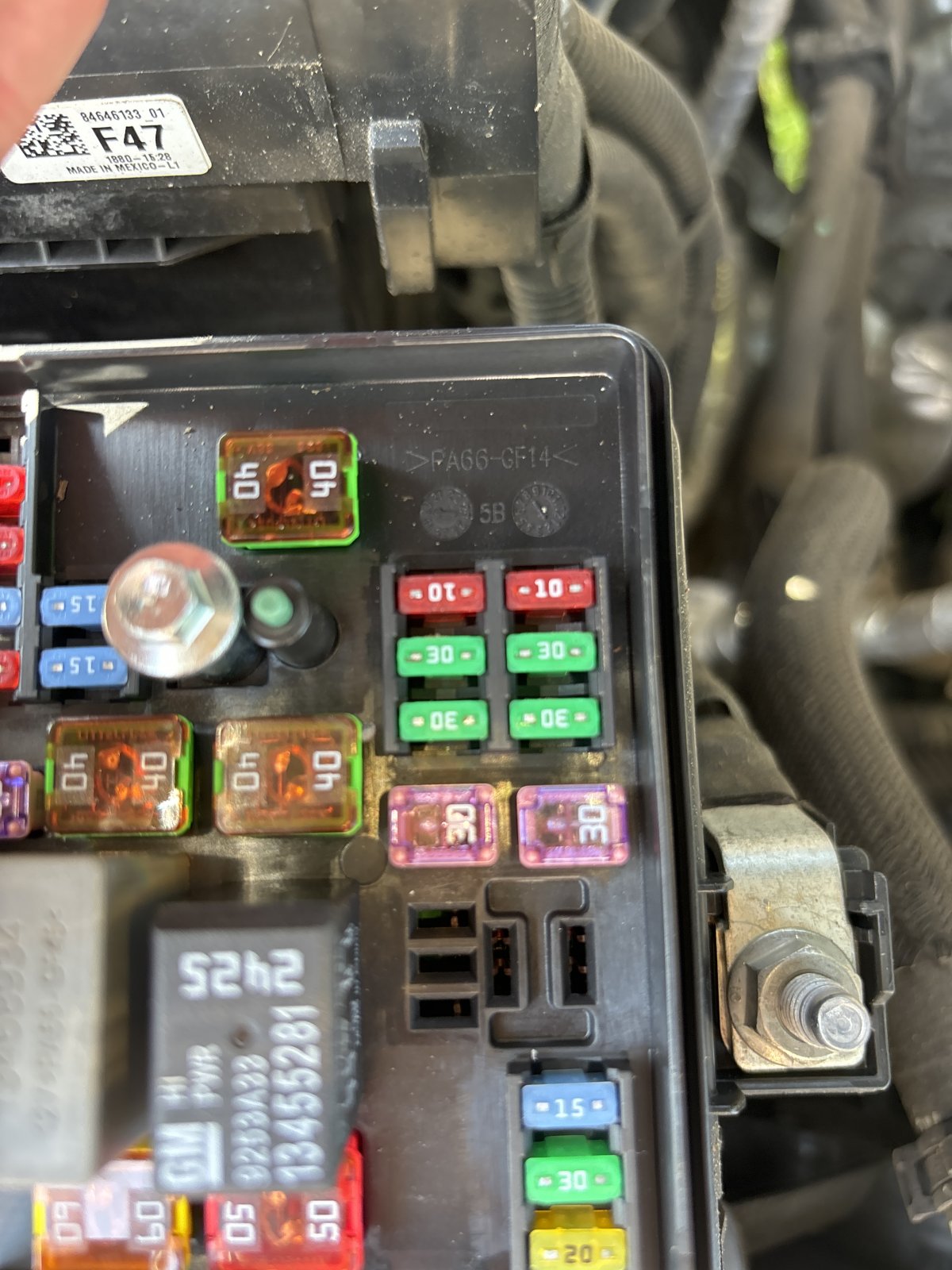

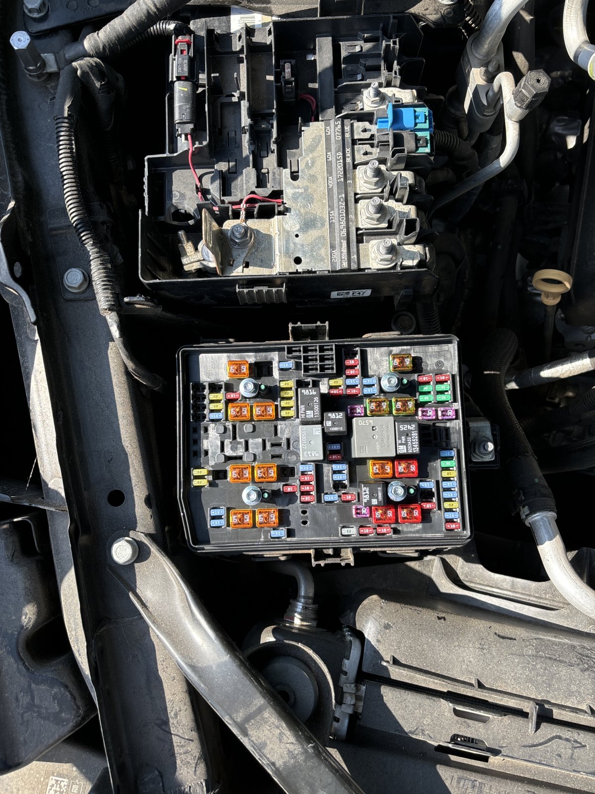

I need help in a very bad way. I removed two relay fuses from my engine fuse compartment during a domestic dispute ( ex bf took my key fob and was trying to steal my car) and those fuses were lost. I cannot go anywhere. I have a 21 GMC Yukon Denali, the relay numbers in the box were number 18 and number 77. I need to find part numbers so that I can order new ones and I’m having a hard time finding them. I am pretty sure that I found fuse relay number 18, and I believe that part number is 13500113. But whenever I search for the fuse relay number 77 It’s like the part number doesn’t even exist. It is described as a KR75 Engine Controls Ignition Relay. I have attached a photo of the fuse box and outlined the missing relays, the diagram of the fuse box and what I have found as far as what the description of the fuses do. Any help as soon as possible would be greatly appreciated. Thank you.

number 18 is relay # 84095364 and might be available at most auto parts stores
location # 77 is relay # 13422668 (high pwr) was a little harder to find because you have part of the slot covered in red marking, that one you may have to order or get from the dealer

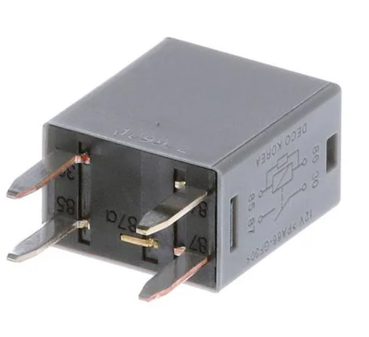

Is this the one you are looking for slot 77 part number 13500114

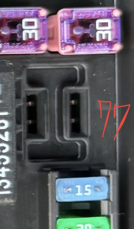

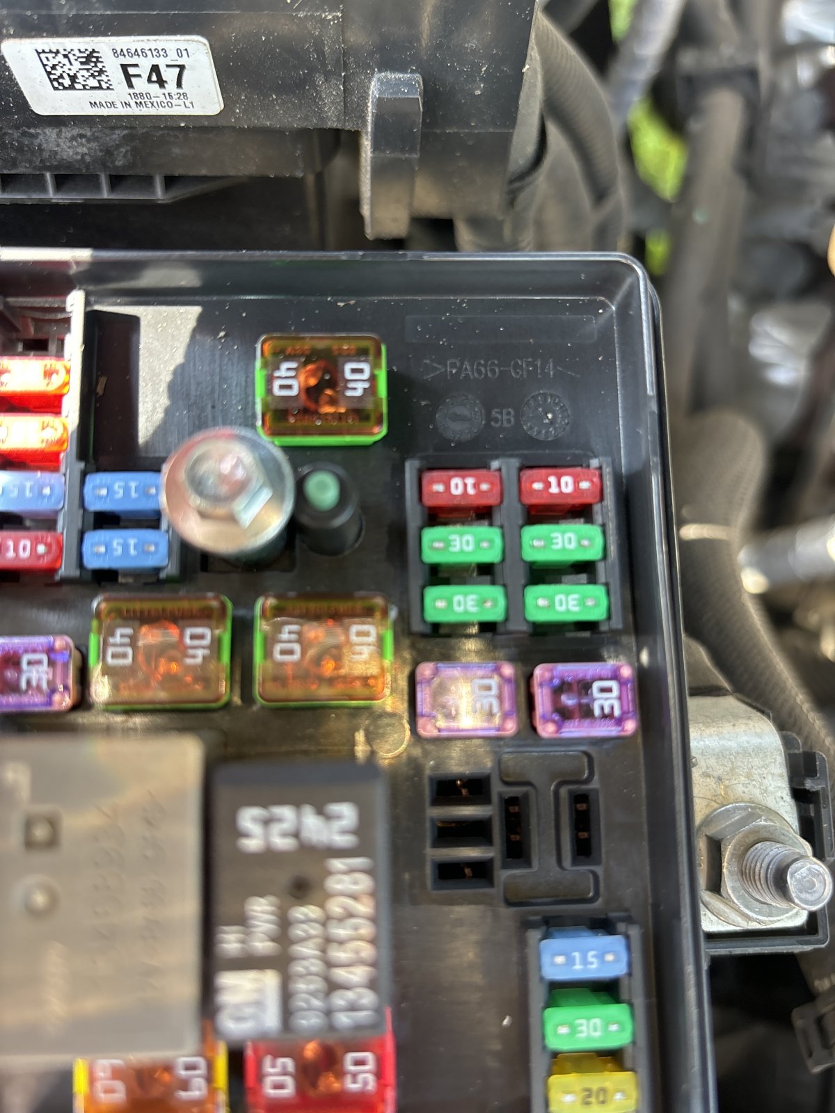

It doesn’t look like the right prong slots, but maybe. Here is a better picture of number 77’s location.

Yes, sorry, I just went out and checked my 22 Yukon SLT which should be the same. My #18 is 84095364 and #77 is 13422668

where in the heck does the 3rd/4th leg go on the 13422668? got a pick of it pulled out and next to the slot?
I looked at 10 different fuse boxes all the same but none with the slot open, hers only shows 2 leg slots

Is this the 6.2L gas or the diesel engine? Also if you have a mirror see if there's a label with a part number on the fusebox itself. Would be handy to see the VIN also.
Gas 6.2. No label

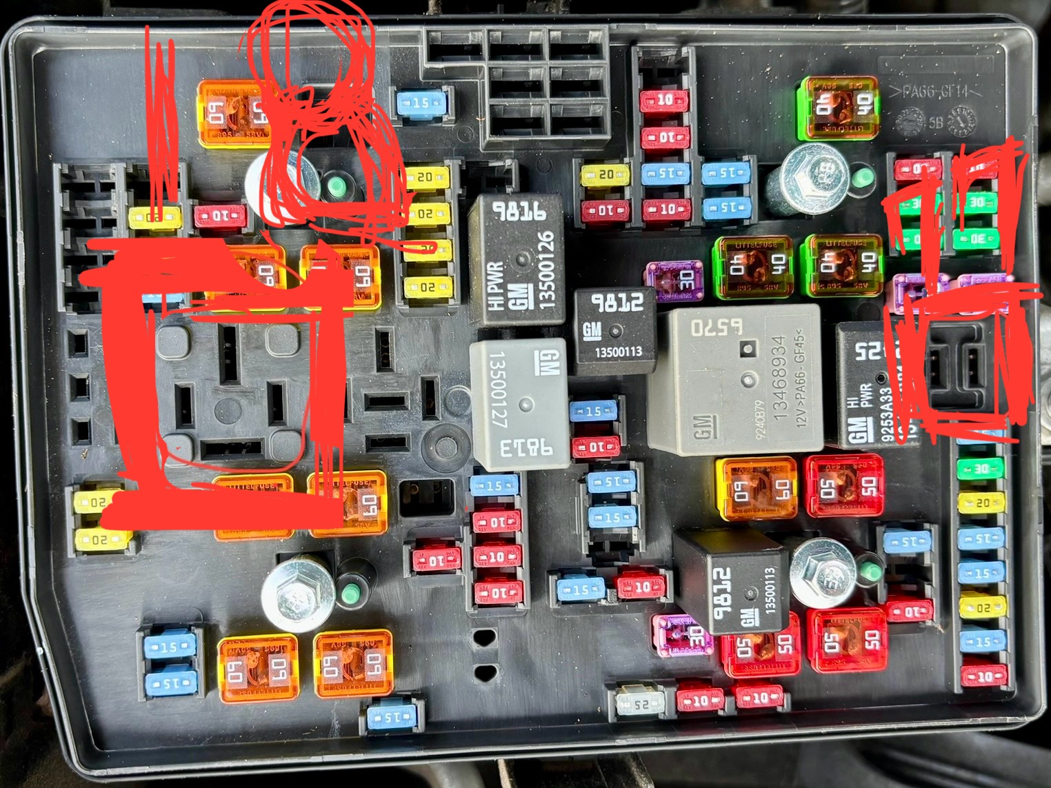

Starting to think, since I was in a hurry when I was pulling them out, but what if number 77 is this whole spot right here…(see pic)

weird, same fuse box shows a different relay with more legs
Got to thinking since I was in a hurry when I pulled them what if it is this whole area right here that is the one relay
