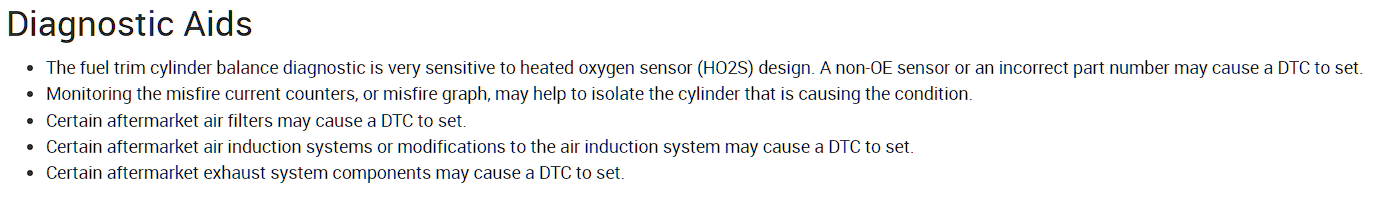

This from www.charm.li for an earlier model year:
* The fuel trim cylinder balance diagnostic is very sensitive to heated oxygen sensor (HO2S) design. A non-OE sensor or an incorrect part number may cause a DTC to set.
* Monitoring the misfire current counters, or misfire graph, may help to isolate the cylinder that is causing the condition.
* Certain aftermarket air filters may cause a DTC to set.
* Certain aftermarket air induction systems or modifications to the air induction system may cause a DTC to set.
* Certain aftermarket exhaust system components may cause a DTC to set.

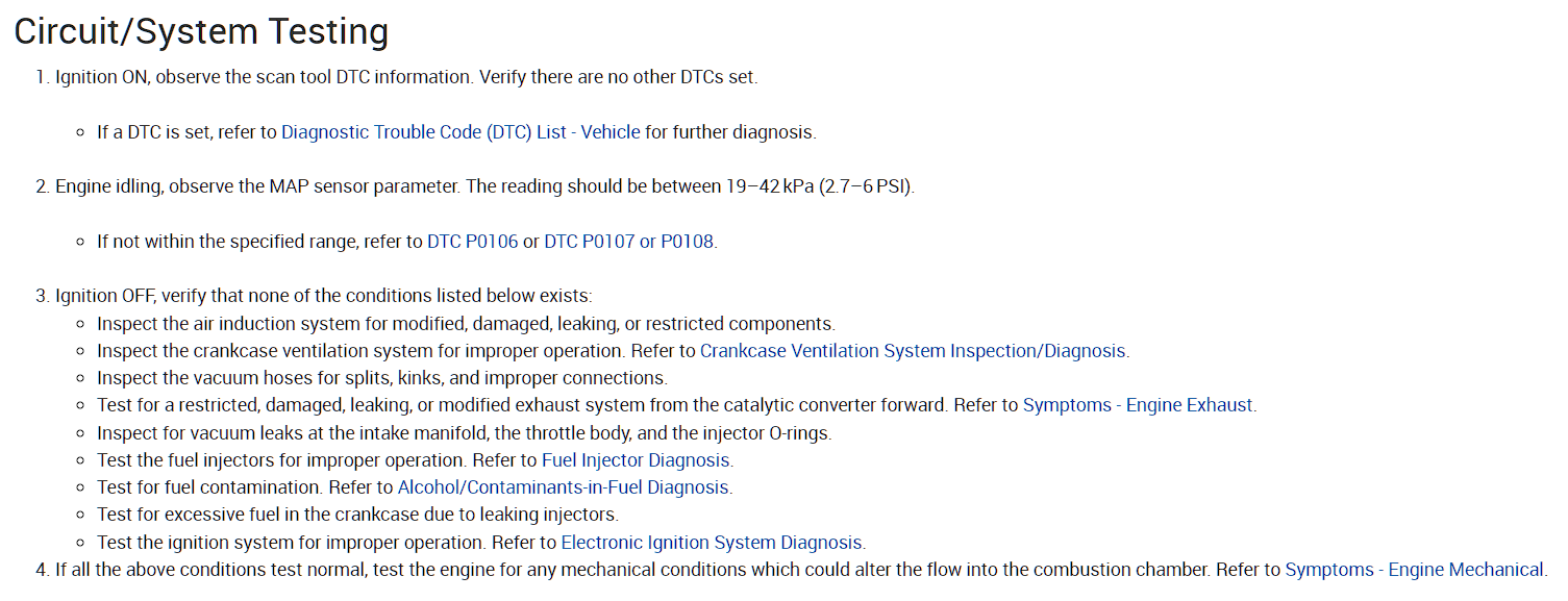

If you can see live data, is your MAP reading at idle between 19-42 kPa?
The shop manual for the previous generation engine says this about that code:
and
