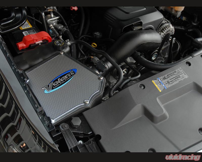

4. I have a volant Cai box with a Upgraded Filter.

Alright, now a few things have changed. I've decided against the CAI, because My dad says that since I live in a quite dusty area, it really wouldn't be worth it. And I think that I'm going to hold off on the exhaust for now. But, I'm having issues with LEDs.

Why not the cai? Get the Volant. Its enclosed but it still better then the Oe. Sounds better too

get a K&N Filter sock for your CAI, and you wont worrie about Dust at all.
If your concerned with looks, spend that 350$ on a big name CAI, if not hit autozone and get a specter for 150$ and put a filter sock on it.. http://store.knfilters.com/search/wrap.aspx
Performance will be the same between the big name and cheap CAI, unless your worried about 1 or 2 foot pounds and MAybe 2 HP.

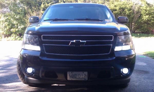

I purchased my LEDs last night, as well as some new halogens for my fog lights. I really didn't want to take a chance on melting a fog light, because, although it's unnecessary, I drive with my fog lights on almost all of the time. Which now that I think of it, if I'm running with my fogs on, doesn't that disable my DRLs? Anyway... I ended up buying "Putco Nitro Blue H16/9006 Type Pure Halogen Premium Lighting Replacement Bulb - Sold in Pair". If they work, awesome, if they don't... Well, they were only $21.73 on Amazon, so, I'll still be angry, but I won't freak.

during the day the drls are on. Even if you run the fogs the drls still are on. Heres the proof

how do you like those bulbs you put in the fogs?
I really like them. They're really bright, and they put out quite a bit of light, IMO. Although, on my other thread (regarding the fogs) I was told by someone with a Z71, that his melted even though he ran the HP halogens that I have. So far I don't think that I've had that problem.
Update:
Scratch that, I've since discovered that indeed, one of my fog light housings, is melted... If you're going to switch out the bulbs in your fogs, I would go with LEDs.
