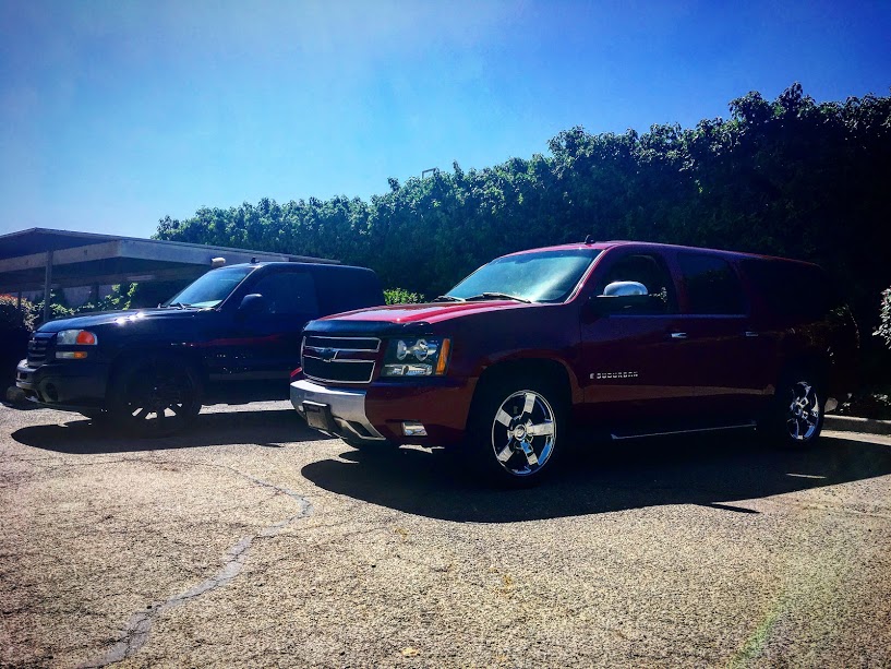

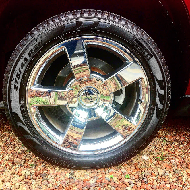

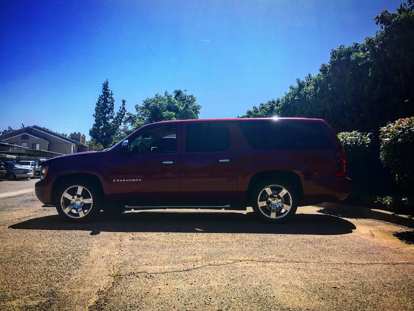

This was my Suburban on a McGaughys 2/3" Drop using spindles front and springs rear on 275/45Zr20 Pirelli Scorpion Verde on True Silverado SS 20's.

Agreed with kbuskill, your best bet would be running lowering spindles to keep your front end geometrically correct.
As for Ball-joints, I went with Duralast UCA's and Lower Ball-joints. I used a ball-joint press for the lowers and the UCA's had the ball-joints already installed. Very simple to do and of course required a alignment after.
View attachment 189991 View attachment 189992 View attachment 189993
