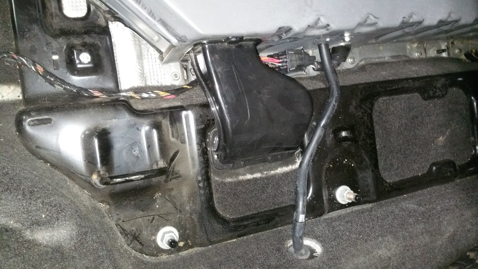

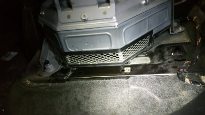

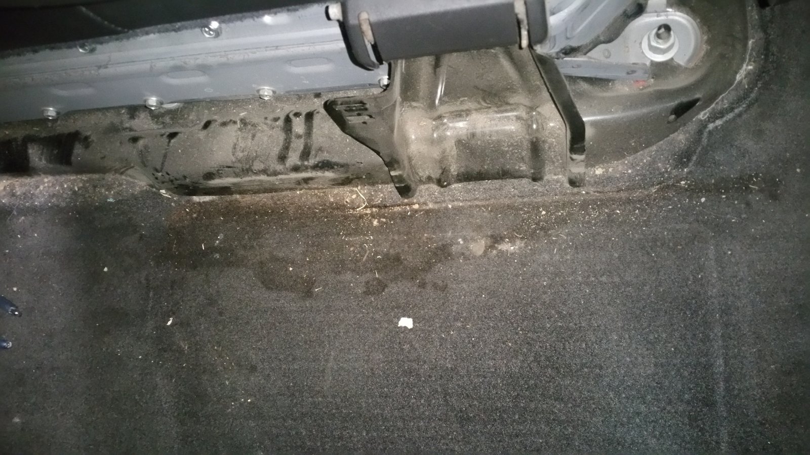

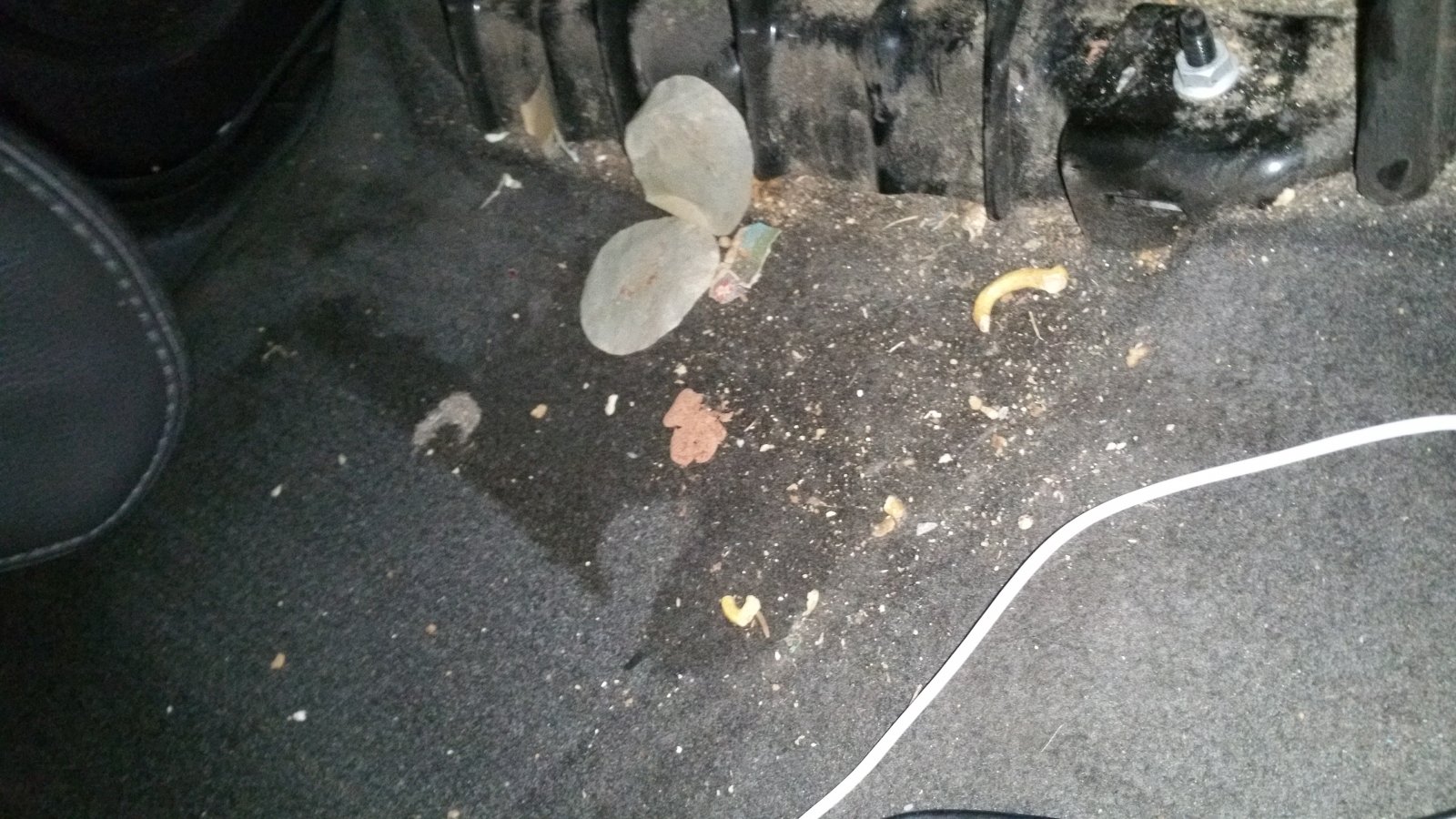

Also service the Hybrid battery this is DIY repair super EASY (i'm trying to get some good karma here)
with 185k miles i'm sure it's well caked on" and never been serviced
Step 1 Remove any item from the rear cigarette lighter.(This is the most important step as not to damage the cig port) :)
Step 2 get damp cloth (NO dripping water )
OR vacuum
Step 3 Fold the seats all the way
Step 4 pop off the plastic cover for the battery
Step 5 open rear driver side passenger door
Step 6 remove dirt from intake of hybrid battery
Step 7 put cover back on Honestly, I removed mine for now (the summer to keep MAX air flow )
these are optional to verify the status of the of the fan(make sure it has no restriction)
put you hand near the grill you should be able to feel good suction..(the engine will need to be started)
if the "fan is loud" there is an issue with the exhaust cover gasket it should be almost 100% silent (the exhaust side makes the noise)
Don't touch the tiny hose
I'm going to home depo or lowes i'll see if i can find a cheap DIY fix for it
Mine just got plugged something in exhaust vent today(was able to flush it out) using the high speed exhaust setting on the unit
not sure how it got in there (maybe from the vent from under the SUV??)
possibly a squirrel ?

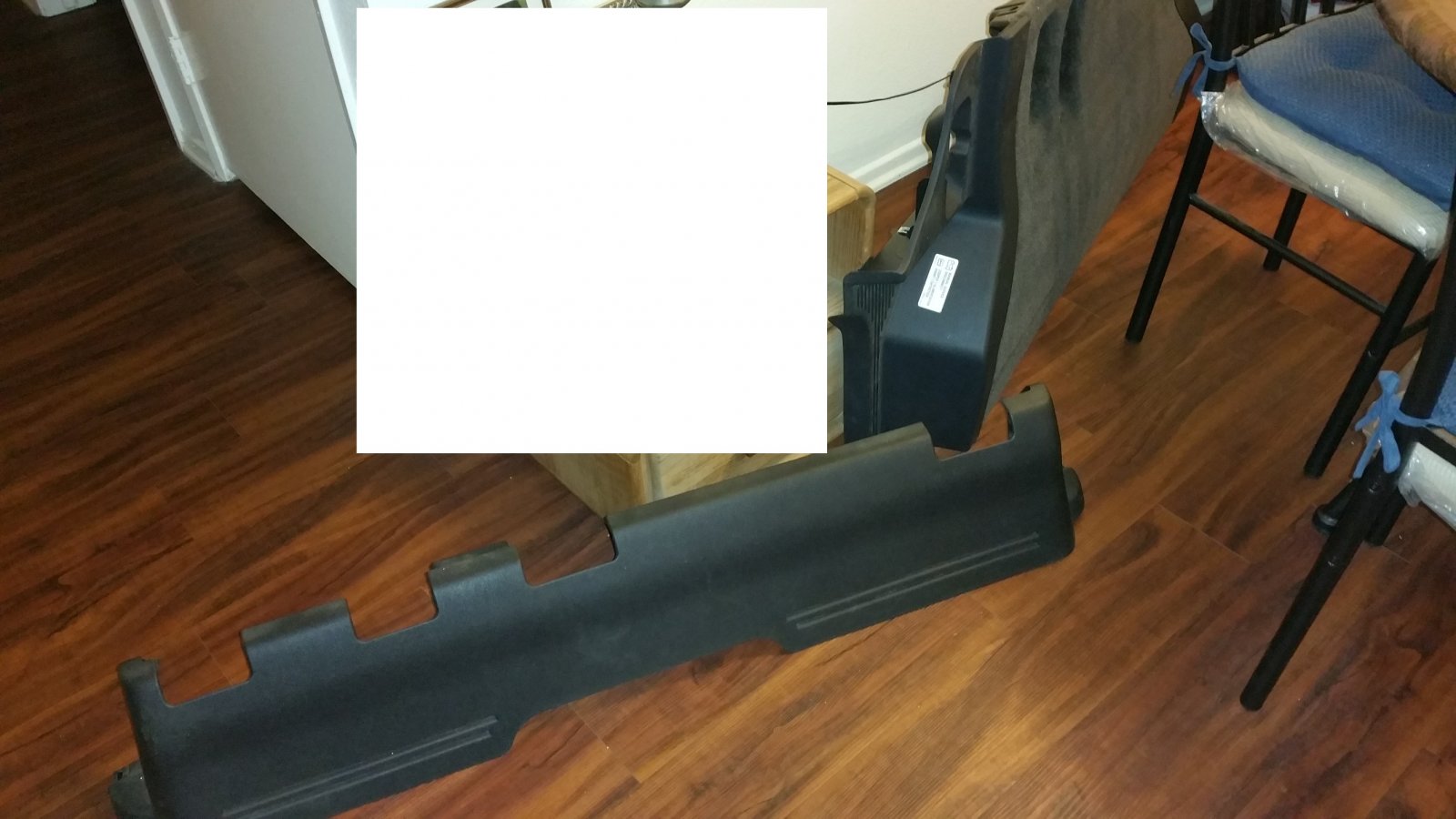

you can also go even further cleaning, the intake kick panel I removed mine (you will need a long flat head driver to remove the lower clips ) the seats will need to be in the up right position
you would not believe the amount of dust and garbage there.. also a free quarter..
nasty

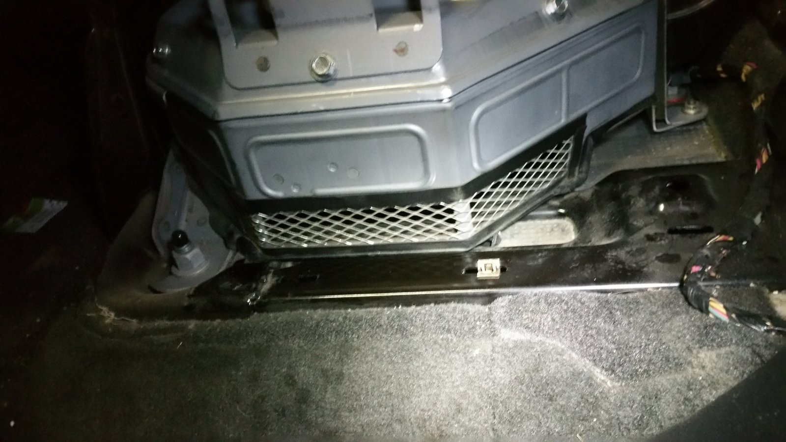

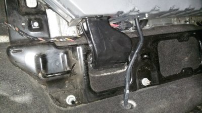

trash behind the kick panel in the rear
i all ready cleaned it up good I cleaned the carpet with some foam spray i found at the 99 cent store I ended up going back and buying more bottles (sometimes they have good stuff and never get anymore in stock, so i always go back and get more just in case it happens)
took 2 cans to get it clean but worth it
Can't beat that a clean carpet for $2.20 :eek: :)
that is 99% off taking to a detailing shop they would charge at lest $200-300
