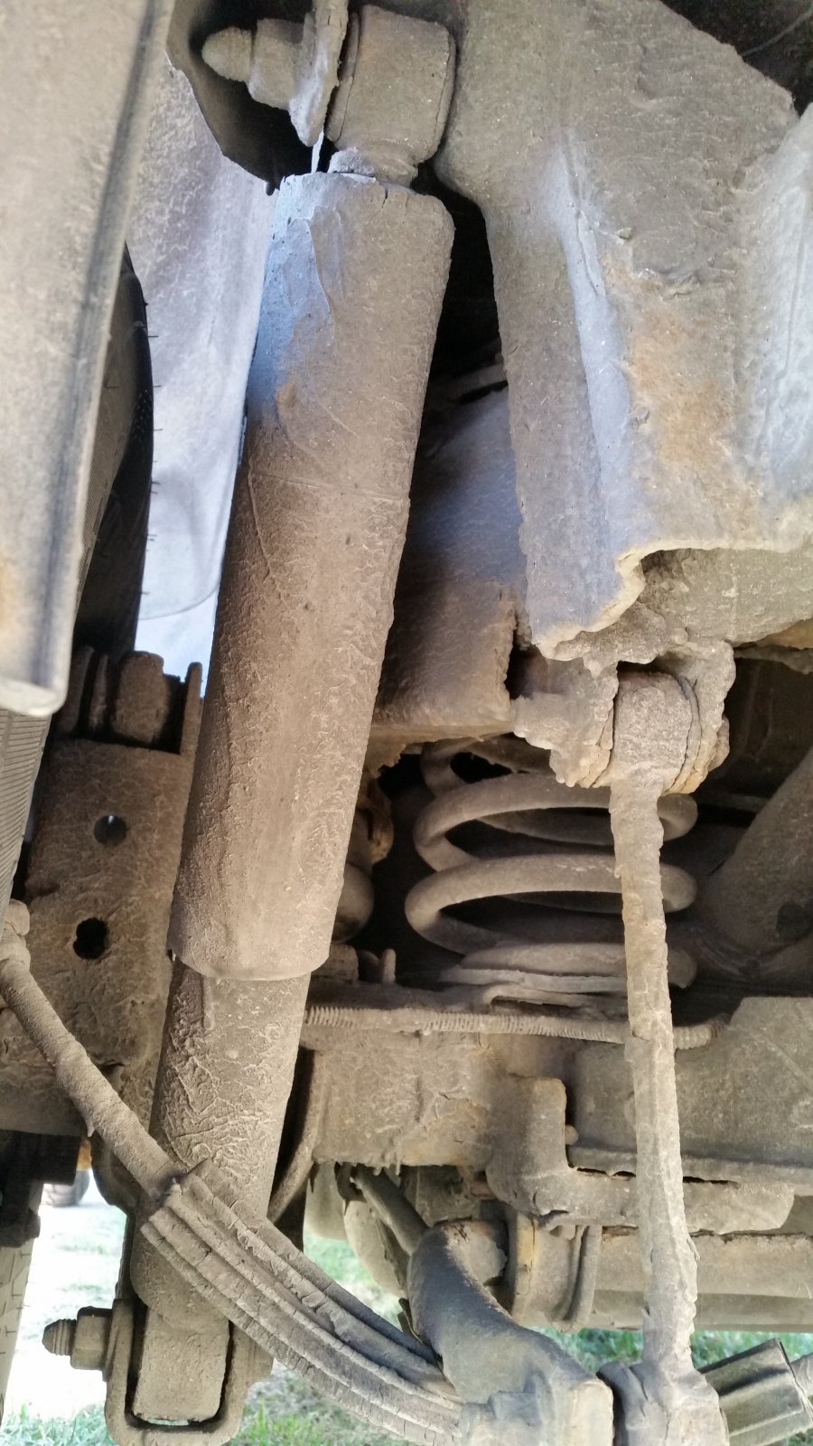

As mentioned here from the forum gods I do have the rpo code's ZW7 and G65.
Now my shocks are covered in undercoating so can't see what I have but doesn't this shocks looks like regular ones?
As my car are very stiff I have my bad feeling that someone down the lane have change out my suspension against something non stock.
Or what does the forum say? :)

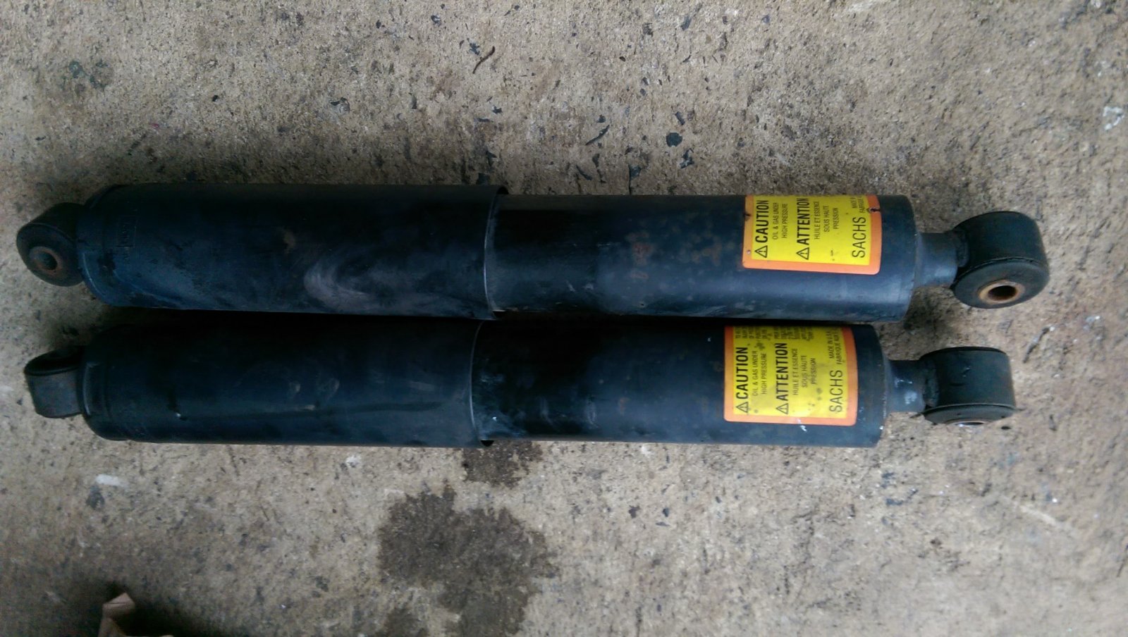

Here are my old ZW7 shocks.

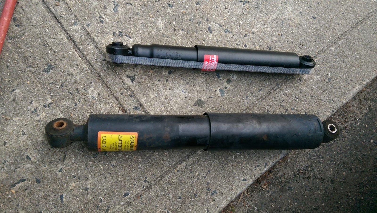

New to regular rear shocks.
You can really see the size difference. Much bigger.

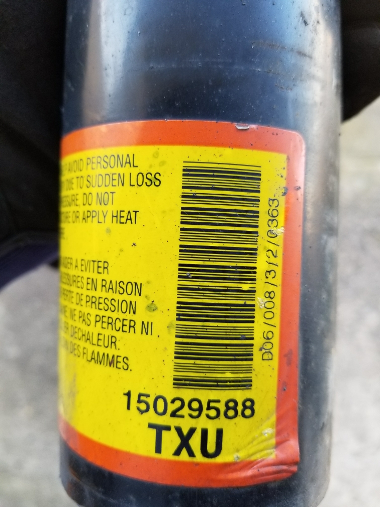

Here's the tag with part number from the original shock. Came from the rear of my 03 Tahoe. They're very expensive when bought new.
Or what does the forum say? :)View attachment 245311
Your shocks do not appear to be the G65 (Nivomat, manual self-adjusting) shocks. Nivomats would have a much larger diameter. I suspect they've been changed, although typically changing them out to regular shocks would require a stiffer rear spring (like the Z71 springs); otherwise the suspension is squirrely. Perhaps the springs that may have been installed are too stiff?
