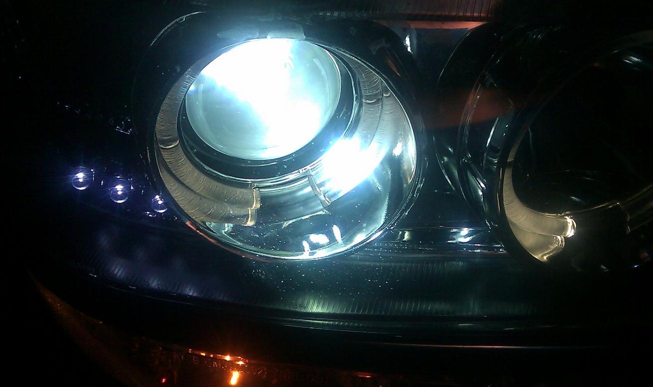

Here's a pic of my 10000k. They don't look too blue on the road. They don't even seem as blue as they are in the picture. I think the 12000k's would have a little purple tint to them. The projector lights have a slight smoke tint to them which is why they take a little of the color out. At least I think thats the reason. When I had 8000k halogens in the lows and highs, there was a difference in the color of the two.
