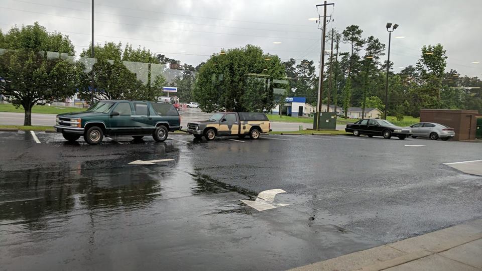

The next day I got a message on facebook from a guy out on the coast. He had a 96 C2500. Another 350 truck. From what he said it was a good gamble to drive 200 miles to look at it. So I did.
I drove my wife's S-10 out. And then...
It smelled like a dead elephants butt so I stopped right away and got a bottle of Febreeze.
He said the AC compressor needed to be replaced. I decided to gamble again and bought a big can of Freon with a hose on it. the compressor works fine. I drove home with AC.
So I may have a problem with GMT-400 trucks...
Keep in mind there are 4 not in that picture for a total of 9!

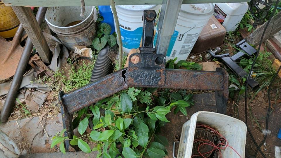

I did some work on the C2500.
The receiver was rusted in place on the hitch. I can only assume the truck was used to put a boat in the ocean since I bought it from the coast. There is no other rust on the truck.
The hitch wouldn't come out so we chained it to a tree. A couple of tugs and this happened.
Fortunately I have a spare hitch.

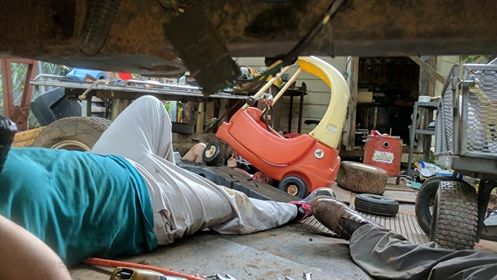

While we worked on that Heath worked on his car.
Neither front window worked right and the passengers side interior door handle didn't work at all. I kept having to run around the truck to let people out. That got old.

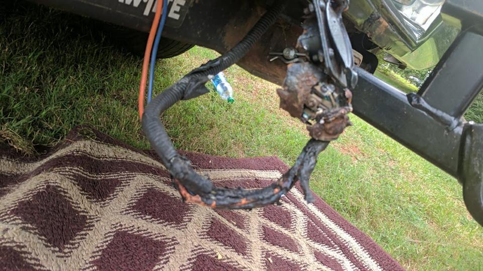

Found more exciting stuff on the Burb.
We had to go get a load of sand in the dump trailer on Monday . So I took a look at the wiring. I found this mess.
It had been on fire at one point. Lucky me.
So I sliced all the wiring out and fortunately had a new 7 pin connector in the shop.
We headed down to get the sand. I drove the tractor, the wive drove the Burb. The trailer brakes worked perfect - till we got to the guys house with the sand.
After I loaded 8000 pounds of sand on the trailer and we headed to deliver it the trailer brakes failed. Nothing scarier than being on a 2600 pound tractor and stopping and hearing the probably 12000 pound truck sliding up at me with the brakes locked and my wife looking like her set was electrically charged. FYI - A Ford 1720 does not accelerate all that fast from a dead stop.
Today I went out and finally had time to look at it. Turns out the brake controller was fried. So $110 later it works now. No I don't cheap out on brake controllers. They are life savers.

I want to see a picture of all 9 GM trucks. That is a collection for sure. lol
50,933
19,329
...and a couple of them he works rather hard :waytogo: over the years I've been pretty impressed with what he can make a gmt400 do with the loads if can tote :)

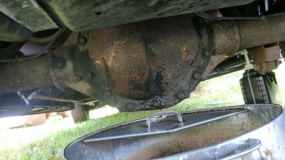

Soooo the C2500, now named TheKracken, had a bad case of diarrhea today.
She got her name because a PO lived in Florida and used her to put boats in the ocean. She has the rust to prove it.
Yesterday the rear end started singing. Today I pumped in 3/4 gallon of gear oil and was treated to this.
No problem, says I, I have one hanging on the kitchen wall as a decoration.

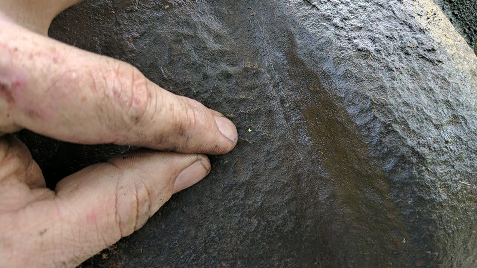

So I pulled the leaker off, and found a hole.
Tiny, but enough to leak.

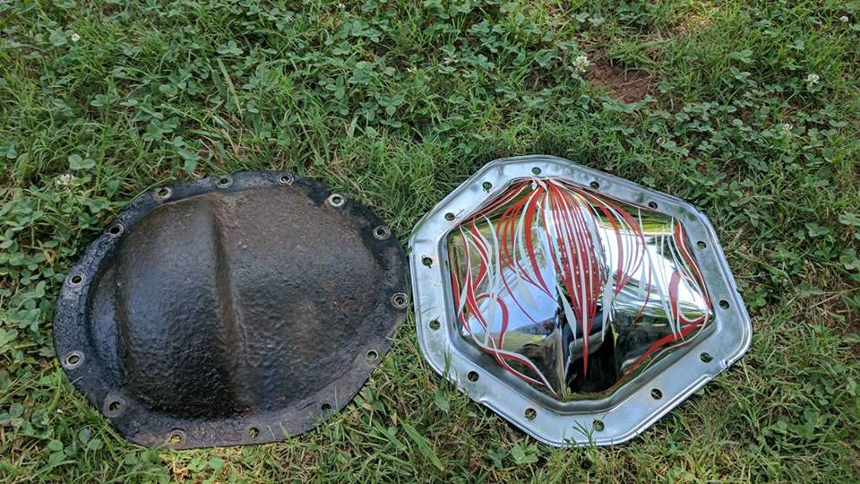

Then I grabbed the other cover, See a problem?
I called around and no one had one. I ordered one from NAPA. It will be here tomorrow.

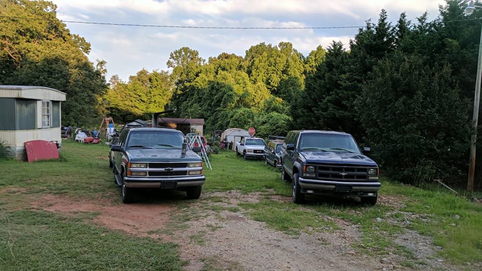

I have
1 An 88 K1500 diesel Burb (oldSmoley) with a Banks turbo. Needs work.
2 An 88 C1500 short bed (Spooky) waiting on me to finish the engine swap and get it running.
3 An 89 C1500 longbed with nothing but a good body. Soon to be mated to the below.
4 A 90 C1500 longbed with a bizillion miles. (LittleSister)Body beat to hell. Still runs like a top.
5 A 90 C1500 stepside. odometer stopped at 212k gettign in need of a clutch.
6 A 94 K1500 long bed excab. Blown headgaskets riusted cab corners.
7 A 95 c1500 Burb blown head gasket, relagated to parts status.
8 A 95 C1500 TheJollyGreenGiant) Currently in the trans shop.
9 A 96 C2500 (TheKracken) currently waiting on a rear diff cover.
10 A 99 K2500 needs head gasket.
Hummm I have one more Full size than I counted.
I also have an
89 S10 pickup with 780k miles
A 94 S10 Blazer currently at the trans shop
And if you really want to get technical I have a 99 Subaru Legacy that needs an oil pump seal.
Not to mention the other cars that drift in and out of here.
