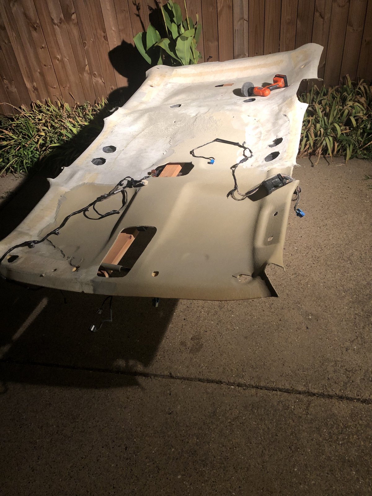

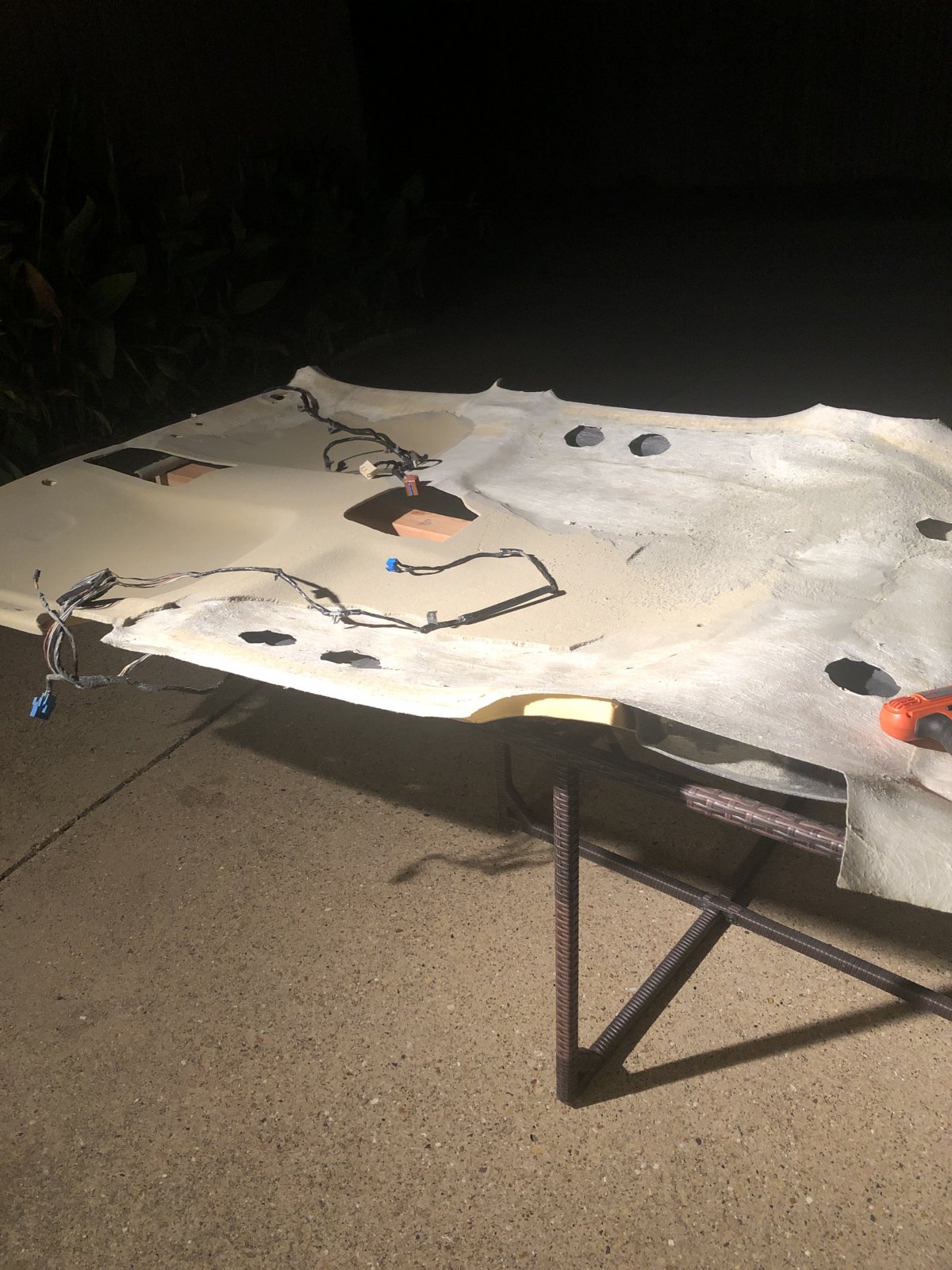

Headliner removal, headliner strip, and headliner reupholster, and headliner reinstall with interior trim and wiring reinstall. Holy sh*t this turned out to be a cluster. And I started well prepped and supplied. But those little 15 minute videos that pop on google are edited to flip through the BS and there’s a lot of bs. Will update later. I’m on about the 3rd night of stripping the old headliner from the frame or whatever you want to call it. Flimsy Fkn piece of paper with cardboard bulkheads. Ugh I don’t even know if it will go back together. I’m like 50/50 on the success of this thing.

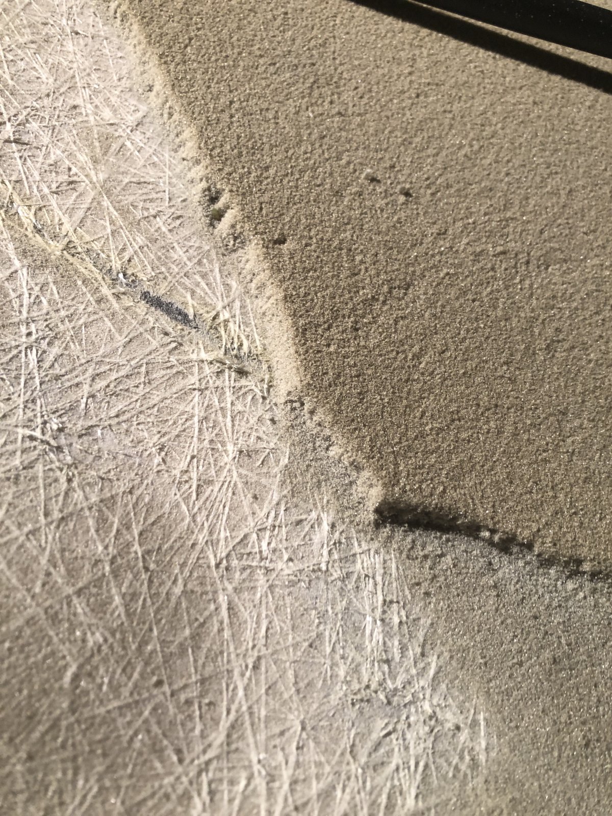

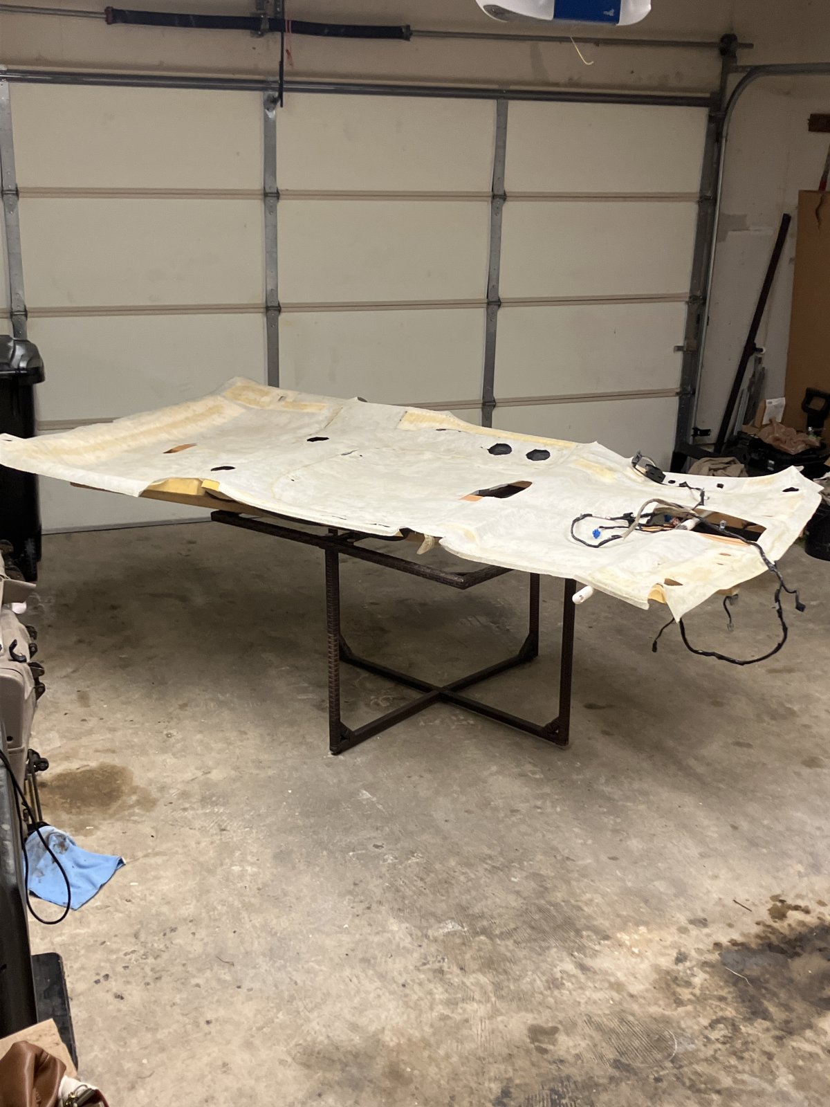

Just finished stripping off completely the old and started FRI night. Ive got at least 6 hours on the sanding. 2 hours removing trim and getting the headliner out. This thing its bare form lost all of its shape. I will see what i can do on the reupholster but im not confident at all. Oh and i cut through the paper in a bunch of spots so i really want to spend 1 night with a fiberglass kit and get it halfway patched back up because its flimsy as hell

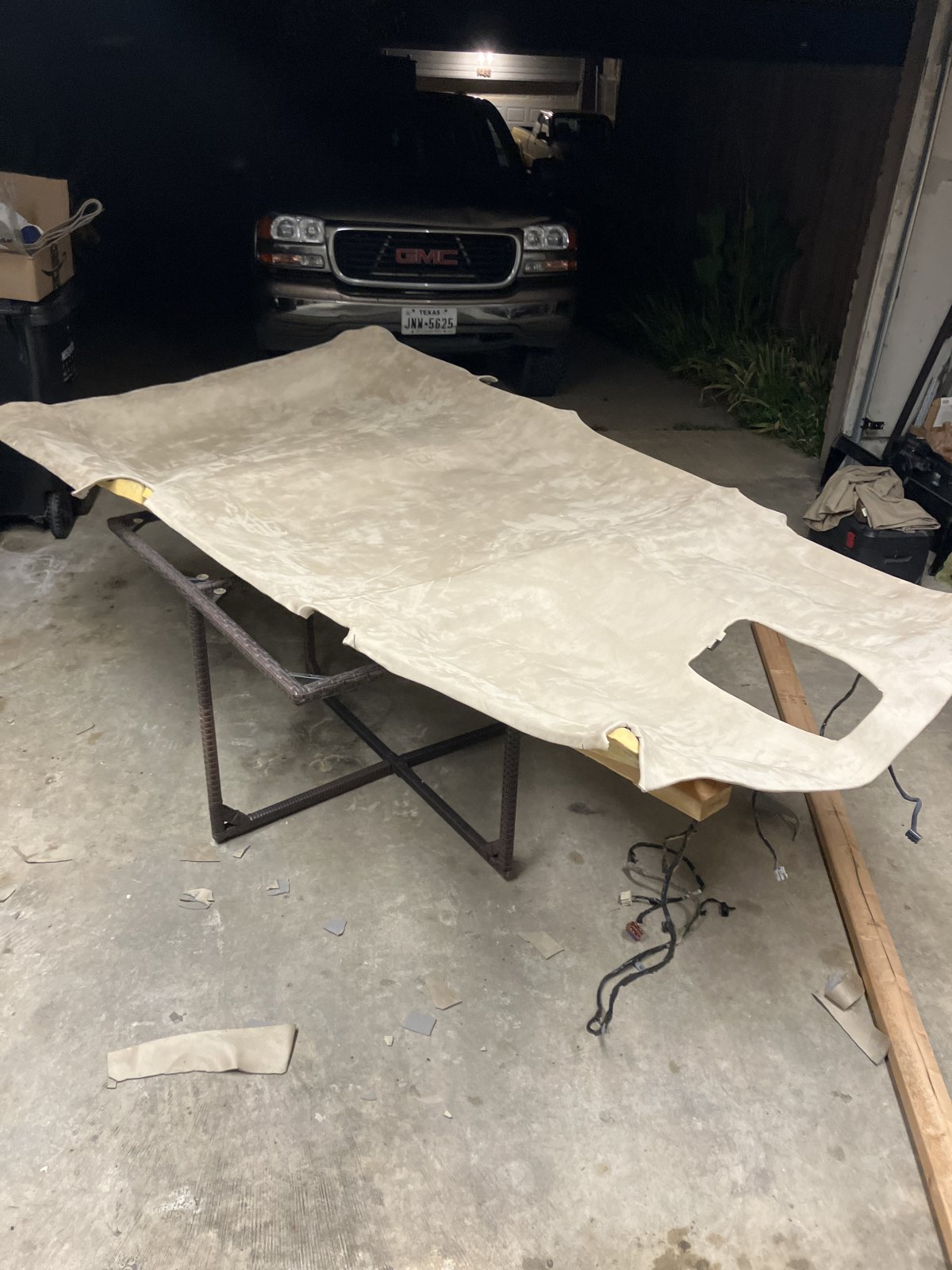

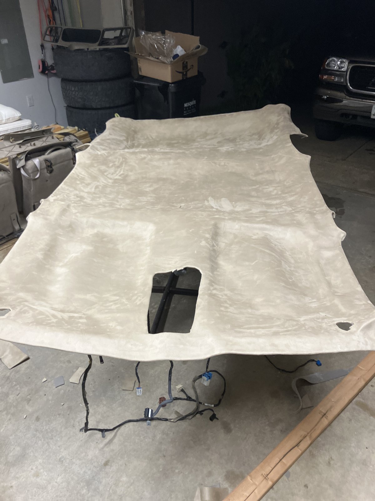

I started on gluing down the new headliner fabric last night. i got a late start, got into a rush worried about losing a bunch of sleep and made a couple mistakes. doh! ftw I just keep it moving. I did about half yesterday and will try to knock out the rest tonight. it depends if i can get started early enough. i forgot to take pictures so hopefully i can remember to click a few tonight and post for the record.

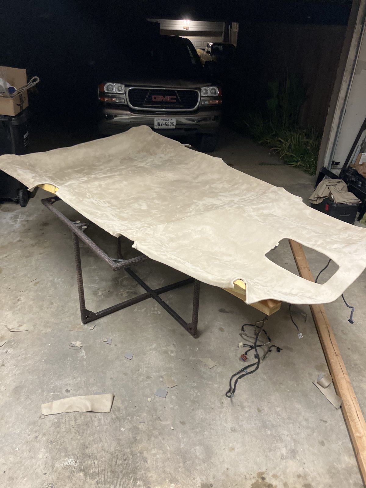

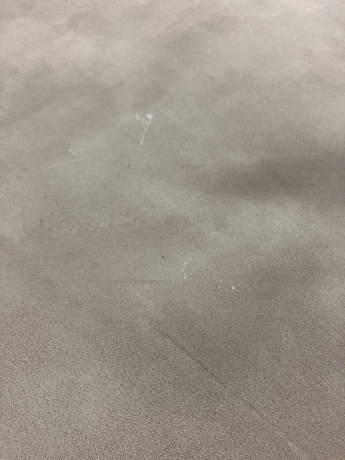

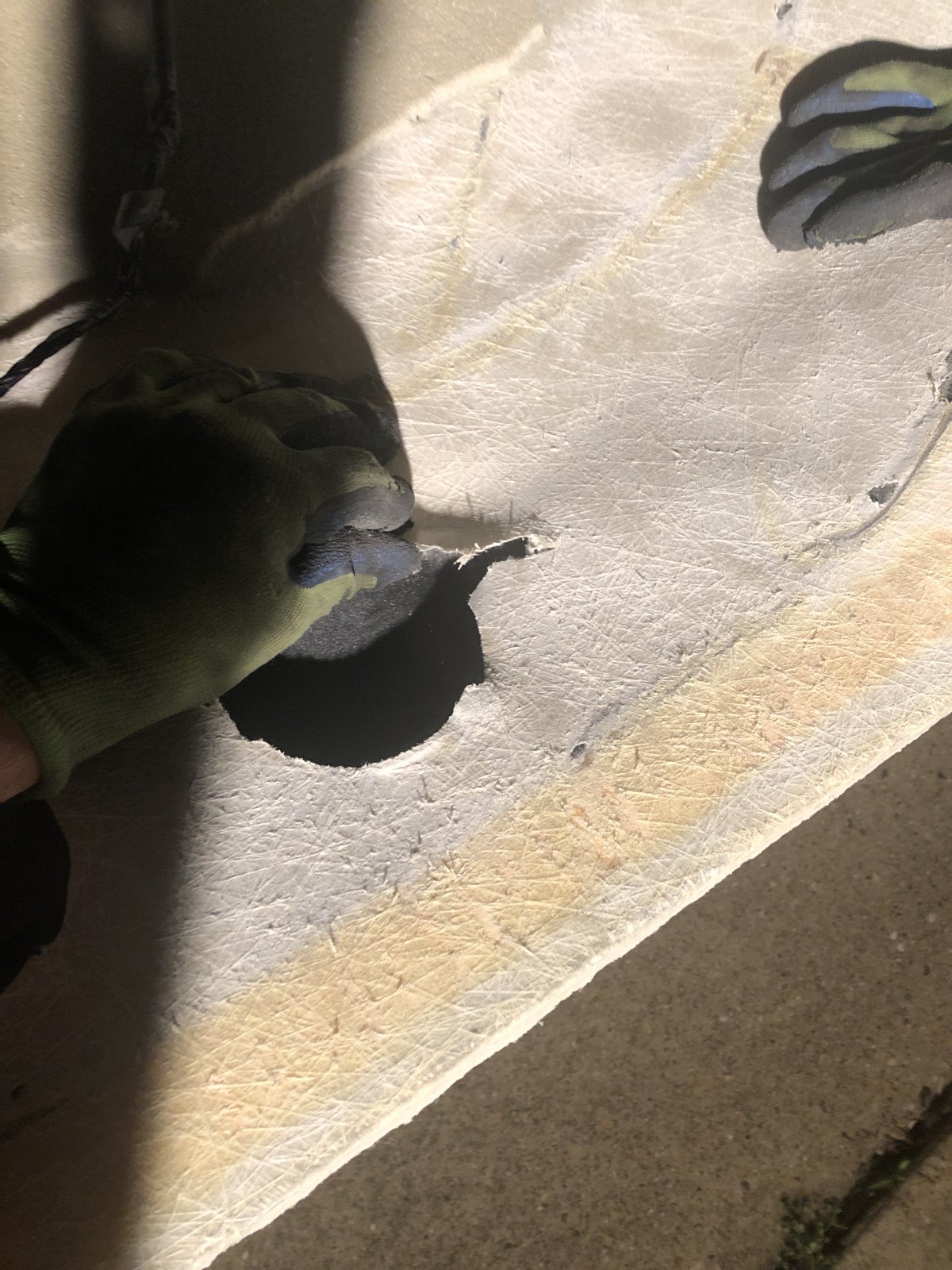

1:30a finished laying down the new headliner material. I got that glue everywhere and ruined my hard work. My dumba$$ was spraying underneath it to make some of my holes and the headliner glue goes streaming through a 1-inch hole for the visor latch mount. Doh!! I still have more holes to cut and hopefully get this dude reinstalled over the weekend. That’s going to be super fun

When you pull the headliner material off, all you need is a handheld steel wire brush to get the residue off. Don't use too much force or you'll go through the backing board. That's all you need to do. Too late, but for anyone else who might stumble on this thread.
