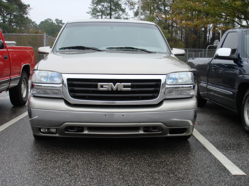

That would be cool if they are in fact a direct swap. However, I know the HD grills are subtly different. The corners are more squared off and they have less horizontal bars and the bars are thicker. See the picture below.

Great thanks, that's what everything I'm seeing now is saying too.
I'd also like to add that you need to get an HD Sierra grill without the bottom black trim piece. That's only for the HD bumpers.
Really you just have to get a 03-06 sierra grill. Same as the HD without the black trim at the bottom

So the Sierra 1500 grille is a direct swap?
Yea you just have a slightly different shape at the bottom of the grill where it meets the bumper like the picture above.
99-02 sierra and 00-06 yukons are the same grill.
03-06 Sierra have the grill pictured above.
