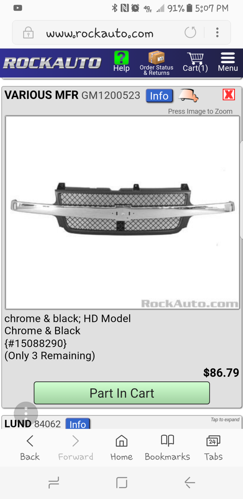

Getting close I can smell it I received my grill today brand new only costed 134 with shipping and handling!!!
What do you guys think black HD bumper cap or color matched HD CAP!??

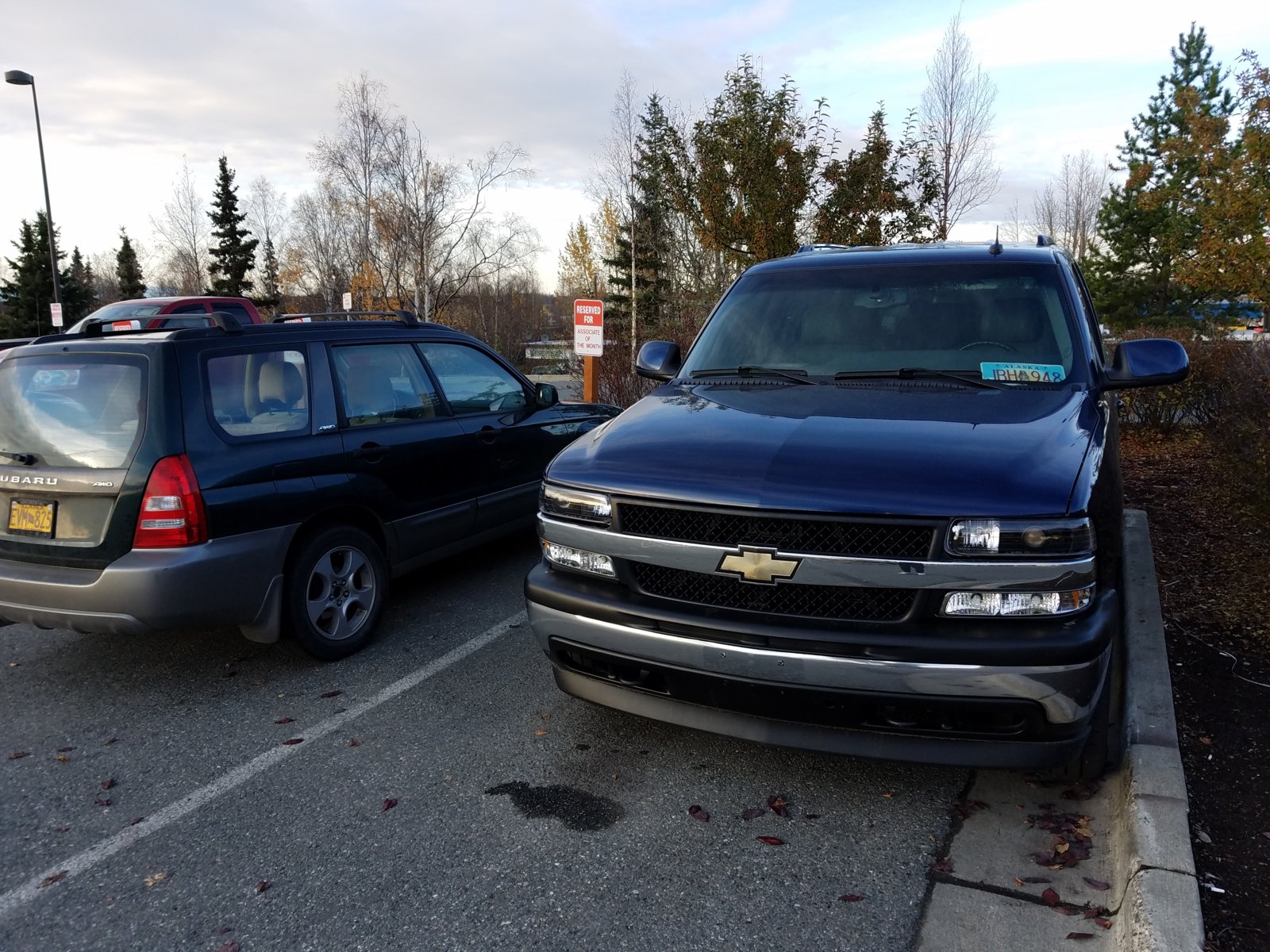

Hello everyone I am new to this form. I have a 2001 tahoe with an offroad front bumper if I want the hd grill do I have to do anything or is that just for stock bumpers.

Off road bumper doesn't matter, same as a regular tahoe bumper. You would need to reweld the frame horns 1.5" lower to fit the grille and bumper cap. Otherwise you can just trim a "1 Off the grille to fit the stock bumper like what I did and also what @Tonyrodz did
