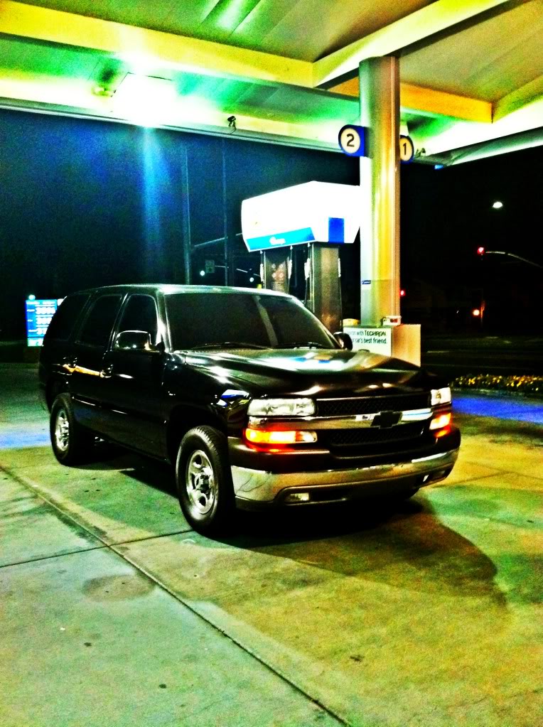

all together it was 200-ish for the upper bumper pad new from chevy, 40 for the grille and 80 for the HD hood. 50$ for install. its amazing what you can find at junk yards if your patient and piece everything together.
the grille will not fit properly if you just throw it on, the HD grille dips down into the bumper if you use the bumper pad from the tahoe. you need the HD pad AND the bumper dropped down. you do not need the whole bumper, just the black plastic piece on top of the metal bumper (pad)

IT WORKED!!! sorry guys im kind of a newbie! the two bottom pics are the most recent
[/IMG]
So fresh! I'm gonna keep my black z71 valance on the hd setup gonna be beast maing!!

Thanks for the love guys. I'm really happy with the way it came out, it's subtle enough for the untrained eye to not catch it, yet one of us will catch or real quick. the only thing that sucks is my hood was so cheap because it came painted but there was no gloss, so it's just straight paint. It's 200 to match the hood but I'm thinking I might just repaint the whole truck.
