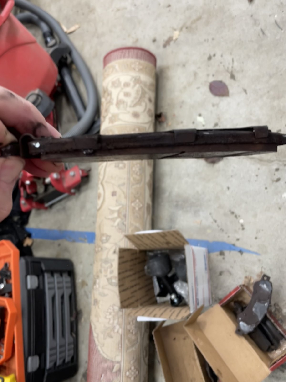

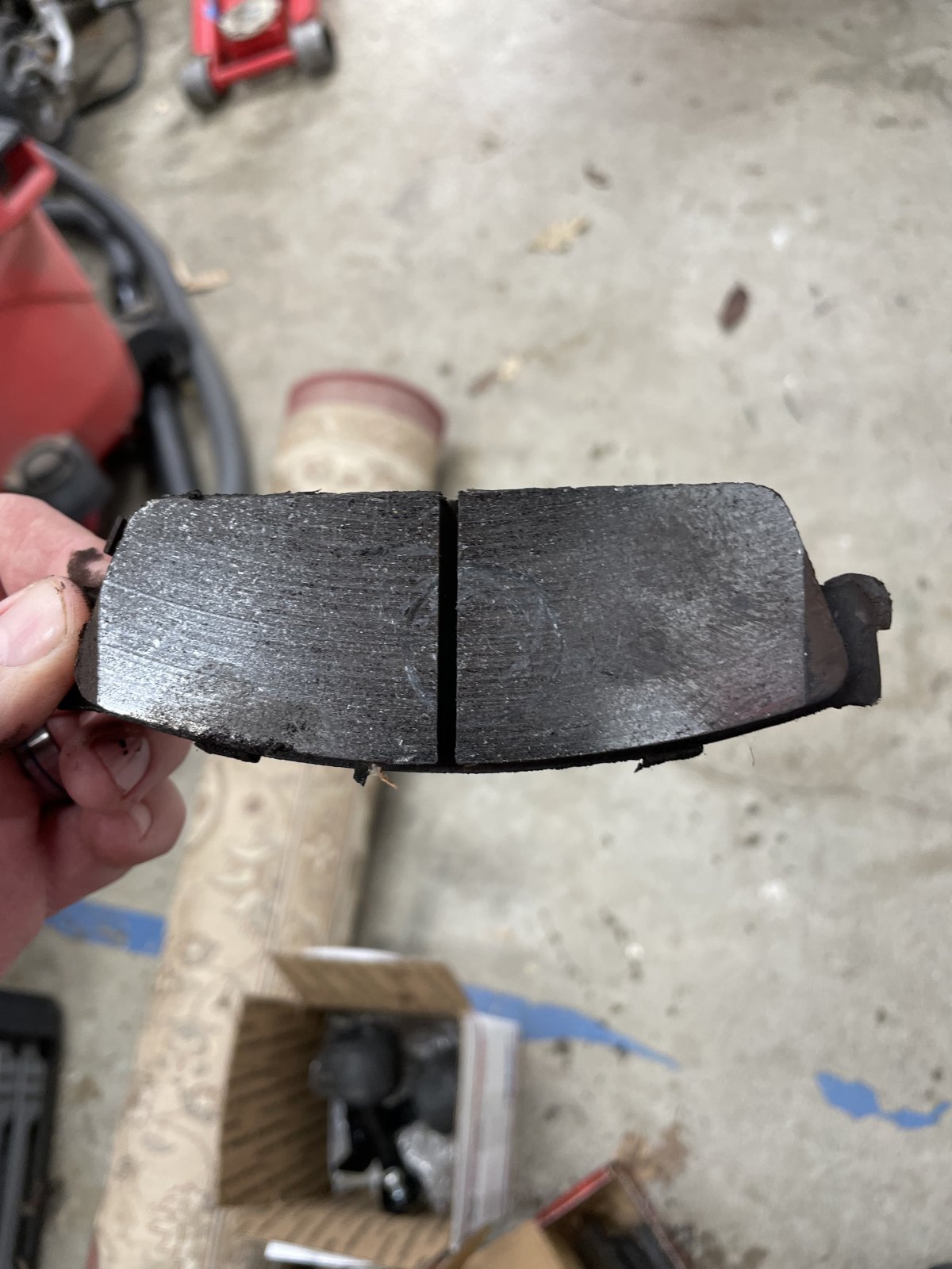

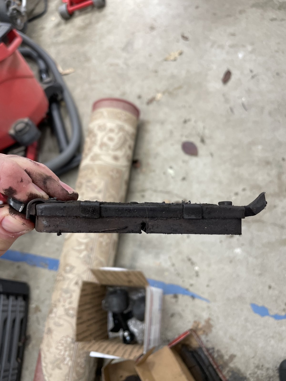

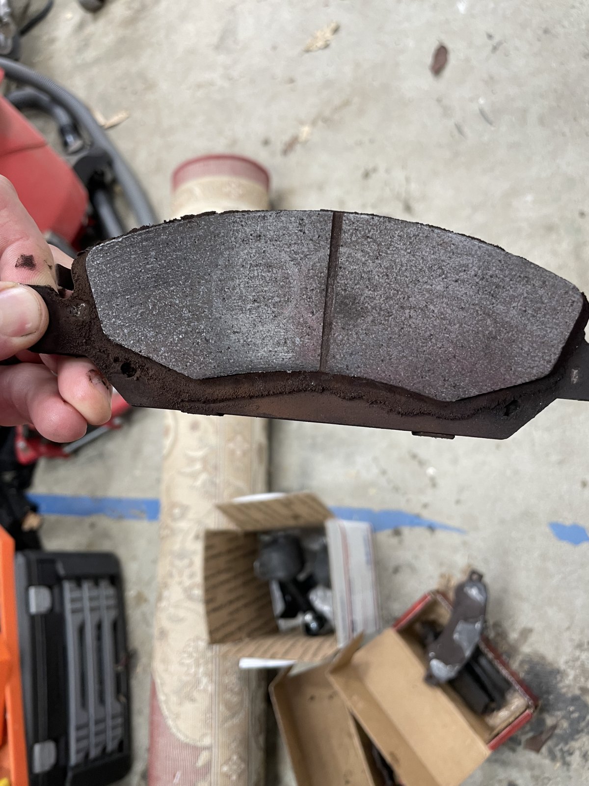

I got the pads in finally and a day to swap them and flush the brake fluid.
Calipers, springs, pistons, slider pins… etc are all in good shape.
Those LTS pads must have been faulty.
The fronts had about 2mm pad material left, rears had about 9mm which was about right for the mileage.
New pads in and they feel soooo much better.
So nice pedal feel. These HPS 5.0’s don’t have the cold pad feel that the HPS have. So all the positives but not the negatives so far.
I’ll give another update in a month.
But to reiterate, I think I had a bad set of LtS pads.
Pics of the lts pads when removed:
