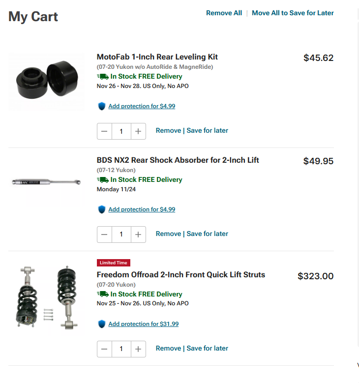

Been throwing around the idea of lifting the Yukon but Bilstein's are way outta budget and I stumbled upon these. Obviously, the ride quality will not be Bilsteins quality but is it comparable to stock Non Air Ride

Two Bilstein front struts are less than those loaded struts. You'd have to don your EOD suit, and swap the springs and bearings yourself, but it's not really a hard job. I rented two sets of spring compressors, and used three of the four pieces on each coil to provide a bit more safety.
You'd have enough $$$ leftover from the difference to put toward new bearings too. (I reused mine the first time around - no point wasting money.
