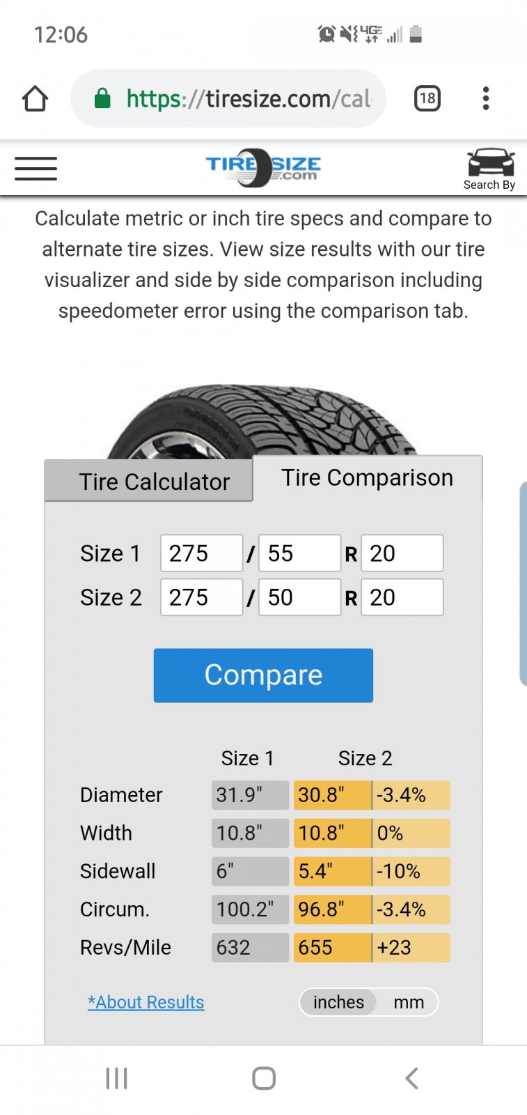

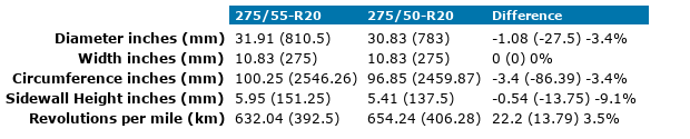

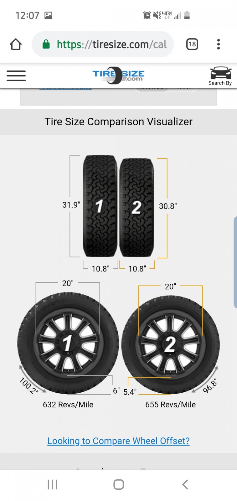

275 55 20 is stock size on my esky.
It's a 1" shorter tire so it would drop the truck 1/2"
Barely noticable imho

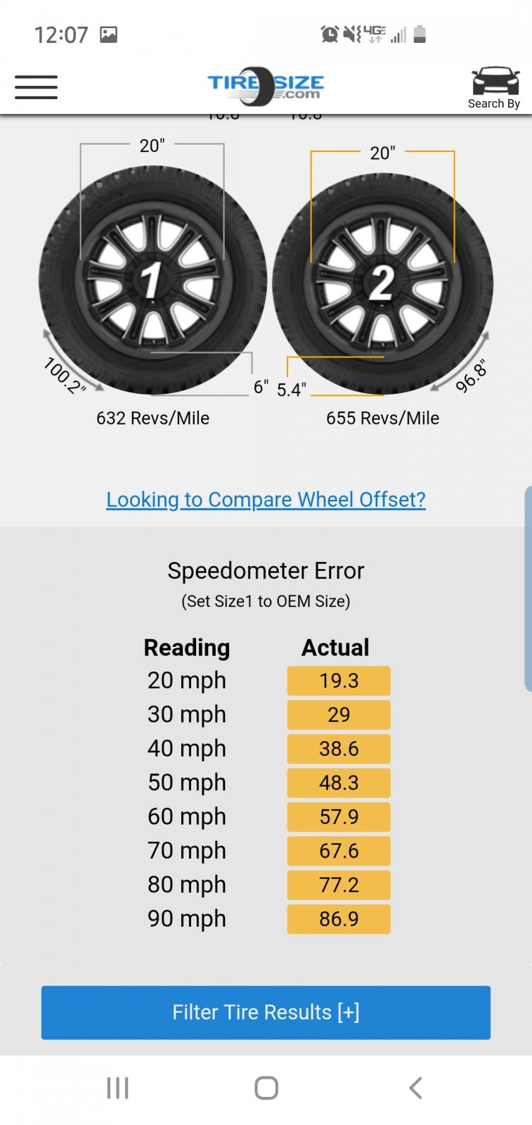

Your speedo will be off a bit also, unless you have a tuning device that allows you to adjust tire size

Yep. Not very much though. I wouldnt worry about it personally.

It will also cause your odometer to be off
