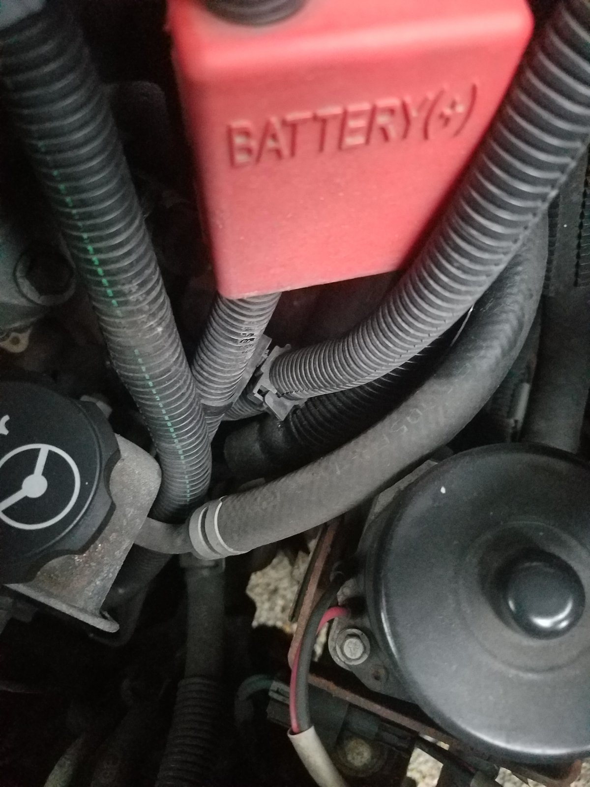

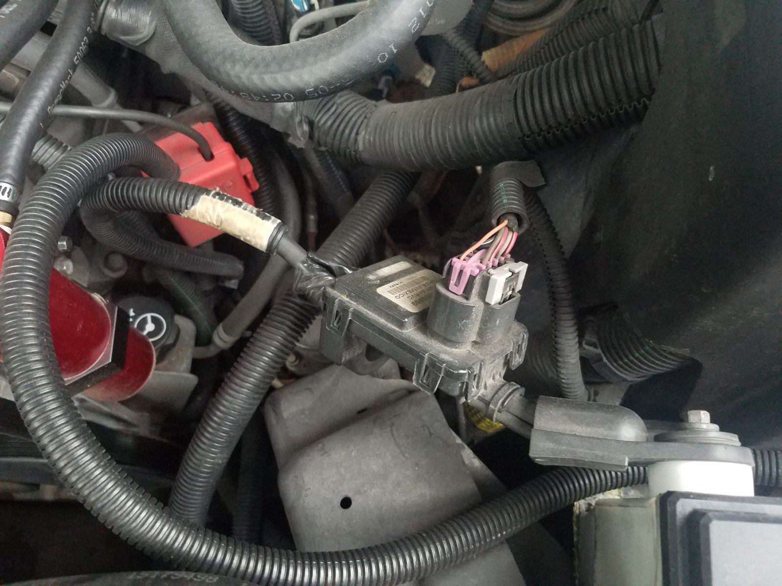

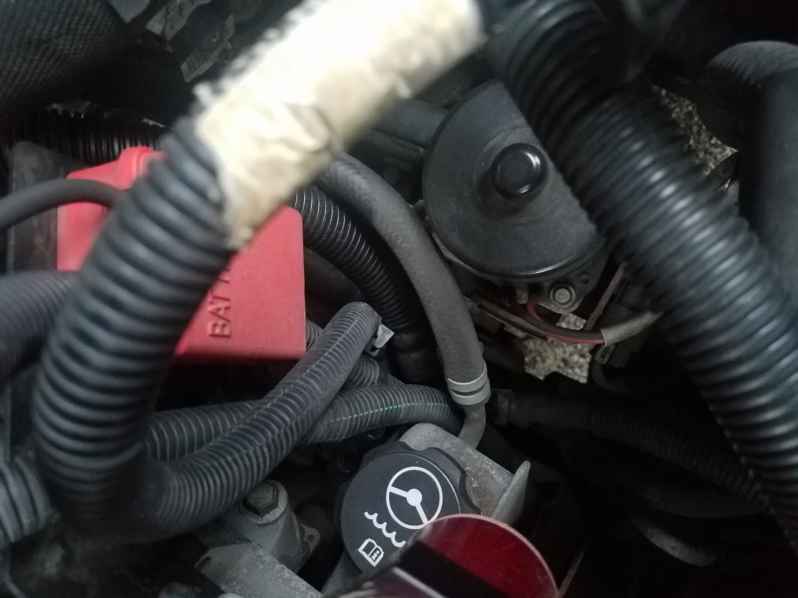

Finally threw in the towel and had a mobile mechanic come out. He replaced the power steering pump with a brand new AC Delco unit, and all is well. I'll never know if the original PS pump was bad, or if the steering pump was bad and the original PS pump was operating normally.
I have a request: I think the mechanic intertwined my negative battery cable with the power steering pressure and return lines - can someone snap a photo of how the negative battery cable is routed in the area of the power steering lines and post it in this thread?
