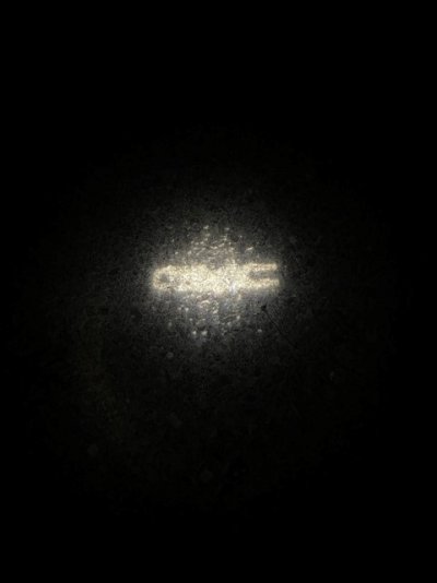

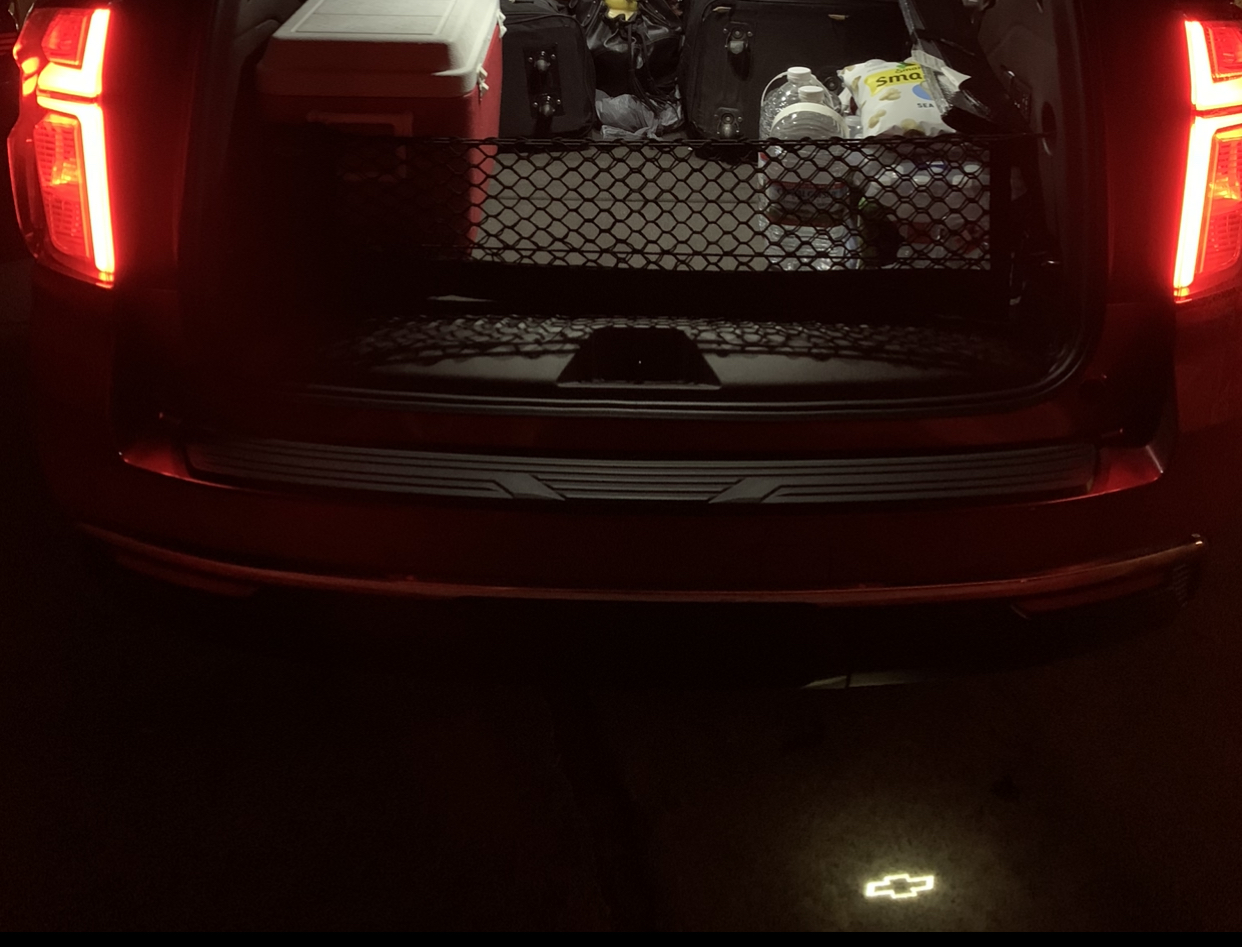

After a carwash I noticed the blurred logo. Tried to clear the lens with a cotton swab. Didn’t help much. Anyone else have this issue?
(Posted before and after pics)

I did and had it replaced under warranty. That was probably close to 10k miles ago and so far no leaks/condensation/distortion.

Mine did something similar, cleaning did nothing. Ended up ordering a new unit for $49 shipped from GMPartsStore under part# 13540010. Could I have warrantied it? Sure, but just as easy to order it myself and swap out on my own in 5 minutes.

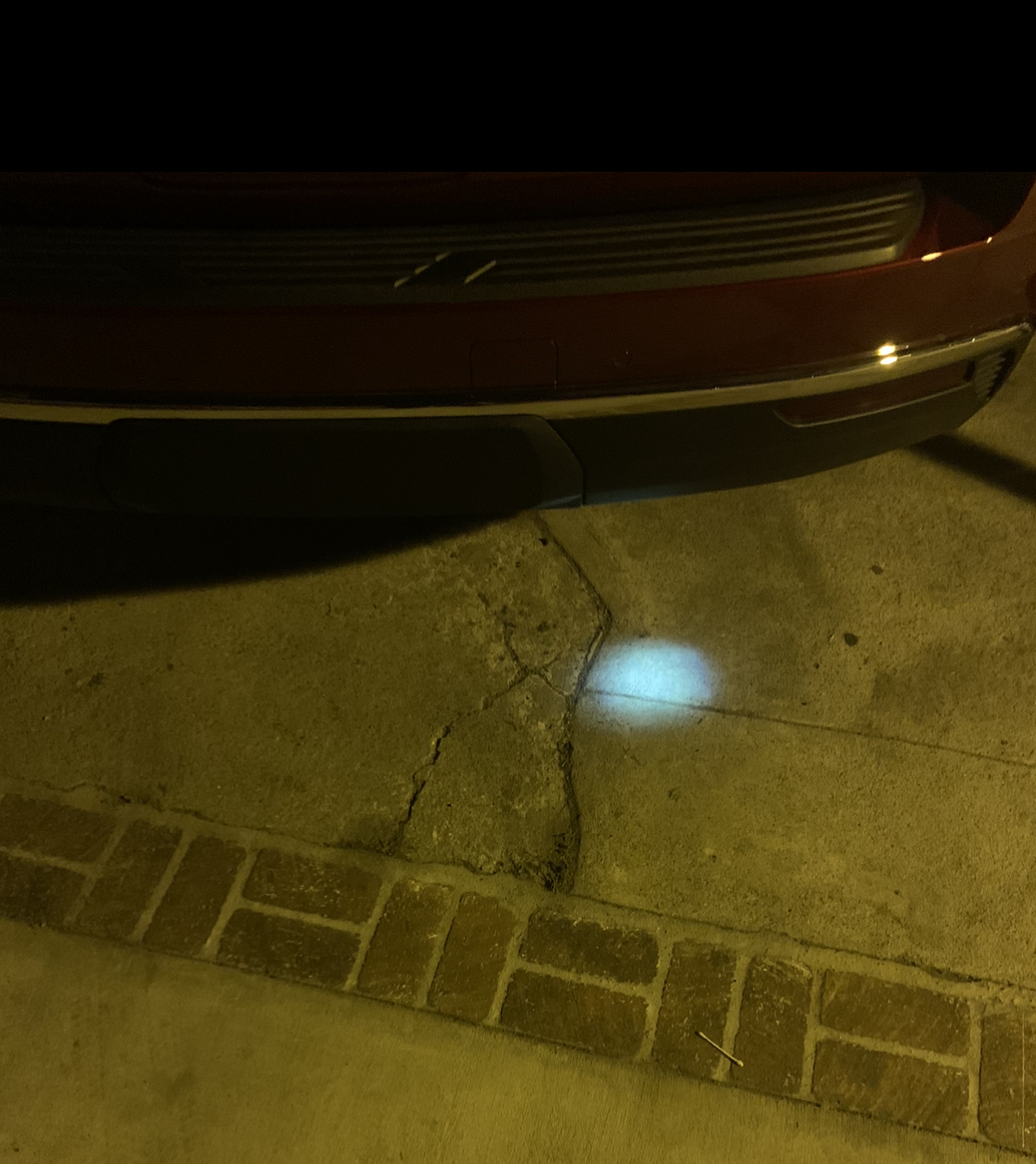

Same issue here. Dealership replaced it the first time at 7K, I have 14K on it now and it's done the same thing. I keep it garaged and clean. i'll keep taking it back, 50K warranty on it. It's a pain to take it in. i wish it was just a matter of cleaning. images of both.

Mine is doing same thing, going in in a week for it. Guessing will be a replace!
GM should put more care in stuff like this; that is their BRAND....nice touch on the car, but lame if it fades away. You make a good point though, I should photograph it, as it only comes on in the dark.

Took mine in to dealer yesterday, they replaced it, it is clear as day now...Mine definitely had internal water intrusion that a cleaning would not resolve.
