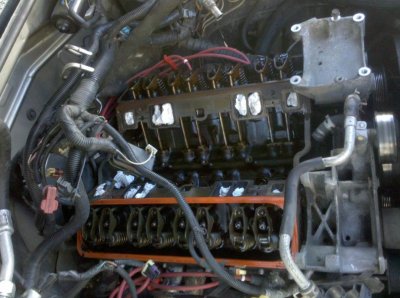

new intake manifold gaskets

took me about 7 hrs by myself . the job isn't hard just cleaning everything is the most time consuming . got a chance to clean out alot of carbon from the intake ,injectors,throttle body... engine feels stronger and smoother

$70 for the felpro kit from autozone $20 for a new t-stat $30 for antifreeze $30 oil change .the gasket kit came with lower intake gaskets upper intake gasket throttle body,injector and valve cover gaskets dizzy gasket too
