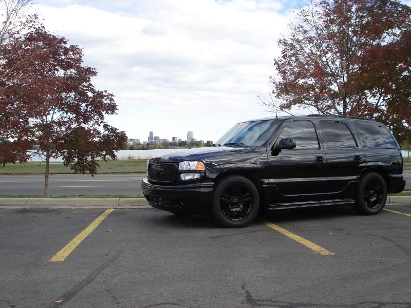

They make replicas of the nnbs esky 22s that are painted silver, I almost bought some when I had my 20s powdercoated. Still have no idea what wheels I want if I ever upgrade to a 22, love my light 20s and big ass tires tho.

I like the wheels I posted from ebay the best. In some pictures 22's look too small on the Denali and in others 24's look way too big. I kind of want to be in the middle so all my engine mods will actually make a difference.
Is there anyway you could send me a picture of your denali so I get an idea of what 22's will look like?

Oh wow that looks awesome!
I am definitely just going with 22's.

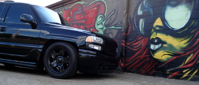

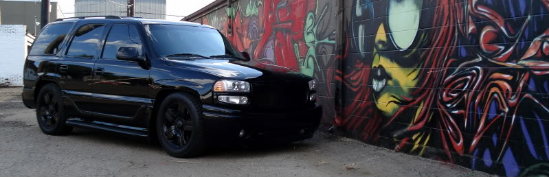

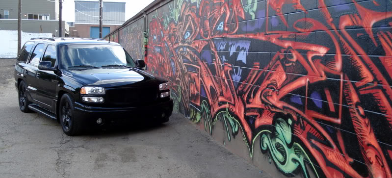

lol no it's 6" in front and a bit over 5" in the rear. Here is what a 3/4ish would look like

If I get 22's and go with the 2/3 then it would look like the 3/4 with 20's?
