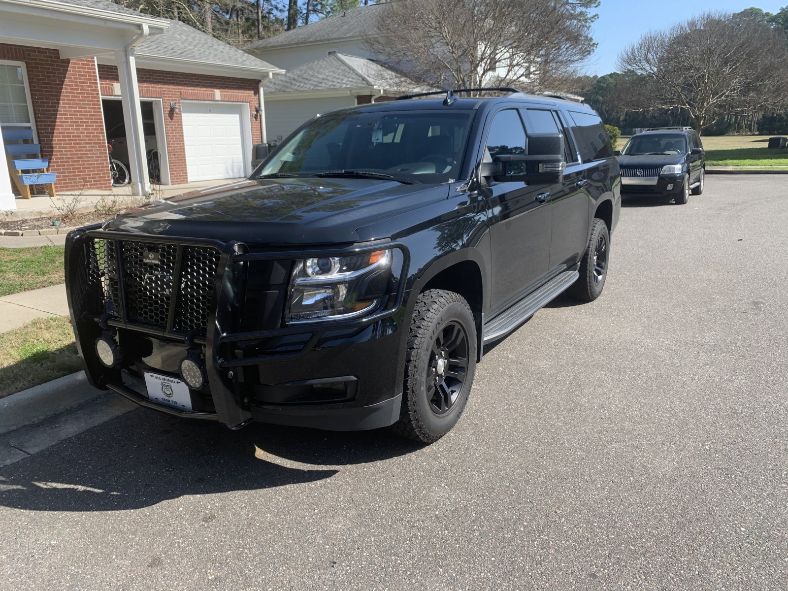

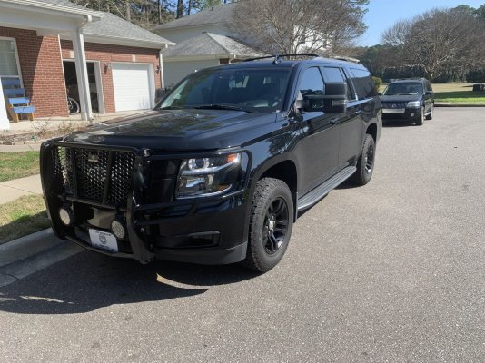

Had the brake recalls done sbout a month ago. 5.3, 4WD, 80k miles
Nobody has touched the car in 40k miles. I do all maintenance and it was noise free. I let the Dealership perform the recalls and now my front suspension is moaning over every single bump. <5 mph through 80 mph it groans. Noise started about 1 week after they had it
it’s definitely suspension. Does in 4wd or 2wd. Does NOT get worse or go away in 4wd. Does when I shake the car when off and parked. Had initially thought maybe was a CV or front differential
So far I have found my skid plate bolts all loose (some almost all way out) and the sway bar links were overtorqued enough to split the rubber ends. They were last touched by me 40k miles ago when I installed the 2” leveling kit
Cow killer is tight and not rubbing anything
I cannot find the issue and it’s driving me insane. Anybody have other ideas? I’m about to buy new control arms and just replace everything that moves in front end. Complete rebuild
Dealership of course swears they only hooked a scanner up and did a software update. Denies removing skid plate or torquing sway bar links.
